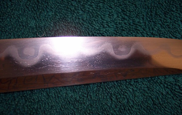

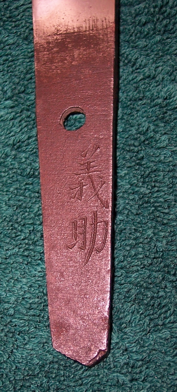

Yoshisuke Tanto is now in hand and I must say I enjoy it very much. I’ve been looking for Tantos with Koshirae for some time and the Uno kubi-zukuri style really stuck with me. Pictures are attached as the link is now disabled. It was a pleasure to do business with Touken Komachi. I took a bit of a risk with no papers on this blade but the price was very reasonable.
I believe Yoshisuke generations spanned Eisho(1504~) to the last 11th generation around Meiwa(1764)….according to Touken Komachi (Shiho Tsukada). Does anyone has any thoughts on which generation it might be or approximate period? I’m thinking later generation based on the look of the Nakago and mei not matching earlier generations. I will be submitting it to the next Shinsa board in the U.S.
Another papered Yoshisuke was discussed in this thread and shares some ….see link. http://www.militaria.co.za/nihontomessa ... 2e90a65586
I see many similar characteristics in Jigane …mokume mixe and Gunome-midare hamon. Although clearly the Mei is different. I have looked at a few different Yoshisuke and have not found any which match. Frankly most of them look more sloppy than the mei on my Tanto.
Any additional thoughts are appreciated and of course if anyone believes this to be Gemei, please speak up as honesty is preferred over politeness.
Ben M.
I would think this is a much later generation as opposed to an earlier one. Hamon is too symmetric and organized for an earlier generation.
Interesting that the hamon exactly matches on each side. That isn't all that common (Muramasa style) and perhaps that will lead you towards an answer.
Yakidashi is a Shinto style perhaps. Mei looks well done and confident...I don't see any reason to suspect gimei. Just my own opinions of course.
Brian
