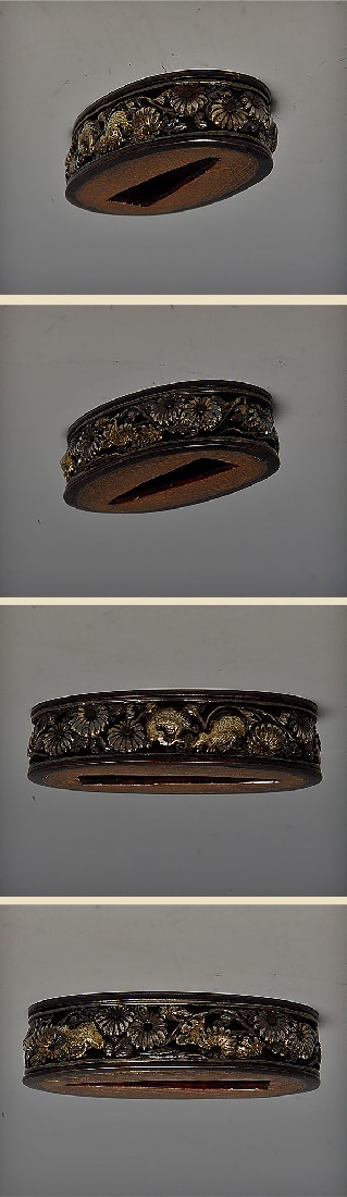

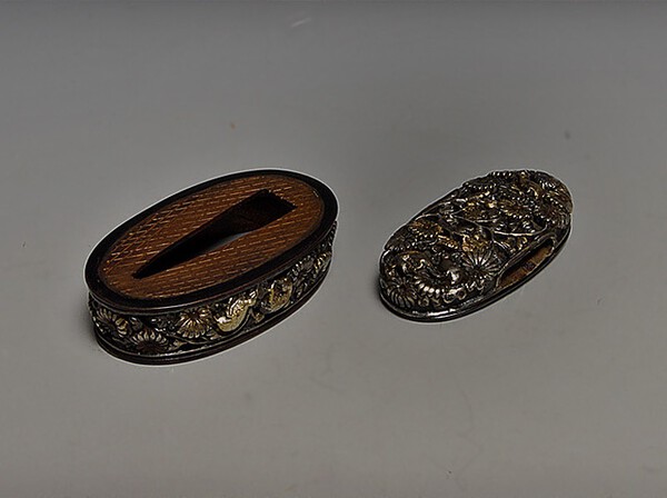

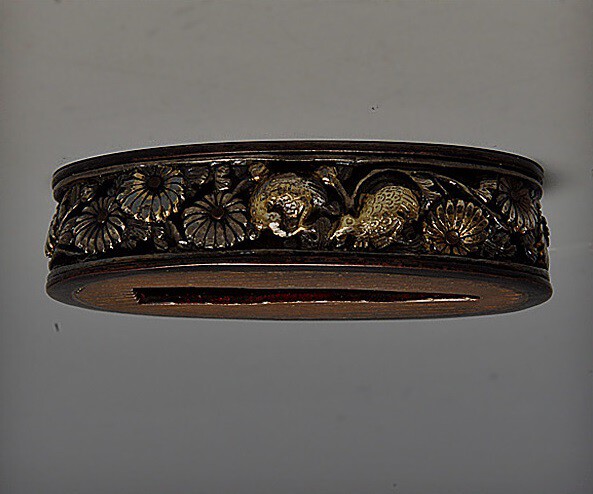

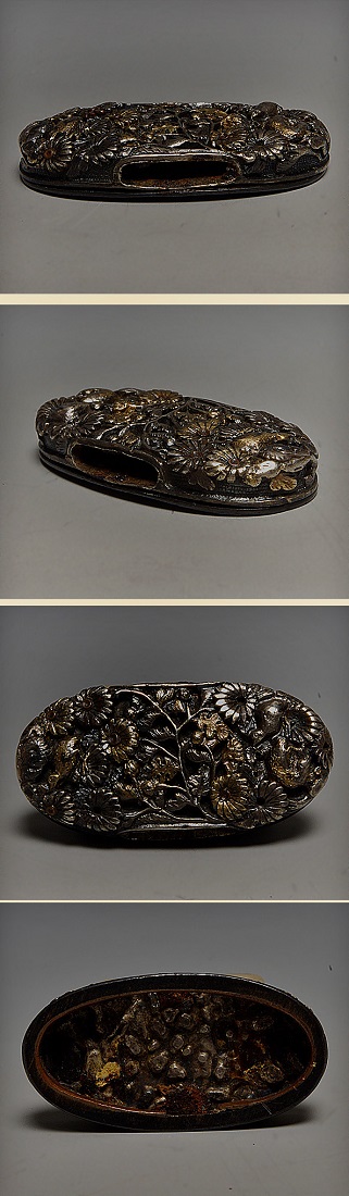

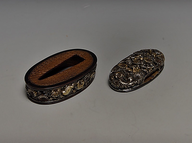

Pete Klein Posted February 1, 2014 Report Posted February 1, 2014 Here is an interesting (at least to me) F/K, papered hozon to Ko Mino: If you look carefully you will notice something different about them, aside from their classic Ko Mino construction. These have been fitted with sleeves to re-use them, possibly after they were damaged at some point. Someone felt very highly of these. Quote
BMarkhasin Posted February 1, 2014 Report Posted February 1, 2014 Very nice Pete. Do you have any thoughts or insights on early influence of koMino on Goto works? I found a comment in notes I took from a conversation with some Japanese collectors, which I am trying to pursue. They relate to orientation of karakusa in early works. I will post if/when I can track examples. Best, Boris. Quote
Pete Klein Posted February 1, 2014 Report Posted February 1, 2014 Boris -- I see little to none. Even their fabrication techniques differed. Quote

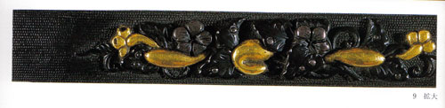

John A Stuart Posted February 1, 2014 Report Posted February 1, 2014 Pete, you said; "You know, even though it's published as Yujo I have a difficult time believing those menuki were from him. They look like rather typical Ko Kinko work." I, of course, can only rely on what is given as fact. I know what you mean though. In fact that is why I found them so telling. The ko-Mino botan menuki I posted are very similar in construction and style and does not have that typical lozenge sukashi ko-Mino shape. They were said to be yamagane and I reported true to the description, but, I believe they are actually shakudo. This change of style may be because of the Yujo influence. One or two examples are hardly conclusive. I include a close-up of the jita of a kozuka of the same theme by Yujo. John Quote

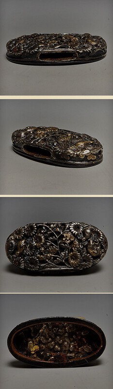

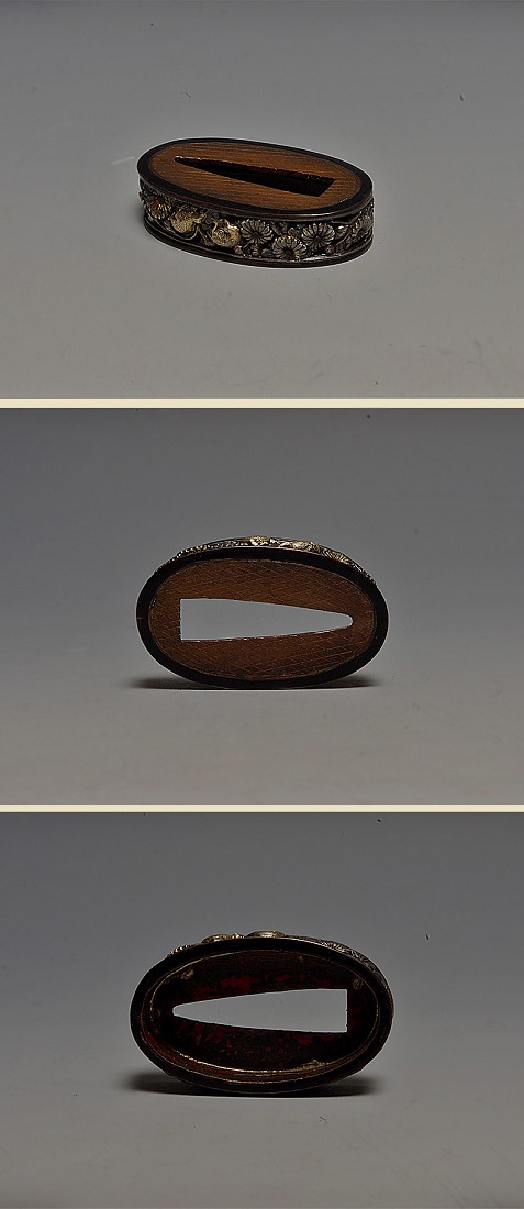

Chishiki Posted March 2, 2022 Report Posted March 2, 2022 Hi. I wanted to add these menuki to this thread for reference. Tokubetsu Hozon, Ezo. I assume they fall into the middle to later period. Mark 3 Quote
