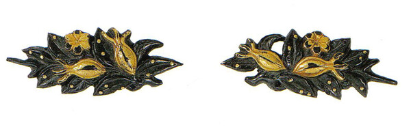

Hi Tom,
Thanks for posting those excerpts. I had forgotten where I had seen them. Below are pictured some "Ainu" style Ezo koshirae. I will try to get a better scan of the tachi style without tsukaito, and I have a few good images of the silvered type, fully banded in metal. These as you can see are dramatically different workmanship to the old, classic style of Ezo koshirae that are attributed Kamakura through Muromachi dates. The idea is that after the trade and armament restrictions on Ainu populations were imposed by the bakufu (Matsumae clan was charged with enforcement / regulation), functionally the development of northern armaments stalled, and the north became a time-capsule of sorts for this old style of koshirae. The Ainu kept creating weapons in koshirae which resembled the old traditional style, but their iron working and soft metals skills were inferior. It is generally agreed today that all such works are a local northern-most Honshu/Hokkaido products. You can still buy them today, although not cheaply. In terms of metal varieties, the banding on the koshirae range from pure silver, to yamagane and brass. Tin is also used, and gilding is fairly common. The Japanese consider such pieces as little more than mingei... which is too bad, as they are an important end-point in koshirae evolution. Dates are hard to ascribe with any certainty, and they span from Momoyama to Meiji depending on who you ask. In a few pieces I have seen, there seems a blending of old bits like tsuba which seem traditionally made early Edo period items, coupled with these more rudimentary koshirae.

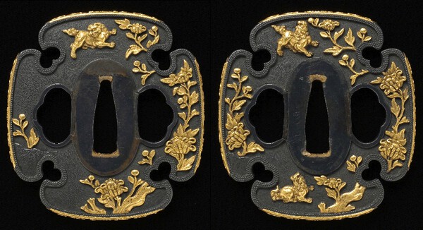

The Umetada revival pieces have been brought-up earlier, and a couple of examples of tosogu posted, as well as a reference to a particularly good and well-known tanto koshirae of Momoyama vintage (there are others if you scan the literature). I believe however that the dates attributed to the Umetada revival are a bit earlier, dating from the Momoyama/Keicho. Those dragon menuki came with a Sasano hako gaki as gold gilded shibuichi to Umetada of early Edo if I recall. I have even seen early Edo shippo koshirae in the old Ezo style. Again, I think this is a testament to their importance and favour historically.
Again, it goes to show you how bad this title of "Ezo" is, and how broadly its used. We need finer, more pertinent tosogu terminology defined for this group, but it doesnt look like that will happen any time soon.

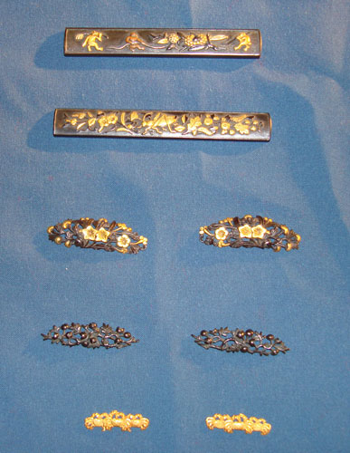

Gentlemen,
just for a decorative high-light I would like to show again a set of MENUKI which I had put on display a while ago and which has been classified by many here as 'EZO style'.
As I have learned later, they are very likely from the late MOMOYAMA period or from early EDO, as they are signed NARA.

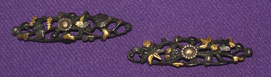

To contribute to this discussion I ask if it would be correct to say that EZO was a style or design elements historically based in earlier periods like KAMAKURA, but obviously used by later artists as well?
Jean,
we can clearly see at least 3 different styles of these sorts of 'so called' Ezo menuki and I think it fair to say that, yes, they owe something of their style to earlier fashions.
What has not been established is when exactly these types were made.
Boris Markhasin has gone further and sorted these types into early, middle and late periods. Although on what evidence other than his own subjective feelings remains unclear.
What does appear to be clear is that the various koshirae extant that have been described as being Ezo are made from a base metal of impure copper or yamagane. And yet, unaccountably, the Ezo menuki Boris has analysed appear to be made from shibuichi.
It seem far more probable to me that, rather than this demonstrating that shibuichi was developed much earlier than previously thought it suggests these pieces are of an early Edo date of manufacture. This might also account for the clear distance in design terms from the early koshirae that are supposed to have influenced their development.
As I've previously described, using shibuichi to make menuki in the uchidashi technique is problematic, it's actually the least ductile or malleable of the non-ferrous alloys used by Japanese craftsmen. Why use the alloy unless its just to mimic the genuine earlier yamagane pieces? Not to mention the wastefulness of using 20 odd percent silver in a base metal that will be gilded.

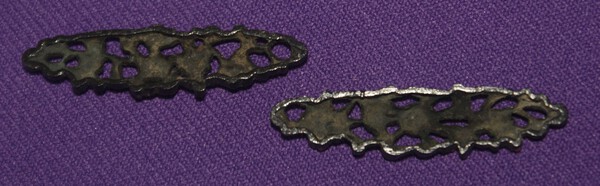

Ok, I’ll take the first bite of the poison apple of Mino-bori fittings. Early tachikanagushi worked in a soft metal medium and their focus as we can see on old koshirae was elaborate floral themes with rather sparse animal figures. Gilt copper and shakudo dominated. During the time Kyoto was the capital, and indeed the seat of the Emperor and court, the elite fittings were being made by Kyokanagushi, ko-kinko works. These artisans congregated in the sword making areas, of which Mino, especially Seki, during the Muromachi period was a, if not the, premier sword manufacturing area. The area had the resources, forests for charcoal, ores for various metals, rich clientele, at hand which was convenient. These kanagushi settled in the area and formulated their own stylisation improving on the Kyokanagushi ko-kinko styles. These are where you see menuki very similar in style to those termed Ezo, which I believe should be classed kanagushi alone. Very similar floral themes and some animal figures as in tachikanagushi fittings. It was this style of fitting that Goto Yujo was trained to make and after some further experience and training in Kyoto and upon his return to Mino helped make into an independent style in itself. Typically fall time floral and insect themes, Star flowers, Tang grass, Crysanthemums, Mantids, Crickets, etc., but, not restricted to those. Where do we draw the line for ko-Mino and Mino-bori? May I suggest sometime in the first 50 years of the Edo period. Ko-Mino being mostly from the Muromachi and Momoyama periods. It was at this time that much Mino-bori was made in Edo, the new hub of the rich clientele and sword producing area. It seems there is much disparity in the quality of these fittings, from black shakudo to brown (gold content), heavy kin-uttori to light, complicated carving to sparse. Here are some pics of Gordon Robsons SF ’07 Mino-bori exhibit, some of mine and some gleaned from the web. Included is a ko-kinko tsuba just for comparison. There is much more to say, but, a start? Menuki are the hardest to find, so, I include other types of fittings. John
Not of those. One thing that is common is there are no neashi and the edges of the menuki are roughly finished. If you go to Rich's site Kodôgu no Sekai - 小道具の世界 I remember a pair of ko-Mino menuki that he has great photos of from all aspects. He had a little write-up about them as well . It is worth checking out. Gordon will have some pics as well and could help I'm sure. John
EDIT I have the link. These menuki have silver and one neashi. Murphy's law, eh? http://kodogunosekai.com/2009/04/10/ko- ... %E8%B2%AB/

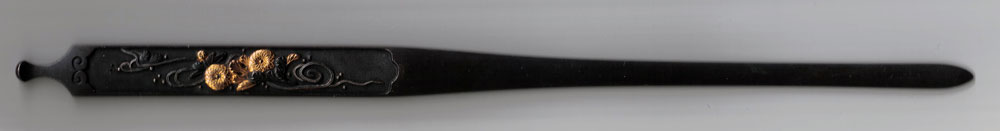

I have pics of two kogai from Tosogu no Jiten. One is ko-Mino and one is Goto Yujo for comparison. Also is a pair of menuki in the style by Yujo from the Goto-ke. May I cheat and refer you to the Jiten where there are these examples and earlier, like Onin work and others, which show how the style was in use by many schools. Even within the group is controversial attribution. As you leaf through the various Goto books you do see remnants of this style appearing from time to time. What does not persist within the Goto tradition is the large oblong sukashi type menuki of ko-Mino, Ezo or Tachikanagushi. Myself, being a novice, know that ko-Mino and related schools existed well before Yujo (Kamakura period) and am not sure what scholars mean when they mention Yujo's influence on ko-Mino fittings beyond increased use of kin-uttori and animal figurals, lions and dragons, oh my. Not having heard of silver prohibition, but, gold was predominate early when it was used, with the multicoloured gold alloys and other soft metals coming later. I am sure those more versed with the group can add data. John
