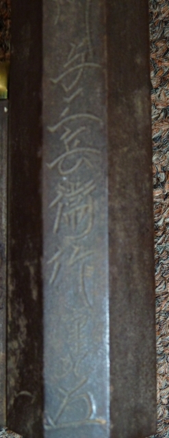

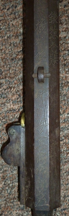

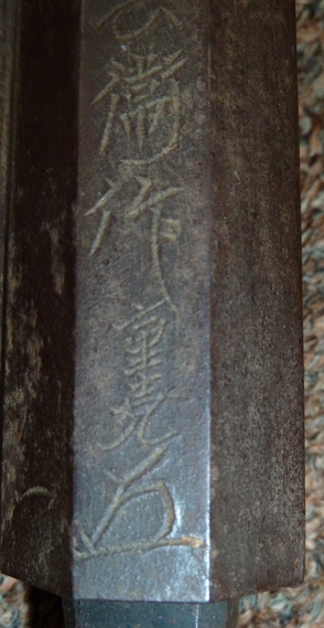

cabowen Posted January 14, 2014 Report Posted January 14, 2014 Some time back I mentioned I had a nice hinawaju and said I would post photos of the mei. Here they are....I think it reads Sesshu ju Horikawa Igawa Yosabee Saku 摂州住井川与三兵衛 作 followed by Shigeaki (Shigetaka?) 重尭 (kao)...The gun is devoid of any decoration. It is the simplest and plainest hinawaju I have ever seen, actually... If anyone has any info on this maker, I would appreciate hearing it...Thanks. EDIT: Corrected some Japanese errors (thanks Marcus!) Quote

Markus Posted January 14, 2014 Report Posted January 14, 2014 Although not a teppô guy, I think the family name reads "Igawa" (井川) and not "Horikawa" and I think the reading for the characters (重尭) is "Shigetaka". Just to mention before Justin starts his investigation. Quote
cabowen Posted January 14, 2014 Author Report Posted January 14, 2014 Thanks Marcus! I transliterated the kanji, sort of! Seeing 井, my brain was thinking 堀井 Horii, and I wrote Hori when I should have written i ! Thanks again! Quote
