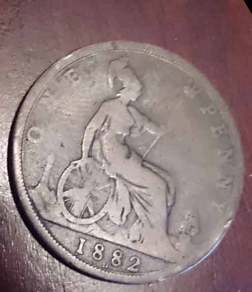

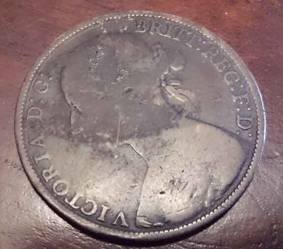

seattle1 Posted January 12, 2014 Report Posted January 12, 2014 Hello: I believe you will find that if you get a large British penny, one with a high copper content, ideally one showing Queen Victoria with its edge not entirely rounded, that the coin will remove the rust to the level of the surrounding surface and without scratching or otherwise disfiguring if there are overruns as there surely will be. Hold at about a 45 degree angle and applied only as much pressure as necessary to remove the rust and confine yourself to the rusted area even though over extending should do no damage. To prove the benign nature of this "high tech" approach, practice on some rust on another surface where the metal has about the same composition as a Japanese sword. When you have demonstrated the effects to your satisfaction, try it on the sword. I used to give such coins out at sword shows and heard no complaints from users. Any coin store will have such coins and 25 - 50 cents should get you one. Arnold F. Quote
b.hennick Posted January 12, 2014 Report Posted January 12, 2014 I still have the coin Arnold gave me twenty years ago. I do still use it as well as ivory and deer antler. Thanks again for the coin. Quote
