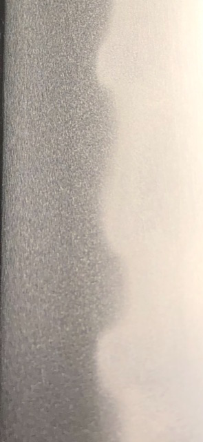

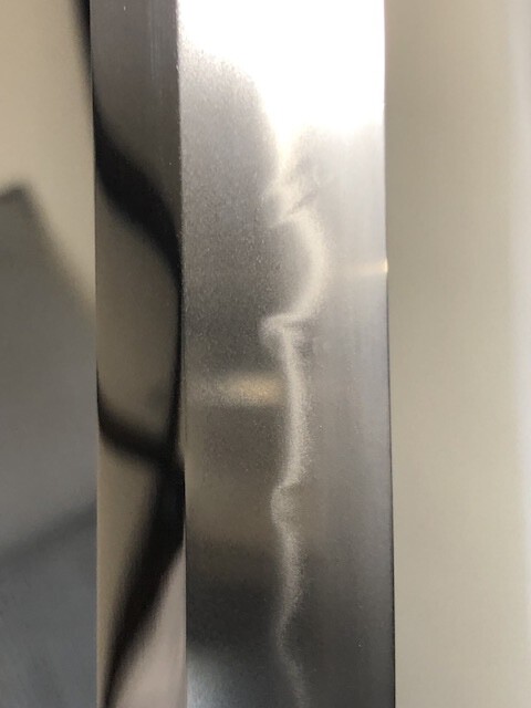

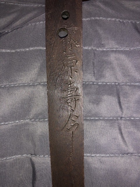

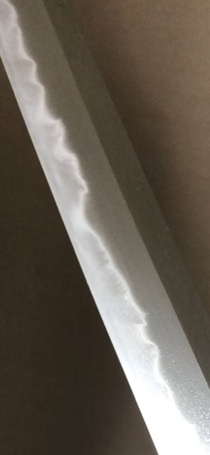

Guest Simon R Posted July 11, 2023 Report Posted July 11, 2023 @Cuirassier Resuscitating a 9 year old thread is not often a worthwhile endeavour but I wanted to add my katana by the same Fujiwara Jumyo, without any stamp, which made Hozon at the NBTHK. This was after noting George's comment above "BUT, it would be great if a member had a nihonto by him to show us?" @george trotter Simon (Video link:) https://share.icloud...Dpcfnh64puhyDwNrVbvg Quote

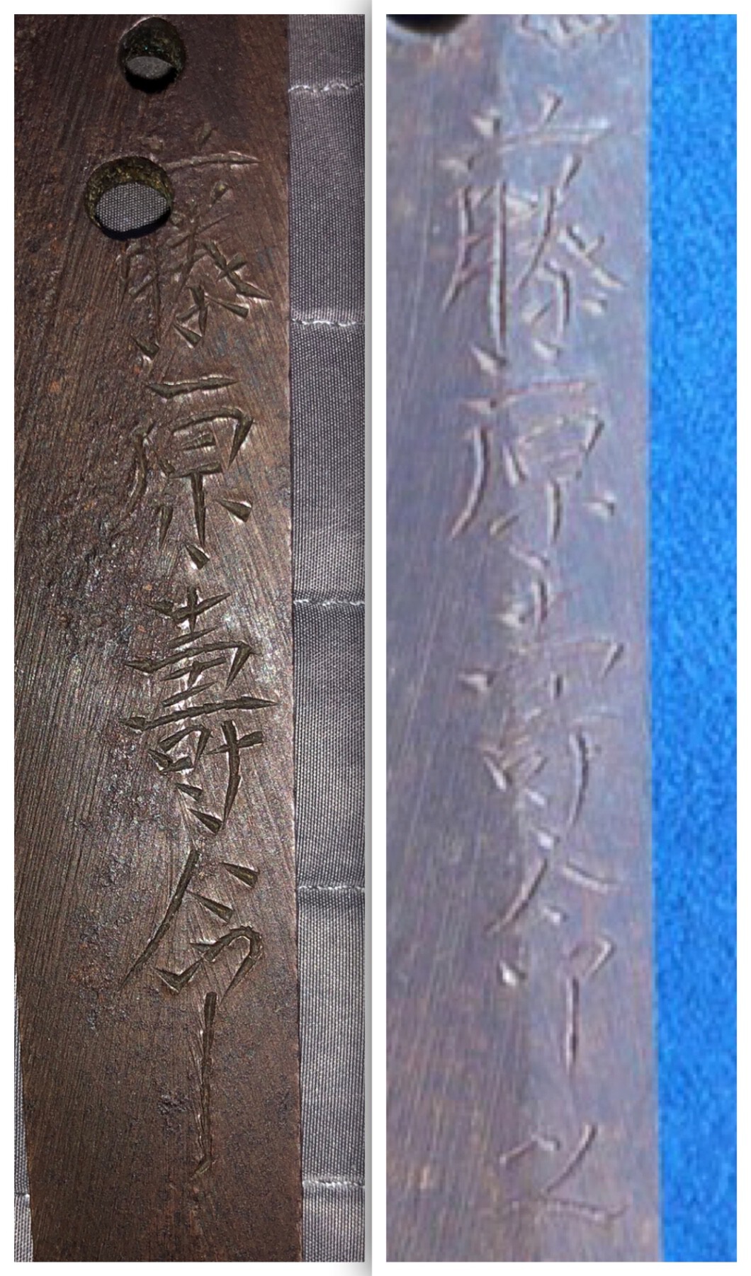

Guest Simon R Posted July 12, 2023 Report Posted July 12, 2023 Just for context, this my mei next to Marks's. @Cuirassier It's definitely the same smith (or at least the same Na-kiri-shi - but as mine achieved Hozon, I'd expect it to be a signature that was recognisable and on record with the NBTHK). Simon Quote
