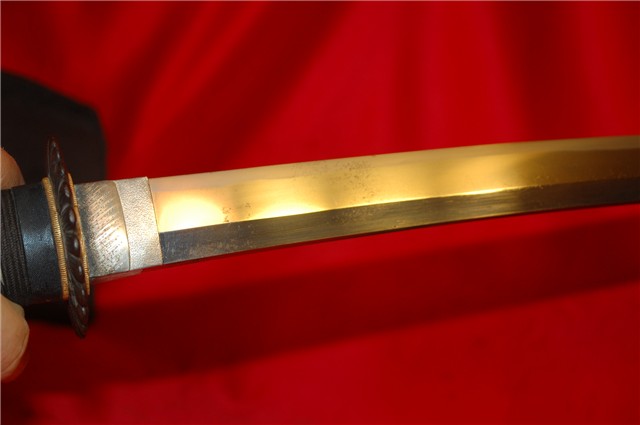

I'm buying this as gimei but was wondering if you eagle eyes can make a call on it, I do have a inspection time so if that black area on the Kissaki is too deep or if I find a crack I can send it back, I think the sum of all parts is worth what I paid, just under a grand. Fire away I can take it, yea or nei?
and rotated mei for you.

I think you did better than well. Nice tsuba, and other fittings. Kozuka..kogatana, nice menuki...the whole koshirae has got to be worth that.
Double habaki....someone thought well of it. Nakago jiri is correct, as is the patina. Don't know about the mei until I hit the books, but it isn't bad. I think the marks in the kissaki will be minor. Just want to be able to see through that hadori. But it looks like a good package, and at the price well worth a gamble. Told you he'd sell ;)
Even if gimei or mumei that is a decent price.

What has me worried is his description, it must have been given to him by someone in the know, if thats the case the know would have passed on it if something was out of place....well anyway. We'll see when it gets to the house next week.
Thanks Brian
Not necessarily - not everyone who's in the know is a dealer out for profit or interested in Hizen blades - and those that are might already own better examples. Given the inspection period and offer to take it back if it is not to your satisfaction, it's likely the source didn't notice any fatal flaws. I'm no expert but I agree with Brian - based on the fittings alone, you did well on this one.
Looks to be sooo close... look at the mekugi ana placement... the mei pics are too low resolution to really see the details, but at least this is not an obvious gimei. Great find at that price, gimei or not!
