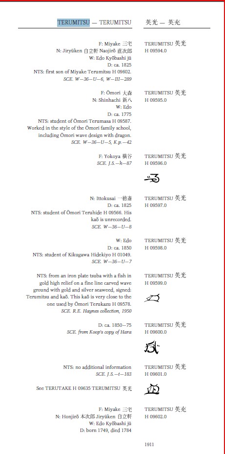

laurent Posted January 1, 2014 Author Report Posted January 1, 2014 doesn't look like Fujiwara, however it is the only signature which has exactly all the over elements. Pupil? Name change at at later/earlier stage of the career? Can't make the Fuchi out for the last 2 kanjis, don't find them either with the radicals or stroke counts Tsuba2: Omori Hidemitsu however I do not think it is it, or a second generation; examples I found were mostly signed Omori Hidemitsu, not Hidemitsu alone and the Kao was different. However the Kao style, signature style and position were right.... Terumitsu look like using another Kanji for his signatures http://www.sho-shin.com/biz-han1.html Or not... http://www.shibuiswords.com/haynesTsu17.htm Hmmm... for the Origami; it is a nanban Tsuba but I don't know what else the paper says Quote

laurent Posted January 2, 2014 Author Report Posted January 2, 2014 Good morning Laurent, The Kamon on your Saya looks like Maruni Sanbon Sugi and is usually displayed the other way up. I believe it's a depiction of Cedar Leaves. Cheers Thank you malcolm! Regarding Tsuba N°1; can't decipher it Found a close, but not identical signature for Sekibun Kano in my books Tsuba N°2: Came accross this lineage. Is it him? (attached file) Fuchi: Can't make the last 2 kanjis Quote
