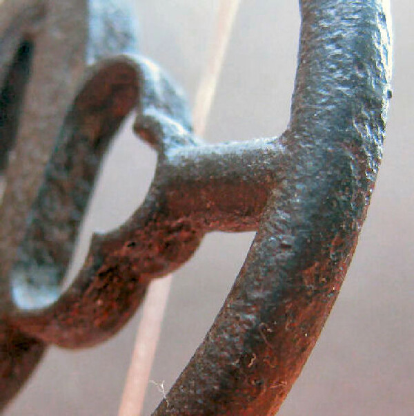

kissakai Posted December 30, 2013 Author Report Posted December 30, 2013 Hi I read all the comments with interest I have attached two tsuba that may interest you Are there any valid/interesting points that can be made about the tsuba blank? The blank is not laminated. There are file marks that criss/cross the surface and some surface porosity I can guess this is a blank of low to medium quality There are no file marks or porosity on the finished tsuba. It is not laminated The blanks has already been shown on the NMB PS With respect, the tsuba's application and 'balance' has moved off topic as this was posted to try to understand the basic iron tsuba qualities Grev Quote
