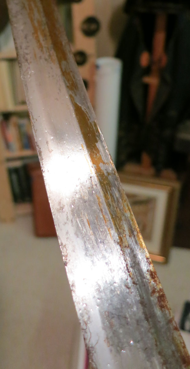

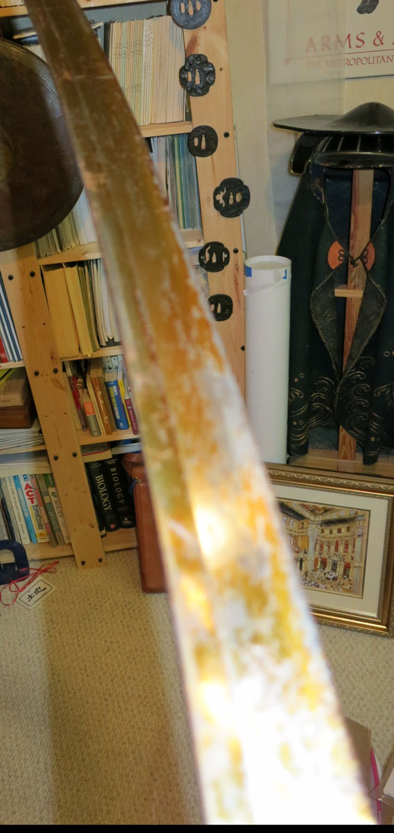

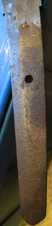

I have a wakizashi that has a pretty thick coat of varnish on the blade. Any suggestions for removal of the varnish that will not harm the blade would be appreciated. The tang fortunately was not varnished. The coat has a strong yellowish colour and is hard.

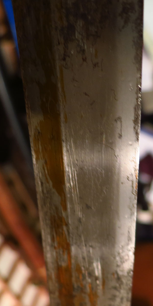

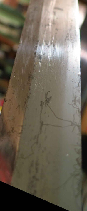

Thanks for the suggestions. I am working slowly and patiently. I now see a nice suguha hamon. The hada is not clear yet. I will try to take some photos of the progress and document the outcome.
