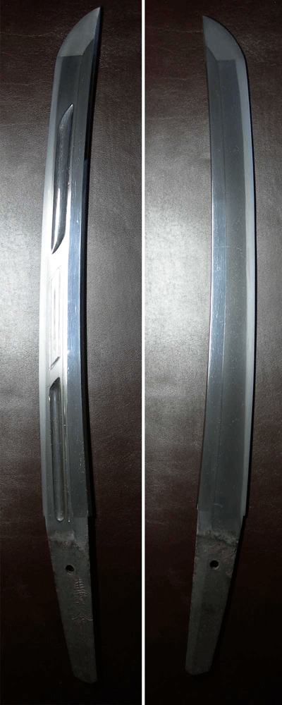

John A Stuart Posted December 10, 2013 Report Posted December 10, 2013 This wakizashi was made by Kondo Sozaemon. Motokasane 0.8 cm, motohaba 4.0 cm, sakikasane 0.7 cm, sakihaba 3.2 cm, nagasa 40.5 cm You see the dimensions are very similar, but shinogizukuri as yours is hirazukuri. Horimono on one side only of strange design. John Quote
cabowen Posted December 10, 2013 Report Posted December 10, 2013 First time I have ever seen a horimono like that.... One could say that from a practical standpoint, it would allow the blade to be pulled out easier in the case of a deep stab I suppose. The cynic in me says though it was probably done to remove some flaws... Quote

John A Stuart Posted December 12, 2013 Report Posted December 12, 2013 Hi Nick, a few years ago we discussed what these horimono may be, why on one side only etc. No conclusions could be derived. There is no evidence that they were done to eliminate kizu of some sort, just odd. John Quote
cabowen Posted December 12, 2013 Report Posted December 12, 2013 There really wouldn't be any evidence that they were to remove kizu if they successfully removed the kizu...The evidence is inferential- the fact that they are very nontraditional in size, shape, and location. Add to it the fact that they, in my opinion, detract, rather than add, to the blade, and I think the inference is a strong one. Quote

John A Stuart Posted December 12, 2013 Report Posted December 12, 2013 Yes, that could be inferred, Chris. I also wish they weren't done, but, like you hear now, 'It is what it is'. What I do like is that the jigane has that darkish steel you see on some Kamakura steel, at odds with the bright steel late Muromachi, shinto periods. John Quote
