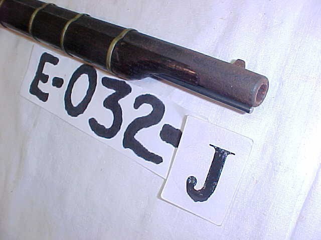

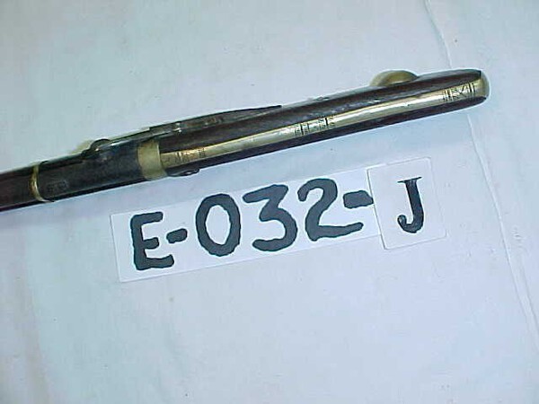

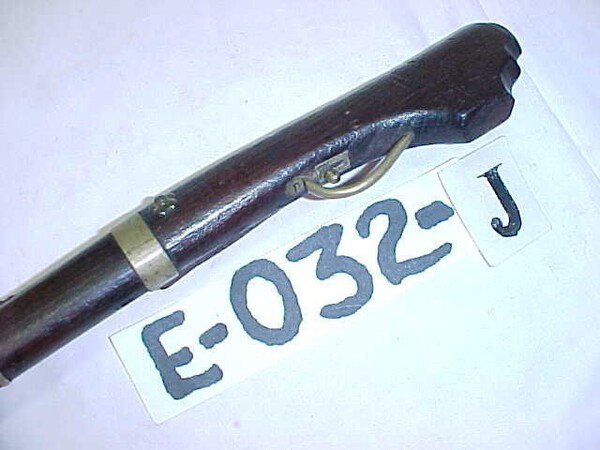

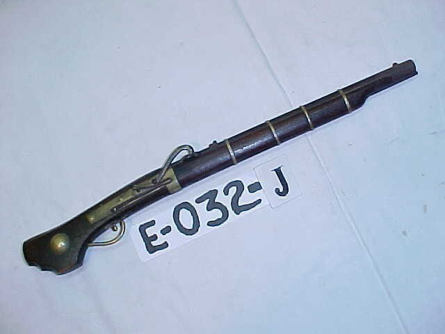

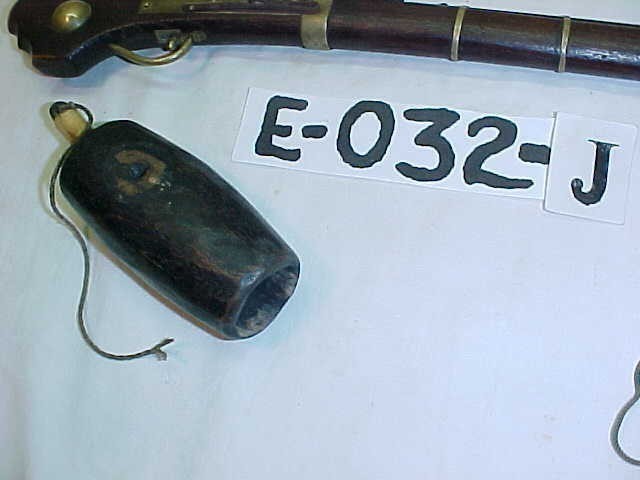

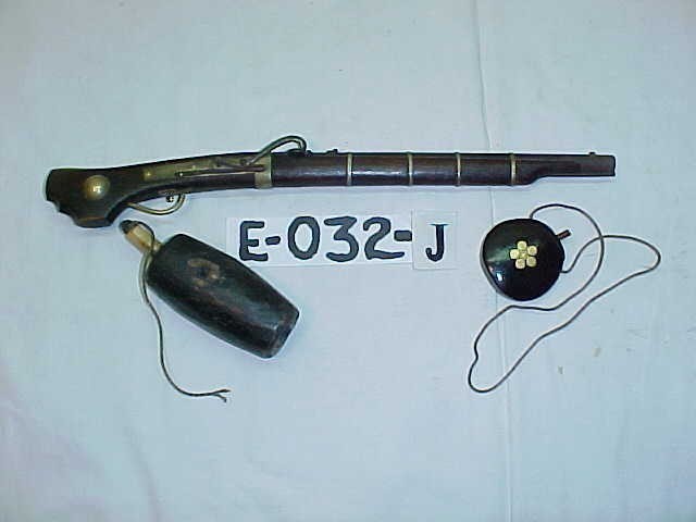

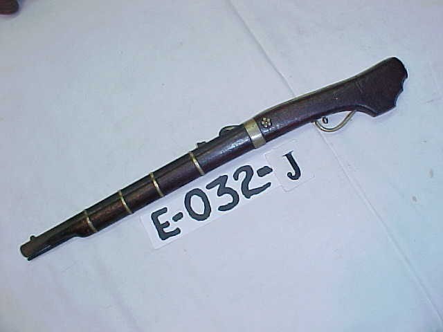

wdjensen123 Posted December 8, 2013 Report Posted December 8, 2013 Hello there, I just bought this matchlock. It appears to to be a rare childs matchlock pistol. The barrel is 28 caliber (is that 7/8 mon?) and 10 ". The overall gun length is 16". Any ideas about it? The power horn had an emblem on it, and the priming horn has the Maeda clan (I think that's it) emblem mon on it. They were all together from the seller, and belonged to it. When I get it, i'll remove the barrel to see if its marked. It was supposed to be from 1800, does that seem corret? Sincerely, Bill Jensen
Brian Posted December 8, 2013 Report Posted December 8, 2013 I think that one has been running for ages on Gunbroker? It is missing some parts though, and I doubt the "child's matchlock" description. Brian

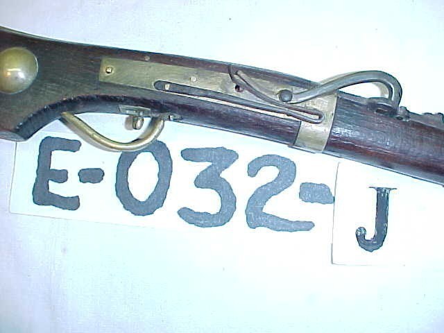

watsonmil Posted December 8, 2013 Report Posted December 8, 2013 Dear Bill, Well, ... Yes approximately 7/8 monme . Your matchlock looks to be slapped together by an amateurish gunsmith at best. The flash pan ( hizara ) appears to have a hole drilled right thru the center. This was sometimes done so that the pan could be relined, ... which does not appear to have had the job finished in this case. The pan cover ( hibuta ) is also completely missing as is the brass barrel protector ( amaooi ). Also, although difficult to identify the main spring ... it almost looks like steel rather than brass ... although this may be simply the brass having turned blackish. It is never the less NAILED through the lock plate rather than pinned ( not done on Japanese matchlocks that are well made ). The trigger guard is at best amateurishly installed and allows little if any room for the finger of even a child. The stock near the butt is in a shape I cannot assign to any school, ... nor have I seen anything quite like it before. The method of fastening the barrel to the stock using brass bands is known, ... but 4 ... actually counting the main stock ring ( dougane ) would be 5 on a barrel that is approximately 10 inches long ?? This is rather unusual if not unheard of before this example. I do not know what nor whom assembled this pistol or child's gun, ... but it was not a gunsmith but rather a blacksmith. I have been rather harsh in my criticism of your matchlock, ... but I think you want an honest opinion. Take note, ... this is my opinion and others may have a more favourable take on your gun. ... Ron Watson
John A Stuart Posted December 8, 2013 Report Posted December 8, 2013 I also find it hard to imagine it specifically a child's gun. There may be a reason it is shorter, like carried by a mounted bushi or something. I moved it to the general section since it isn't Nihonto. John
Baka Gaijin Posted December 8, 2013 Report Posted December 8, 2013 Good evening Bill, The Kamon on your Powder Flask looks like Umebachi or Kaga Umebachi. (Japanese Apricot Flower). Cheers
wdjensen123 Posted December 8, 2013 Author Report Posted December 8, 2013 That Kamon looks like a match. Attached is a photo of the Maeda Kamon I was comparing it to, could it also be this one? How do you tell which one is correct? Sincerely, Bill Jensen
wdjensen123 Posted December 8, 2013 Author Report Posted December 8, 2013 That hammer spring is iron or steel. The ramrod is iron or steel, and is vey likely a replacement. The seller says the pan is intact, and the powder will not fall out of it, even though it looks drilled out. Touch hole is not reamed out either. The bands would likely slip off easily to allow me to pull the barrel to see if the barrel has a signature. If a blacksmith made it, would there be any signature? It seens strange that the barrel is completely round? Sincerely, Bill Jensen
watsonmil Posted December 8, 2013 Report Posted December 8, 2013 Dear Bill, On the tanegashima ( matchlock ), ... the main spring is pretty much always brass. By all means have a look under the barrel to see if there is a signature. Some tanegashima do have round barrels. It would also be of interest for you to post a photo of the barrel removed to see the shape of the breach plug ( bizen ). A photo of the pan area would also be helpful. It is a difficult little gun to figure out without having it in hand. It is most likely the ramrod is a replacement although some matchlocks did have iron ramrods. ... Ron Watson
wdjensen123 Posted December 8, 2013 Author Report Posted December 8, 2013 I thought the iron ramrod was a replacement since it is not plum brown tarnish, I have heard of matlock pistols with iron ramrods. As for the primitive malformed triggerguard, I believe that the spacing Would allow room for a childs finger, which made me think the more its a childs matchlock. Any other opinions as to wheter its for a child or not? And also on the dating to 1800 AD. Most of the Matchlock pistols I have seen have an internal mainspring which make little sense here, could it be a fake matchlock? Or not all original? Sincerely, Bill Jensen
watsonmil Posted December 8, 2013 Report Posted December 8, 2013 Dear Bill, The only sure way to date a matchlock is if it is signed, ... and the gunsmiths signature and working dated can be found. There is a somewhat incomplete listing in Japanese text only ... unfortunately. Some matchlocks ( pistols or muskets ) have an internal spring and others have an external spring depending upon the gunsmith and/or school. I cannot say whether your gun is all original, ... I have some doubts however. It has been fudged with somewhat I think, and may have been made up from a much different looking gun. I simply cannot answer you. ... Ron Watson
wdjensen123 Posted December 8, 2013 Author Report Posted December 8, 2013 28 caliber, 7/8ths mon seems like a very tiny ball. Could it just be for a farmer to scare off animals, or for target practice. It does not seem to be a military application with such a small caliber. Any ideas? Sincerely, Bill Jensen
watsonmil Posted December 8, 2013 Report Posted December 8, 2013 Dear Bill, Definitely not military, ... at .28 cal. God alone will know its intended purpose. It is also not of the quality one would expect of a target firearm. Your gun is an anomaly ??? ... Ron Watson

watsonmil Posted December 9, 2013 Report Posted December 9, 2013 Dear Bill, The ugliness ( for lack of a better word ) of your matchlock does not stem from the barrel bands but rather the overall lines of the gun. They are just all wrong. The poor quality fitting of the trigger guard to the stock, ... the nailing of the lock to the stock. The stock butt shape is not well executed and actually looks clumsy to grip in a firing position. These are all contributing factors in my eyes. I am sorry but I cannot find any redeeming features on this matchlock. ... Ron Watson Dear Henk-Jan, Yes, ... I read the word hypothetical. Sometimes brainstorming and being hypothetical can lead a novice far from reality. This is the problem I have when trying to point out why a certain gun is just not correct or of sufficient quality to bother owning. There is nothing here in my opinion to learn but to ask advice before making a purchase ... not afterward. ... Ron Watson
wdjensen123 Posted December 9, 2013 Author Report Posted December 9, 2013 Does anybody know of another example of a Japanese matchlock with a iron / steel mainspring? Does this mean its a later repair, or could it be an anomolous old original part? Can blacksmiths make iron springs? I have heard of matchlocks with iron locks though. Sincerely, Bill Jensen

watsonmil Posted December 9, 2013 Report Posted December 9, 2013 Dear Bill, Regarding the steel main spring. I personally have never seen an iron outside main spring. I will not say that they do not exist ( being too definitive with the tanegashima will get your fingers burnt ). I think in your case it is a replacement that someone has fashioned to operate the mechanism. ... Ron Watson

estcrh Posted December 9, 2013 Report Posted December 9, 2013 wdjensen123 said: The bands would likely slip off easily to allow me to pull the barrel to see if the barrel has a signature. Bill, good idea, see if you can do that and take some pictures, that should help solve this mystery.
