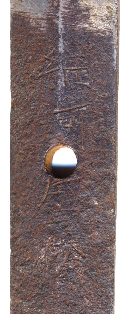

Dear All
Looking for some help with the kanji on a ken.
Looks like maybe koto or early Shinto
1. The kanji has the 田ta radical (Den, ta – rice field) on the right hand side
Not sure of the left hand side
2. looks like 河wa, ga
3. might be a kanji under the mekugi ana but I am not sure
4. maybe 盛mori, 成 nari, or maybe not
5. Might be 命mio,naga, or maybe not
11 ¾ inch long
Midare suguha
Course masame/running itame hada
Thanks for any help
david mcdonald
Dear Markus
Thanks, I missed hoso
Spent the afternoon looking in my books to see if I can find a listing of
Hosakawa Mori ?
Looked at Moritoshi first and then look at others.
so far I have not yet found a smith that signed like that.
thanks again
later
david
I read "Hosokawa Moritoshi"
細河盛俊
But only sure about the first three characters.
It seems that there was no koto smith using these characters for "Moritoshi".
Also I was unable to connect the family name "Hosokawa" to any of the Moritoshi
found in the meikan records. So the smith is either meikan-more (not in the meikan
lists), or there is always the possibility with ken that they bear the name of their
donator if presented to a temple or shrine.
Dear Markus
I also did not find anything in my books. Thanks for looking.
So maybe meikan-more.
I did not know that that the name of donator were placed on ken. Interesting.
later
david
