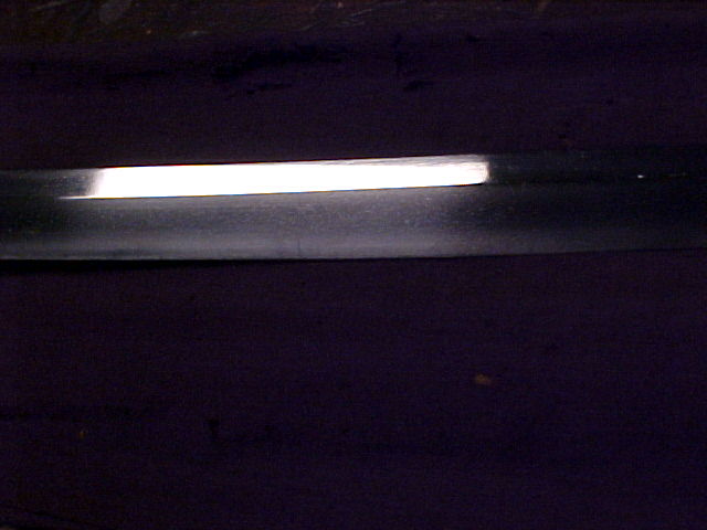

Brian Posted June 25, 2007 Report Posted June 25, 2007 I sure hope that this mark is just a scratch or stain, and not something more... Brian Quote

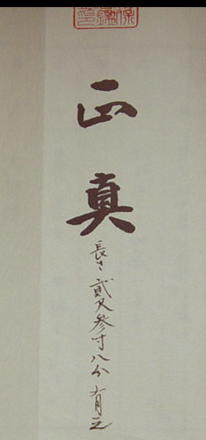

Guest Simon Rowson Posted June 25, 2007 Report Posted June 25, 2007 Nice gold inlay (as engraved by appraisers such as the Honami when they were cutting down a longer blade) and possibly a nice hagire to go with it ...well spotted Brian. Quote

Ed Posted June 26, 2007 Report Posted June 26, 2007 Stephen, I have seen that character shown as "Sane" in Yumotos. Perhaps it can be pronouced either way. Nihonto Kanji pages show: 真 Zane. Oshigata on pg 392 of Fujishiro's, are shown as "MasaZane" on pg 173 of the english translations. Either way, for the bidder who is bidding like crazy on it, I hope it is legit. It is over $5000 now. Quote
Pete Klein Posted June 26, 2007 Report Posted June 26, 2007 I believe that is also pronounced 'Sho Shin', just as on the NTHK origami. Quote
Ed Posted June 26, 2007 Report Posted June 26, 2007 Pete, That had occurred to me, but I disregarded it due to the fact it didn't seem to make sense. It seemed to me that a name attribution would be more fitting on a mumei sword. Shoshin roughly means authentic or truth. Authentic what ?? Merely an authentic sword ?? What do you think ??? To me the inlay looks poorly done. Maybe an attempt to fool ole gaijin into believing it had to be good with gold writing on it. Just my worthless opinion, perhaps one of the Big Dogs will come out and enlighten us. :D Quote
Guest Simon Rowson Posted June 26, 2007 Report Posted June 26, 2007 My wife came up with "Masa Shin" which didn't make any sense to either of us - hence my not posting it. She did say that the second kanji was a variation of "Makoto" (sincerity) but, as she's just gone on business to Kobe, I can't ask her for any more details. Maybe the would-be buyers are tranlating the "Masa" and then wishing the second character into "Mune"! (We'll get a flood of new "I found the Honjo Masamune" posts if that's the case). Simon Quote
Bungo Posted June 27, 2007 Report Posted June 27, 2007 masazane.....have a jumonji yari with that kanji on the NTHK ( OLD Yoshikawa Sensei )paper. Same kanji as that used as" sho shin " on shinsa paper as Pete pointed out..... the dark line is worrisome though. milt the ronin Quote
Stephen Posted June 27, 2007 Report Posted June 27, 2007 here's a photo negative if you blow it up sure looks like a crack to me. Quote

Brian Posted July 1, 2007 Report Posted July 1, 2007 Well...it appears everyone who is bidding is hoping it is Masazane. Not long to go. The seller is confident that it is not a hagire, so let's wish the high bidder good luck with it. Could be the sleeper of the year, or just a nice katana. Definitely the ebay Nihonto auction of the year Can't say I would spend that much online without having it in hand, but apparently there are many who hope for the prize, enough to spend big $'s. Good luck to the seller and the winner Brian Quote

Bungo Posted July 1, 2007 Report Posted July 1, 2007 from one of the question and answer........ " Hi Mary. The signiture is what they call kin mei (gold signature) and is signed KANESADA. There were a number of smiths who signed this way from the 13 th. century up to modern times and it usually means that the smith was famous when it is gold filled. Don't be too concerned about the mounts, it is ONLY the blade that collectors are interested in. Hope this helps. " Masazane = Kanesada ? milt the ronin Quote
