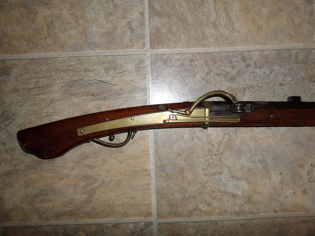

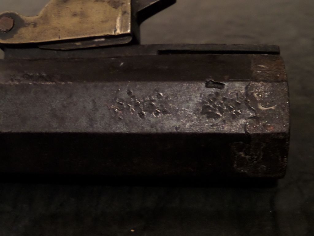

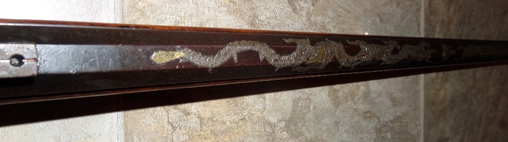

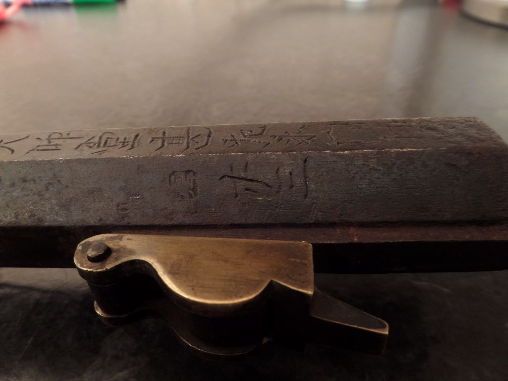

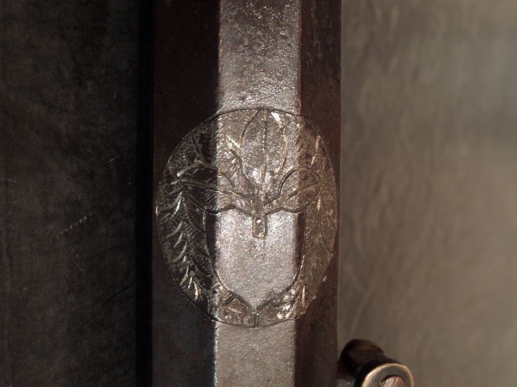

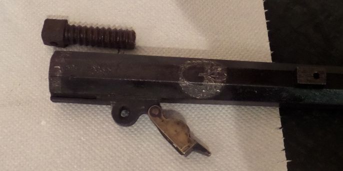

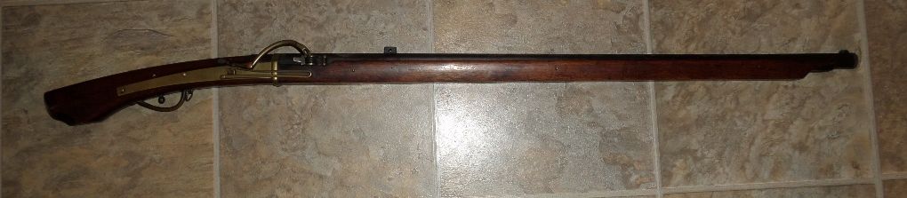

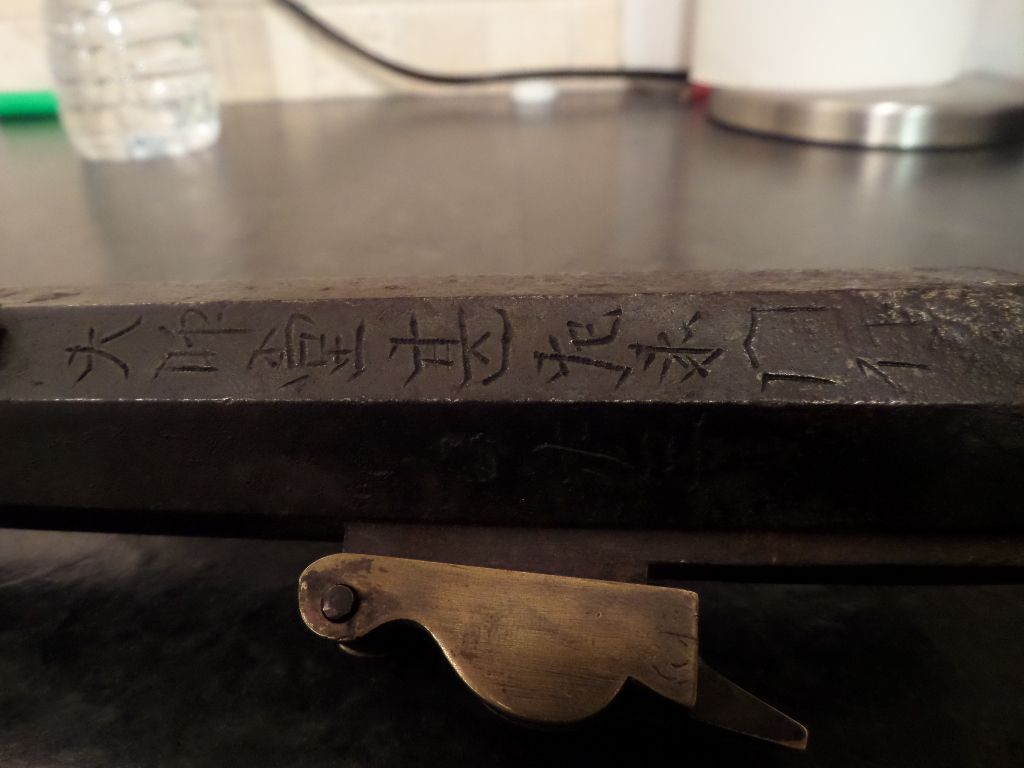

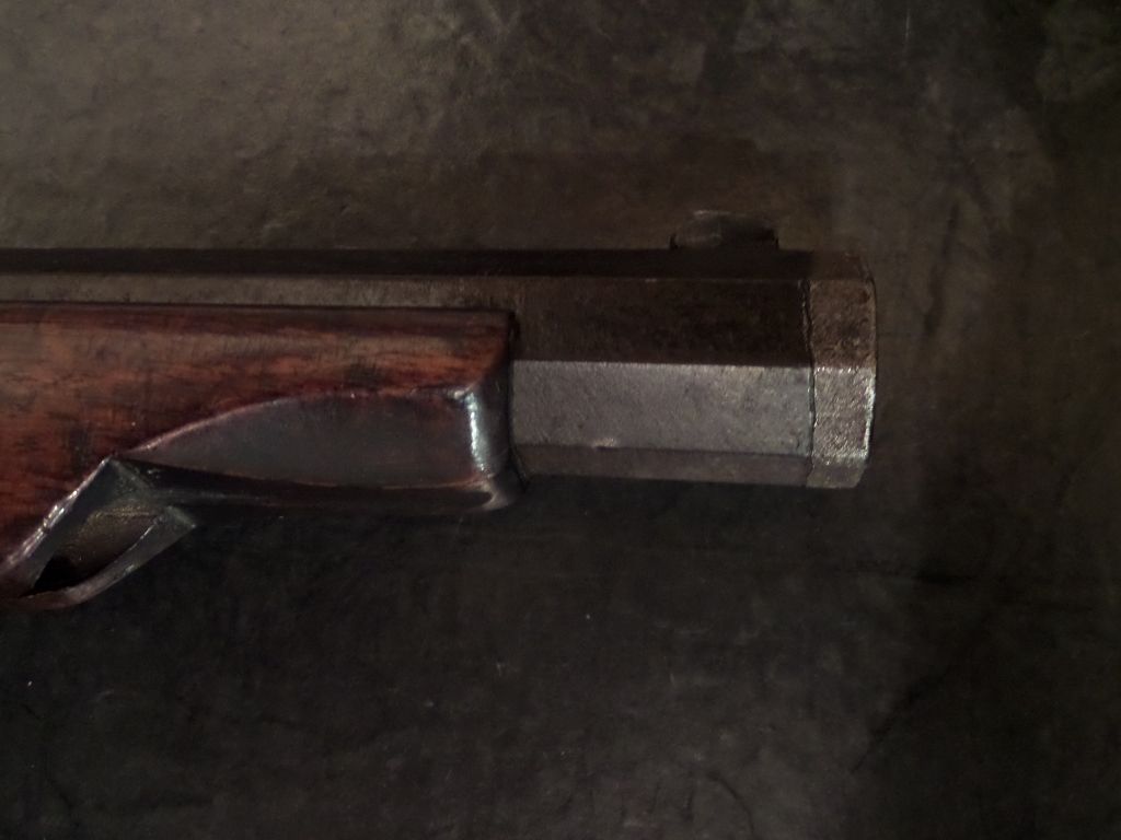

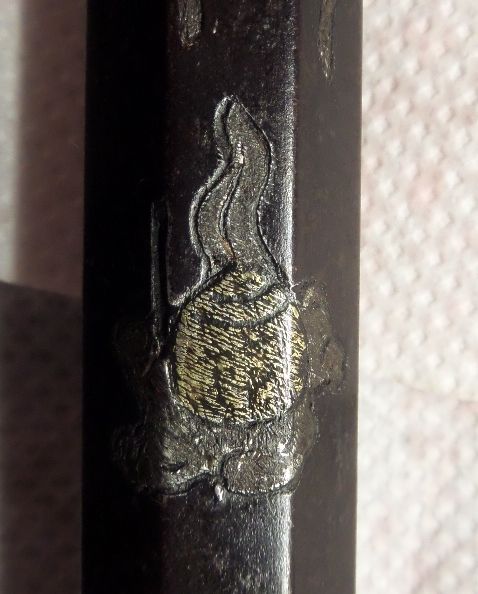

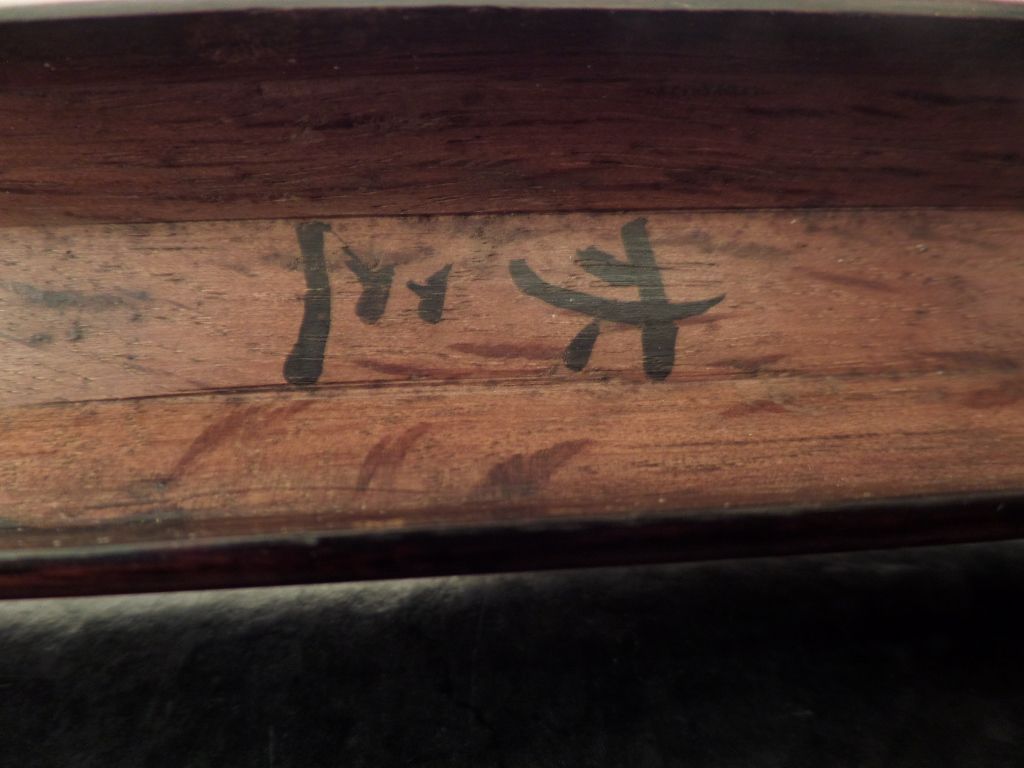

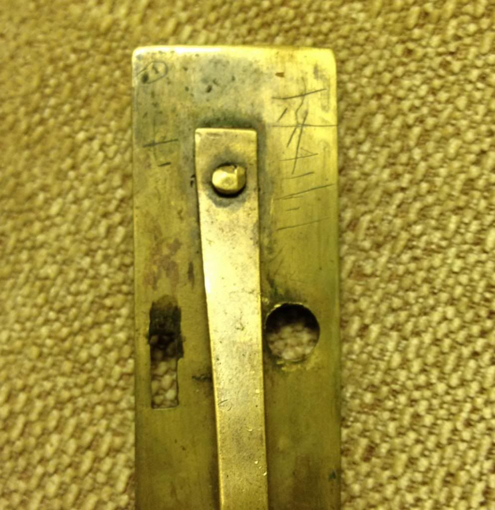

redhugster Posted November 19, 2013 Report Posted November 19, 2013 Hello! I am new to the forum and have joined as I have just purchased a matchlock with the intent of shooting it in time, if it proves to be correct and of course safe. I shoot original black powder muskets and rifles and a lot of my shooting friends have Japanese Matchlocks here in the UK, so I have plenty of sources of advice on that front....however I know nothing of Japanese script, signatures, Mon and Kamon - so I am hoping someone here will be able to help. Photo 1: Firstly this it what it looks like... Photo 2: Wisteria Kamon (Fuji) - is this correct? Photo 3: Mid barrel - what on earth is this? Photo 4: In the barrel channel Photo 5: Under the barrel...The script is the same as above but can anyone identify the cartouche Photo 6: Script under the barrel Photo 7: Top of the barrel...has this been defaced? Photo 8: Dragon on the top of the barrel Photo 9: The Mechanism Photo 10: The Muzzle Any thoughts most appreciated and thank you for looking at all the photos. Best Regards Jon Quote
Ken-Hawaii Posted November 19, 2013 Report Posted November 19, 2013 Hi, Jon, & welcome to the forum. As soon as Piers sees your post, I'm sure he will respond. Aloha! Ken Quote
Drago Posted November 19, 2013 Report Posted November 19, 2013 Photo 1: A beauty! Photo 2: sagari-fuji mon - usually used by the Fujiwara clan Photo 3: This is a flaming pearl. If I remember correctly, this represents wisdom/wealth/luck and the eternal pursuit of it. Asian dragons are often depicted together with it. Photo 7: Looks like something was removed. But perhaps we're reading too much into some signs of usage... Quote
watsonmil Posted November 19, 2013 Report Posted November 19, 2013 Dear Jon, Your matchlock ( Tanegashima ) appears to be a Kunitomo Gun. We should get a clue once the signature is translated. The town of Kunitomo is located in the central part of Honshu Island quite near Lake Biwa. There are many styles of Tanegashima ( often mixed ) but to my eyes at least your gun displays more characteristics of the Kunitomo than any other school. You gun of course is missing it's ramrod ( karuka ) and I note it is also missing a brass plate which protects the barrel from the burning of flash powder. This brass plate is called an Amaooi. The first thing you will want to do is to check and see if the gun is still loaded. To do this get a wooden dowel long enough to reach the bottom of the barrel. If it stops say 3/4 of an inch above the touch hole then you will know it is loaded with at least powder and wadding if not powder wadding and ball. About half the tanegashima I own were still loaded at the time I received them. If it is loaded and you are not familiar with a ball pulling worm to unload the gun then contact me at : watsonr@mts.net and I shall respond. I also note what appears to be a lack of breach plug end ( usually square ), .... could you please post a photo of the breach plug ? Someone else will have to assist you with the mon on the barrel as there are usually several possibilities. Overall a nice restorable tanegashima from what I can see. ... Ron Watson Quote

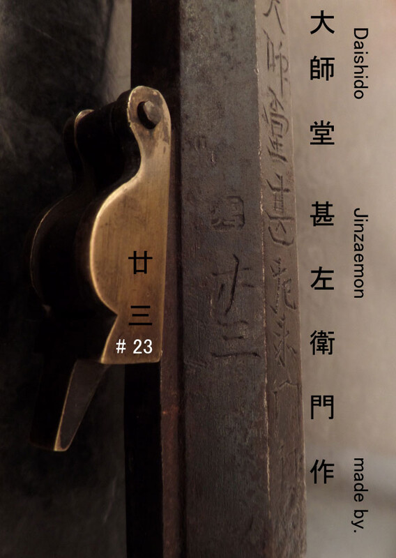

k morita Posted November 19, 2013 Report Posted November 19, 2013 Hi, Maybe matchlock smith in Sakai? The matchlock signature says "Made by Daishido Jinzaemon".(Dai-shi-do , Jin-za-e-mon) Quote
Bugyotsuji Posted November 20, 2013 Report Posted November 20, 2013 Not much to add really, as Drago, Ron, Morita San etc., have already answered most questions. On the face of it, a nicely presented gun, I agree. You may want to source a proper hollow hinge pin. Strange marks on the barrel were often made by the vice when trying to open the large Bisen breech screw that Ron mentions above. (The screw sometimes gets split and destroyed in the process if not done correctly.) How is the inside appearance of the pan? Can we get a shot of that? Most importantly, once you know the barrel is clear, how badly pitted is it? If I am teaching my grandmother to suck eggs, please forgive me. Many extant examples were not kept clean inside, for a number of reasons, and blackpowder residue is especially unkind to steel, so you may want to take it easy on the charge in the beginning if you are planning to fire ball from it. As we know, these Tanegashima are pretty toughly made, though. Although it looks more like a Kunitomo gun, as Ron says, (lacking any of the gaudiness of Osaka guns), the smith Daishido Jinzaemon is a true blue Sakai/Settsu smith. Slightly unusual with a signed gun not to have the region 摂津住 inscribed above the signature. Congratulations on your purchase, by the way. Quote
watsonmil Posted November 20, 2013 Report Posted November 20, 2013 Dear Piers, That is most unusual, ... a Sakai/Settsu smith ?? I guess I should not be overly surprised given the free license some of these smiths worked under. I expected to see Kunitomo in the kanji, ... but NO ! The more I see of the Tanegashima ... the more confusing it becomes. After all, ... a Winchester looks nothing compared to a Remington, ..... until the age of the bolt rifle and then it takes the novice some time to spot the differences even though to the trained eye they are obvious. In the case of the Tanegashima often so little follow a standard it is often difficult even for a person with the knowledge and a good eye to put two and two together. I'd be interested to hear your opinion on this by the way. ... Ron Watson Quote
Bugyotsuji Posted November 20, 2013 Report Posted November 20, 2013 Yes, Ron, I know of many smiths who were attracted this way and that by competing Lords for their gunsmithing know-how. Often smiths will write a place name with Ju 住 indicating that was where they were living, whether temporarily or permanently. Lack of this may simply indicate he was not living in Settsu at the time. Interestingly a quick check of the Kunitomo smiths list shows some Kunitomo Jinzaemon names, possibly descendants of this chap. (?) Was he an early migrant smith then? If he was early this might also explain the lack of any strong regional or Ryu-ha characteristics in the gun. As if starting from neutral? I like the shape of it, but many Tanegashima really do have no strong defining characteristics. I also find them puzzling. Things are easier when the hints are clearer. I would have expected the brass retaining band to be much wider for Sakai, for example. You would never guess Sakai from those photos alone. Quote

Bugyotsuji Posted November 20, 2013 Report Posted November 20, 2013 Great to hear you are happy, Jon. Some of your questions will be sadly unanswerable. Unlike swords, very little is known about Japanese gunsmiths. Even having a name you are lucky. This Jinzaemon could be old, as far back as the beginning of Edo, but that would take quite a bit of detective work to suss out. Very interesting to hear of your exploits, and I was surprised to learn that there are Tanegashima shooters in the UK. Where are you based? The pan has been drilled out as step one in refurbishing it. They corrode over the centuries until a) The Yaku-ike bowl is too large and deep, and b) the enlarged vent allows too much blowback. The operation is called "Bugu Naoshi" in Japanese. You get a new circular plug inserted below. Then the pan is drilled and plugged sideways, entering through the outer edge of the pan. A new vent hole is drilled into the new plug, and finally the rim is plugged and smoothed over. You can recognize pans that have been renewed by the circle under the pan, and the dotted circle on the outside rim of the pan. The silver rim around the muzzle looks in the pic to be a decoration to balance the one at the other end... but is the metal actually different? If so, it's a first for me and I have seen hundreds of these guns. Sometimes you will find a barrel that has been cut down, and workings or artificial ageing around the cut edge to make it look old. Stock, Japanese Akagashi, red oak, yes. "No 23" highly likely production number of gun, with the same number written inside the stock. Cannot see the stamp well enough to comment, but quite unusual. Whether to have the inlay freshened up is your decision, but often people polish them to death when they reach the West, removing much of what was good. Consult an artisan and see what he would charge. The dragon is chasing a 'Hoju' the precious jewel of life and mystery. As to quality, I would say medium. Many of these decorations were added in early Meiji to please Westerners, but they are slightly frowned upon in Japan purist circles. It is not low quality, but it is not top quality either. Even so, probably a better example than some of the guns that have found their way to the West, a good standard gun IMHO. PS The file marks around the muzzle and the darker staining area may indicate some repair work done to the muzzle... Quote
watsonmil Posted November 20, 2013 Report Posted November 20, 2013 Dear Jon, Piers has answered most of your questions. Regarding the loose breach plug ( bizen ) .... On the Japanese matchlocks, the breach plugs rarely fitted properly. The Japanese technology of cutting thread was not up to standards and consequently the breach plugs were often not tight enough to make a proper gas seal. The Japanese solution to this was to wrap sheet lead around the male thread and then screw the breach plug into the barrel. The lead took up the looseness and once the gun was fired a few times, the fouling finished the job of providing a seal from the inside ! The silver around the muzzle is simply a type of inlay using a technique known as nunome zogan. ( hammering silver onto a filed surface so that the silver sticks to the iron ) ... you can actually see the file marks in your photograph if you look closely. This is not repair work as Piers erroneously stated. Next, ... you mention the inside of the barrel being somewhat pitted. DO NOT ream the barrel out to get rid of these as this is STICTLY against the rules of the Tanegashima competitions ( as is sleeving or adding rifling ). If the gun is not fit to shoot as original ( inside barrel ), ... then you cannot compete with it in regulated competition. A little pitting will generally not disqualify your gun from competition. Next, ... regarding the number 23. This is probably number 23 of a lot order by one daimyo ( clan leader ) for his troops. The inlay work would have been added later as Piers states for the attractiveness of sale to Europeans. It is not the quality of work nor is the overall quality of the gun of the caliber to be a special order for a wealthy Samurai. Your gun is in nice condition and I would place its manufacture at early to mid 19th century. It is not however a masterpiece, ... just a good serviceable firearm. ... Ron Watson PS. My opinion is to leave the inlay work as is. I would not recommend having some craftsman touch up ANY of the inlay as I see it, ... as it appears to my eyes to be good and original Japanese craftsmanship. Quote

Bugyotsuji Posted November 21, 2013 Report Posted November 21, 2013 It just happens that in Urabe's gunsmith list there is a Daishido Jinzaemon in Settsu Province who signed a gun with the date 安永4年, (1776) which (assuming this is the same smith) tells us that he was making guns before and/or after 1776, (An-Ei ran from 1772-1781) , the year of the US Declaration of Independence, shortly before the French Revolution in Europe. In the middle of the long Edo Period, right about where Ron's educated intuition was pointing him. Quote
