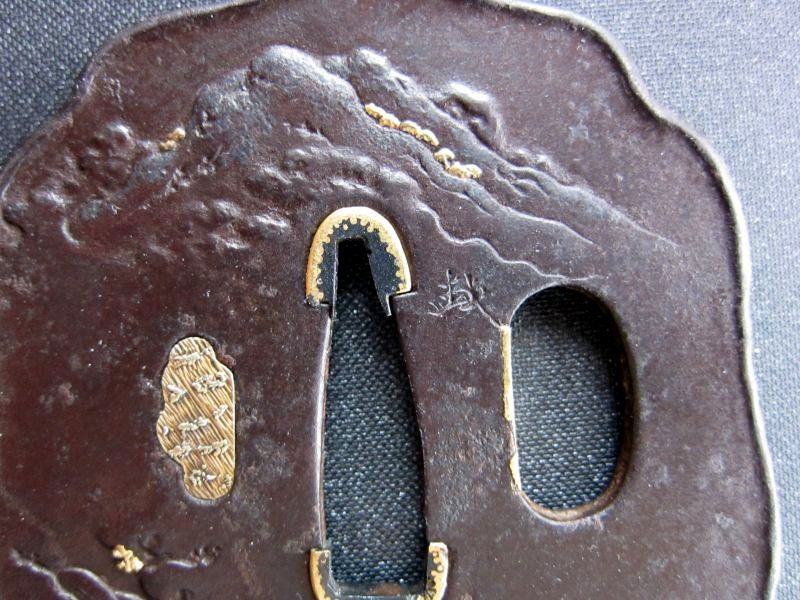

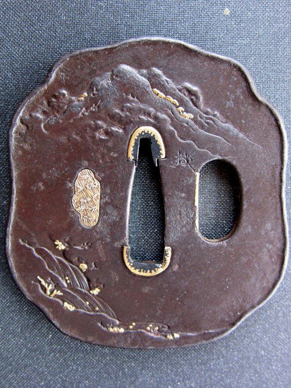

Bernard Posted November 17, 2013 Report Posted November 17, 2013 Hello everybody, I wonder if this tsuba (6.9cm X6.3cm) can be assigned to the Tanaka school ? What is your expert opinion (hope you can read the mei, it is not clearly legible) ? Regards. Bernard D Quote

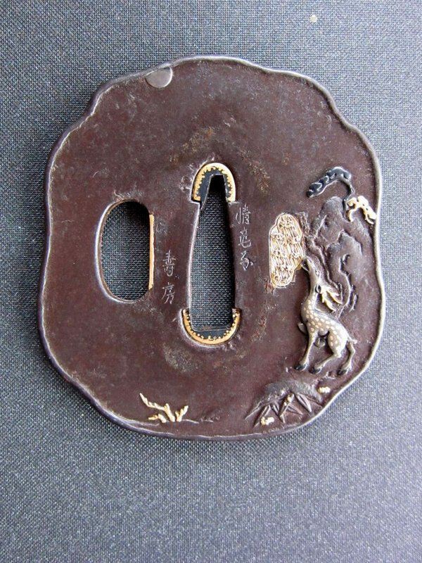

Gunome Posted November 17, 2013 Report Posted November 17, 2013 Hello I also thinks it is a Tanaka I was not able to decipher the mei except : XX no kami Toshi X hope it help Quote
Bernard Posted November 17, 2013 Author Report Posted November 17, 2013 Guido, you found the maker and it confirms Tanaka school. Great ! Many thanks to you. Thanks also to Gunome and Thierry for their replies. Bernard D Quote

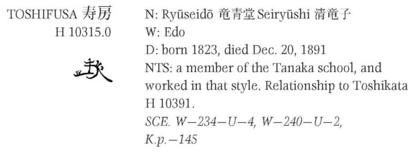

Pete Klein Posted November 17, 2013 Report Posted November 17, 2013 Here is the mei from the Shinsen Kinko Meikan: It should go to shinsa to confirm the maker as the workmanship is definitely Tanaka school style but the mei is difficult to confirm from only one example. BTW: the school is also referred to as 'Toryusai'. Quote

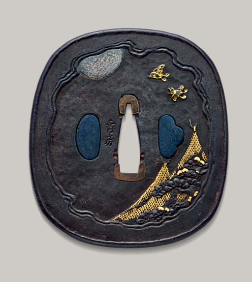

Bernard Posted November 17, 2013 Author Report Posted November 17, 2013 Thank you very much, Pete. I found one example on Christie's site.http://www.christies.com/lotfinder/lot/ ... 70316&sid= Bernard D Quote
Pete Klein Posted November 17, 2013 Report Posted November 17, 2013 This is from the link you provided. It is papered Tokubetsuhozon and the mei looks like the one in the meikan. Quote
