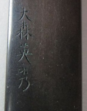

Bernard Posted November 13, 2013 Report Posted November 13, 2013 Hello everybody, "As always with this smith, gimei is assumed". What do you think of this kozuka (9.7 cm long)? Regards. Bernard D Quote
docliss Posted November 13, 2013 Report Posted November 13, 2013 While full of admiration for Bernard’s Omori-nami kozuka, with its sukisage-bori waves and the differing sizes of gold inlay droplets, I feel that it does not meet with the remarkable standards of Omori Teruhide’s work. In particular, I find the recurring, similarly sized ‘globules’ at the termination of the waves to be monotonous and unpleasing. Neither am I happy about the mei, which is too rigid and stylised in its execution. I will bow to the opinions of those more knowledgeable than I, but sadly believe this kozuka to be gimei. John L. Quote
raven2 Posted November 13, 2013 Report Posted November 13, 2013 I would also agree with a gimei. The piece feels heavy to me whereas the true Teruhide has more flow and lightness to the waves and they are not as repetitive. Quote
ROKUJURO Posted November 13, 2013 Report Posted November 13, 2013 ...... Neither am I happy about the mei - which is too rigid and stylised in it's execution - nor the kao, which is not correct..... John, is there a photo I cannot see? Which KAO? Quote
docliss Posted November 13, 2013 Report Posted November 13, 2013 Sorry - a stupid error on my part; I have corrected this. John L. Quote
nagamaki - Franco Posted November 13, 2013 Report Posted November 13, 2013 While full of admiration for Bernard’s Omori-nami kozuka, with its sukisage-bori waves and the differing sizes of gold inlay droplets, I feel that it does not meet with the remarkable standards of Omori Teruhide’s work. In particular, I find the recurring, similarly sized ‘globules’ at the termination of the waves to be monotonous and unpleasing. Neither am I happy about the mei, which is too rigid and stylised in its execution. I will bow to the opinions of those more knowledgeable than I, but sadly believe this kozuka to be gimei. John L. Thank you John for saving me from having to repeat your words. Quote
Bernard Posted November 14, 2013 Author Report Posted November 14, 2013 Dear all, Many thanks for your replies. As nobody disagreed with John's post, I presume that it reflects the general opinion of the members' Forum. When I look at the MFA's brass kozuka, I think that I understand what you mean. As far as craftmanship is concerned, if I compare my kozuka to other "Omori vagues" in the same material, I don't think it is on the bad side. So, il looks like a fine quality item (you can feel the quality when you see it in person), but lacks of the aesthetic appeal typical of The Master himself. It seems to me that John expressed that well in his reply. Thanks again and best greetings from Switzerland. Bernard D Quote

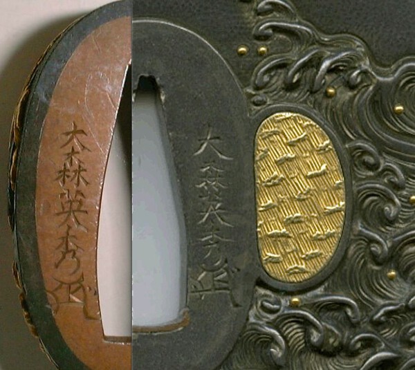

Pete Klein Posted November 14, 2013 Report Posted November 14, 2013 These are from Wakayama TKMT, pg. 34 for comparison: Quote

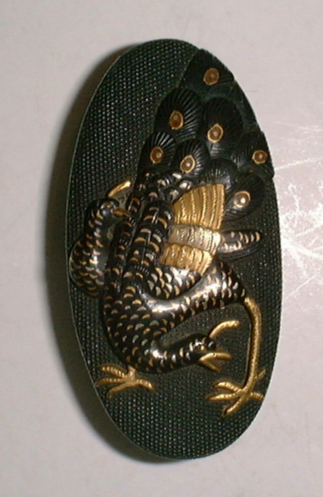

docliss Posted November 14, 2013 Report Posted November 14, 2013 Some images of a pair of fuchi-gashira that I believe I have not posted before. John L Quote

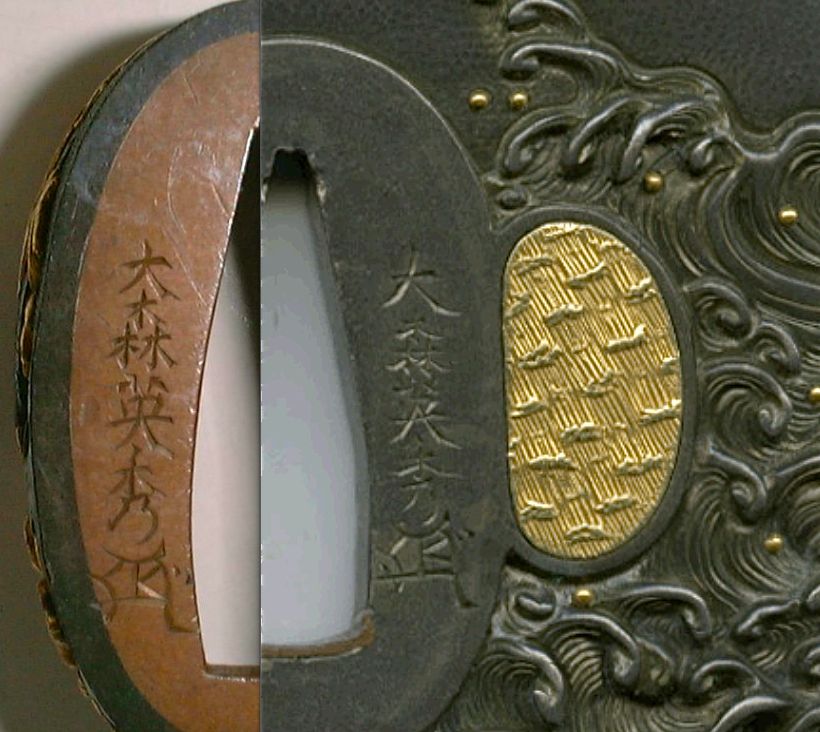

Eric H Posted November 15, 2013 Report Posted November 15, 2013 another comparison Tsuba Omori Teruhide http://www.nihonto.com/5.10.12.html Eric Quote
nagamaki - Franco Posted November 15, 2013 Report Posted November 15, 2013 http://www.nihonto.com/5.10.12.html Quote
