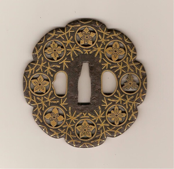

Brian Posted January 16, 2014 Report Posted January 16, 2014 Nice one Ford! For those of us not familiar with it, can you briefly describe the manufacturing process? The overlapping borders do make it look less like inlay and more like a "painted on finish" :lol: Would be great to get a little insider insight. Brian Quote
Ford Hallam Posted January 16, 2014 Report Posted January 16, 2014 Brian the 'mon' (not really mon at all) are riveted into a circular hole in the steel as discs of shinchu. A circular hole is cut in the steel plate and give a slightly flared outer edge on each side to allow the shinchu to lock in place when riveted in situ. Thereafter the piercing work is carried out. The rest of the decoration is regular inlay. The final detailing would be the outlining of the inlay work with an engraved/chiselled line. These are not the epitome of skilled work so overlaps and irregularities are par for the course. The idea that paint or lacquer might simulate this effect is simply ludicrous and can only come from the imagination of someone with zero practical experience of both the original objects and paint or lacquer. There's no mercury gilding involved where brass type alloys are involved. Quote
Pete Klein Posted January 16, 2014 Report Posted January 16, 2014 Thanks much Ford. I realize now what I got backwards. I thought that perhaps the shinchu was gilt and wear had caused the darker areas of the inlay. What I see now is just the reverse (if I am correct). The darker areas of the inlay are oxidized/patina and the lighter majority of the surfaces are the shinchu. This is what happens when one stares at too many teeth...LOL! Thanks so much! Pete Quote

Pete Klein Posted January 16, 2014 Report Posted January 16, 2014 Ford -- over the years I have read that Onin tsuba inlay were cast. Have you seen any evidence to substantiate this or do you feel it was the same inlay as with Heianjo? PS: I am not referring to the ten-zogan but the other, flat inlay (hira zogan)? Sorry, the terminology sometimes escapes me. Quote
Ford Hallam Posted January 17, 2014 Report Posted January 17, 2014 Pete, the idea that brass pieces were pre-cast for inlay or cast in situ is not, in my opinion, at all practical nor really feasible. Neither can I see any need for the pieces to be thus produced. Even today I'd personally find it more bother to precast pieces were I to replicate a Heianjo tsuba. I did write a fairly extensive explanation of why I reject the notion, I'm sure it can be found, it's on this forum somewhere :-) The whole issue with casting and tosogu, whether it be steel tsuba or soft metal fitting, menuki and the like, is that it wasn't at all as simple as people like to imagine. Today, with our vastly improved refractory materials and sophisticated kilns etc. fine casting is within the reach of almost any small studio. Prior the the second world war, though, it was a time consuming and expensive procedure. More so in old Japan. Today we refer to casting as an easy and cheap manufacturing process that allows for mass production and is relatively unskilled. The process is synonymous with cheap knock offs. Even 200 years ago it was a very complicated and time consuming procedure though. And whereas we have extensive documentation of casting procedures in Japan that document the level of the technology in both cast iron and bronze there's no evidence of small scale casting in either material nor can one imagine the technology making it feasible. Prof William Gowland's papers on the subject are about as comprehensive as one could hope for. He was employed by the Meiji Govt. to oversee the mint, among other metallurgical matters. Quote
Pete Klein Posted January 17, 2014 Report Posted January 17, 2014 Ford -- thanks as always. As you are aware dentists are quite involved around the casting of metals and it is part of our training, although generally not our everyday work. I remember in school how easy it was to get voids in a lost wax casting even with a sling centrifugal casting device. I can just imagine how difficult it would have been back then. I have always had my doubts about that Onin theory so thanks for the information. BTW - Gowland's book is quite interesting and I look to it from time to time. (I love those old books)! Take care, Pete PS: I just read that quote by Plank and it's hysterically true! LOL Quote
