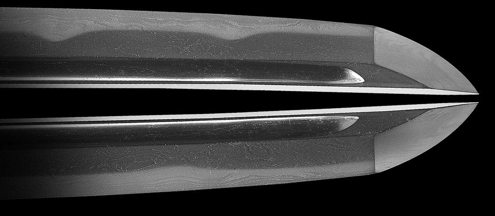

Marius Posted November 6, 2013 Report Posted November 6, 2013 For all those last participants: I respectfully disagree with Hoanh's statement that the hamon is nioi-deki. Please take some time to look at the third picture (_MG_0723.JPG) - I see nie crystals and I would tend to say that on the whole, the hamon is of a nie structure. My original bid stands (and is based mostly on the sugata), but I would not rule out dropping the "ko" prefix because of what appears as a coarse hada with a mix of masame and mokume. On the other hand, the sugata has a Nambokucho flavour, and those spots of mokume (o-hada) might be the result of the sword being tired (after all kasane is only 0.53 cm - no offence meant, Hoanh, I also have tired swords). Just my two cents at the end of this game. Quote

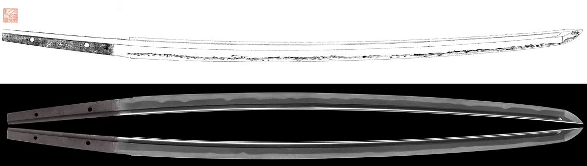

hxv Posted November 6, 2013 Author Report Posted November 6, 2013 Hi Mariusz and All, I would like to thank all who have contributed to this thread. It was very educational for me. Marius: No offense is taken at all! My objective in this kantei game is to learn what others think and how they arrive at their conclusions, and as such, all comments are appreciated. First, on your comment that the hamon is nie deki. I would probably go along with ko-nie deki, as the nie particles are very, very fine. Second, on the o-mokume hada, I believe that's the hada the sword was forged with, as this hada is prominent throughout the length of the sword on both sides. The motokasane is still a healthy 7.5mm, although the motokasane is only 5.3mm as you noted. Regarding the kantei guesses posted, we have: Ko Uda, Etchu Tametsugu (Ko Uda), Uda, Shitahara, Mino Senjuin, and Hoju. It seems to me that the commonality between these attributions is the Soshu-like flavors, specifically in relation to Norishige (Ko Uda, Etchu Tametsugu). In particular, the matsukawa hada stands out. I did not use the term "matsukawa hada" in the description since I did not want to influence/bias people's thinking in anyway. Prior to polishing the sword, Bob Benson thought Ko Uda, Sanekage or Tametsugu. After polishing, he thought Ko Hoki. Again, I can see the commonality in Bob's attributions as the Soshu-like flavors. In any event, the sword clearly exhibits some Soshu-like flavors. As for the NBTHK attribution, "Kodai Hoju." So, a big cheer for Veli and Mariusz (he did give Hoju as his second choice). I found on the web a couple of swords attributed to Hoju, and would be interested in your thoughts. http://www.nihontocraft.com/Hoju_Nagina ... atana.html http://www.nihontoantiques.com/fss551.htm Regards, Hoanh Quote

Veli Posted November 6, 2013 Report Posted November 6, 2013 One more example: http://sanmei.com/contents/media/O111235_S1300_PUP_E.html Hoanh, this blade has some strong and distinct features, a very nice addition to your collection! Thanks for the exercise! BR, Veli Quote
hxv Posted November 6, 2013 Author Report Posted November 6, 2013 Thank you for the additional example, Veli. The sword from sanmei has a much closer resemblance (hada, hamon, and boshi) to my sword than the two examples I found. Regards, Hoanh Quote
runagmc Posted November 6, 2013 Report Posted November 6, 2013 Hi Hoahn, Thanks for posting your sword... these always teach me something, even if they are just pictures and descriptions Also, here is an example I found of Sanekage to support why he was my guess. What do you think? One thing I meant to ask before, is the soe-hi visible on the other side of the nakago as well? Quote
hxv Posted November 6, 2013 Author Report Posted November 6, 2013 Hi Adam, Yes, the soe hi is visible on both sides of the nakago. There are a lot of similarities between the Sanekage you posted and my sword. In fact, this had been one of Benson's initial guesses. It was a very good attribution on your part. I suppose the trouble with mumei swords is that there can be more than one plausible attribution. I think one can make an equally strong case (compared to Hoju) for Tametsugu, Sanekage, Ko Uda in general, or even Ko Hoki, as all of my reading of these schools/smiths point to Soshu-like characteristics of their works. In fact, I remember reading the theory that Norishige and Masamune tried to emulate Ko Hoki works in their creation of the Soshu tradition. I can try to dig up the reference if you are interested. In any event, it is a nice sword that I am glad to have restored. It's quite a pleasure to hold and study and admire in general. The elegant and graceful shape is quite pleasing as well. Regards, Hoanh Quote
