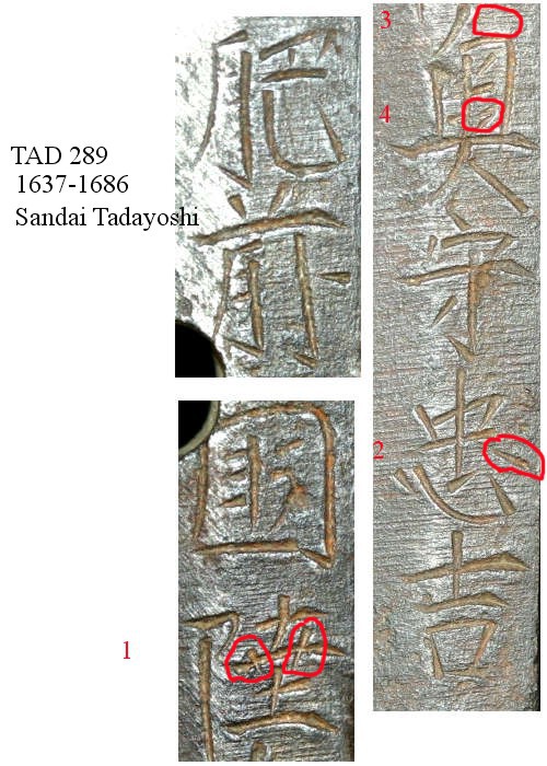

Ludolf Richter Posted June 19, 2007 Report Posted June 19, 2007 Hi James,I have checked lots of his Mei.My conclusion: 1.I believe the Mei was chiselled by the Sandai:get the sword papered 2.Your sword was made in 1661 or 1662 (Kanbun 1,when he got his Kami-title, or 2).In Kanbun 3 (or probably in Kanbun 2) he changed the following strokes (the pic is showing your Mei!): (1) Up till than the 2 vertical strokes of the 1st Mutsu-Kanji had been cutting through the horizontal line,later they were put below the horizontal line. (2)The stoke on the right side below of "Tada" was cut downwards like with your Mei.From Kanbun 3 this stoke was horizontal or even slightely upwards. (3)On top of the 2nd part of "Mutsu" he added a small horizontal stroke. (4)For that stroke I couldn't find any example:a faker would't have made such a stroke. From your pics I couldn't detect the following feature,which is typical for him (may be not yet when he made your sword at an age of 24 or 25!):his Ashi are long and thick Choji-Ashi,which look like the teeth of comb,called Kushi no ha Choji. Congratulations!Ludolf Quote

Darcy Posted July 2, 2007 Report Posted July 2, 2007 That is a great signature analysis from Ludolf. Hard to contribute more than that. My own comments would be that the sword seems very well made, the jihada is beautiful and the hamon seems elegant. The jihada looks like it is somewhat non-standard for the smith as you'd be expecting more of a konuka Yamashiro-like looking jigane without such prominent chikei. But if Ludolf is right and this is very young work for the smith it would be more likely that it is made before he finalizes his typical style. The most important thing is that the sword be well-made in accordance with the standing of the smith, when you are looking at it, in that way it should confirm the signature. A big signature on a poorly made sword is less likely to be correct. Please keep us posted, I agree that the item should be submitted to shinsa. You could start with the online version of the NTHK shinsa, but I would be wanting to send the sword to Japan. Rich Turner who offered help will know everything needed for your case. Quote

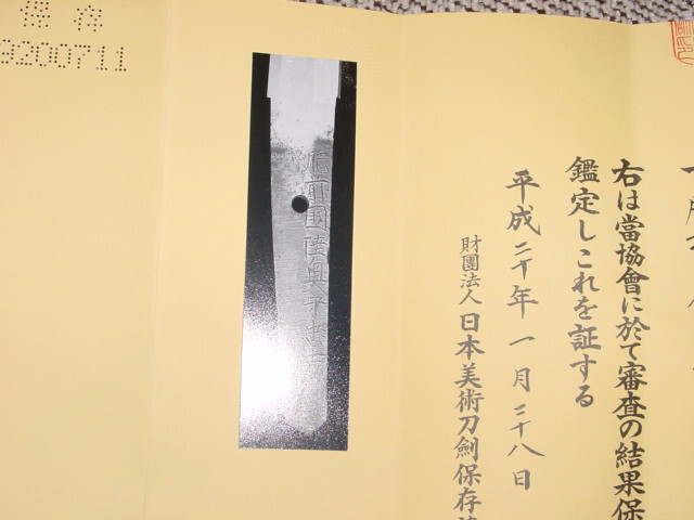

James Posted March 7, 2008 Author Report Posted March 7, 2008 Good news - Colin has emailed me today letting me know that this wakizashi has passed the NBTHK Shinsa. This news has made my day. Quote
Brian Posted March 7, 2008 Report Posted March 7, 2008 Congrats James! That is an excellent result, and certainly shows that if the right steps are followed, there can be a good result at the end. Make sure you send some pics when it eventually arrives back. Congratulations too go out to Ludolf for a very good call and analysis. Well done. Brian Quote
