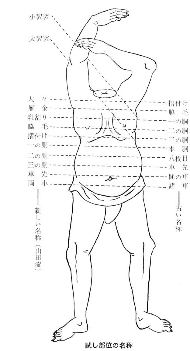

Ken-Hawaii Posted October 5, 2013 Author Report Posted October 5, 2013 I have the two-volume set of Kubikiri Asaemon Token Oshigata in which are shown many ways to test swords on criminals. I'm not sure when these were originally printed, but just from the photos I can tell that there was a specific testing regimen, depending on how much resistance was wanted in the tameshigiri target. If someone knows more about the era, we could probably figure out what was tested. Here is one diagram: Ken Quote
george trotter Posted October 5, 2013 Report Posted October 5, 2013 Ken san, doesn't it always come back to how reliable the test and or test document was? In those times, as today, there were strong considerations on who commissioned the test, who did the test, how much money/reputation/social connection rested on the outcome? Are these origami and various nakago inscriptions believable? just askin' Quote
Ken-Hawaii Posted October 5, 2013 Author Report Posted October 5, 2013 Good point, George. I don't have any information on who commissioned these two volumes, or when, but I do have to think that there was a considerable cost to put them together. How likely is it that someone was willing to pay out however many ryo to create these 100+ diagrams & even more oshigata just for money/reputation/social connection? I'm sure there are other members who can comment on this far better than I, though. Oh, & don't forget that I can't read the Kanji, either. :D I just found some info that might shed some light: Quote This tameshigiri has been done by The Yamadas, usually called Kubikiri Asaemon, from generation to generation. This book contains interesting or valuable documents selected carefully from among a lot of ones (entitled "Token Oshigata") owned by Yamada Family. It includes approx 460 plates in it. Ken Quote
