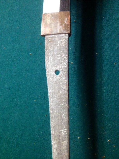

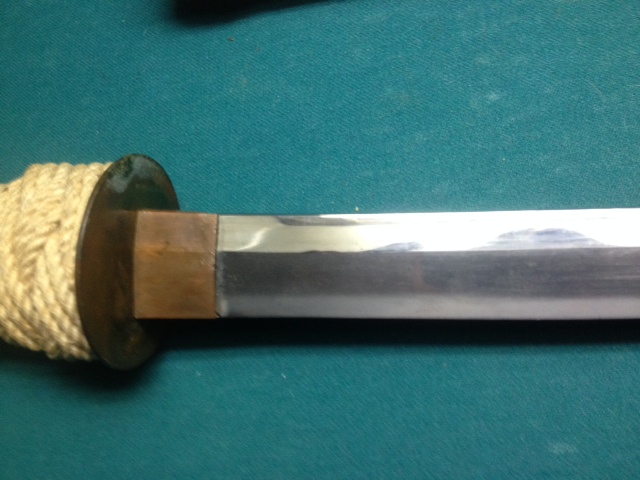

I got these pictures send to me by a local person who wishes to sell me his father's bringback sword. From what I can tell the sword looks to be in great shape and Yasutoku is to my understanding a decent smith working out of Yasukuni. How is it then that the nakago is so.....unevenly shaped? Could this be a Gimei?
After some more research, is this nakago what they would call Kijimomo-gata? Sry, I'm just used to seeing almost all Ubu shaped nakago from lack of experience
Hi buddy,
there were to smiths working at the "nihonto tanren kai" that went by the smith name of YASUNORI, the first one , Kajiyama Yasunori and Katoni Yasunori.
the first, Kajiyama yasunori who became a member during 1933 actually was the teacher to Katoni yasunori who who was awarded the same name during 1935, once this occured kajiyama yasunori changed the shape of his nakago to prevent the two from being confused from that point onward.
its abit hard to judge, because of the amonut of chalk on the nakago, and there being no pics of the whole blade but the mei looks very close the kajiyama yasunori's mei and shape of nakago is correct too. try to read the date to see what is says
regards Hamish
Showa year 12 , april lucky day, it does help being able to read Chinese :D
Thank you very much gents, that puts my mind at ease, I would appreciate it if you can give me more relevant information on this smith or the blade itself
