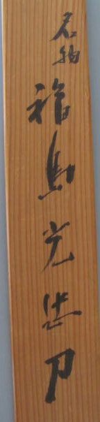

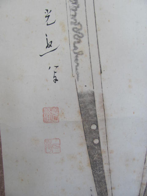

Grey Doffin Posted September 24, 2013 Report Posted September 24, 2013 Hi guys, I picked up a full length oshigata mounted on a scroll and with a box with hako-gaki, and this might be for sale someday. I'd appreciate some help with the writing, both Romanji and translation where appropriate. I think the date is 5th month of some year in Meiji; correct me if wrong. If someone can recognize the seals that would be wonderful too. I'm also puzzled by this. It appears to be Bizen-To and Mitsutada is a big Bizen name, but he wouldn't have signed katana mei. I sure think it says Mitsutada but I could be wrong. If not the Bizen Mitsutada do any of you know who this is? As always, I'm grateful for any assistance. Thank you, Grey Quote

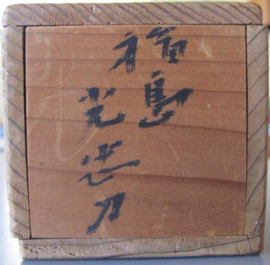

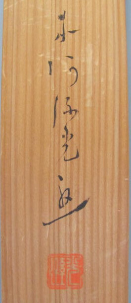

Grey Doffin Posted September 24, 2013 Author Report Posted September 24, 2013 And the box. Grey Quote

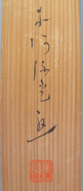

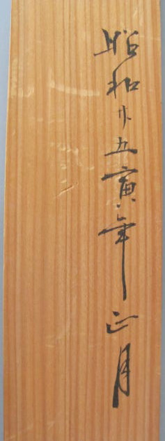

cabowen Posted September 24, 2013 Report Posted September 24, 2013 Fukushima Mitsutada. The date is Showa 25 I think... Quote

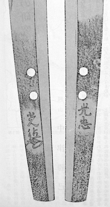

k morita Posted September 24, 2013 Report Posted September 24, 2013 Hi, This is a Meibutsu sword "Fukushima Mitsutada" scroll oshigata by Honami Koson as Chris said. The signature on the #4 pic is gold inlay of Honami Kotoku and kao. And another side of the tang has "Mitsutada" gold inlay by Honami Kotoku. Quote
k morita Posted September 25, 2013 Report Posted September 25, 2013 Following tang oshigata of Fukushima Mitsutada is from a monthly journal [Token Bijutsu]. Quote
