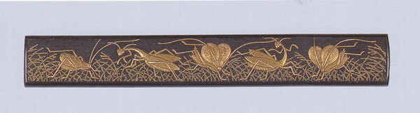

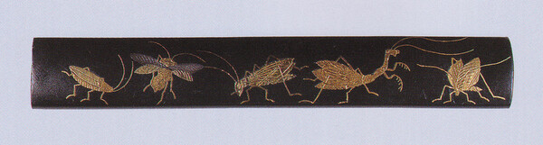

And for reference here are some Kaga examples from the Ishikawa Prefectural Museum. Ishikawa used to be called Kaga.
These are obviously much finer but the style of the insects is very similar and I know Ken loves his mantises :D and one of the kozuka shows nanako over inlaid grasses albeit in shakudo.
