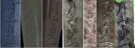

DirkO Posted August 23, 2013 Report Posted August 23, 2013 Hi Gabriel, Here's a little line up - all the reference examples are papered and from 1911->1914 (so roughly the same era). Please look closely and you'll find a lot of differences in the strokes. The yasurime also don't look fine enough and quite superficial. Quote
Gabriel L Posted August 23, 2013 Author Report Posted August 23, 2013 Dirk, Now that's more like it, a bit of healthy skepticism. Nicely done. :D Like I said, that "Sada" character is way too out there for my taste (even more alien than this Sadakatsu example). The first character of Gassan is perhaps a little wide as well. EDIT: and now I see what you mean about the yasurime as well, there is a difference. I did not catch that at first. Must always look closer! If it is gimei, though, then it was obviously done by someone working from example. It always astonishes me that there would be so many unscrupulous smiths throughout history, to forge so many gimei. Still like to hear opinions. Ultimately shinsa would have to be the judge, but I'm not convinced either way yet. Quote
J Reid Posted August 23, 2013 Report Posted August 23, 2013 All the examples, including the suspect mei, dirk has so kindly provided show a few consistencies with specific turns, angles, and visible depth on strokes. Overall though- no example is identical. So inconsistencies shouldn't deter what our (or at least my) gut screams .. Shoshin.. Quote
Gabriel L Posted August 23, 2013 Author Report Posted August 23, 2013 J Reid said: Overall though- no example is identical. So inconsistencies shouldn't deter what our (or at least my) gut screams .. Shoshin.. My gut screams "maybe." Small inconsistencies are not a death knell. But when dealing with the most famous (and most copied), you have to be the most critical. Personally the difference in yasurime is almost more telling than the difference in mei. Mei are "organically" carved in a handwriting style, they are sometimes different. But it is suspect when a completely different file was used on the nakago for just this one sword... Quote

J Reid Posted August 23, 2013 Report Posted August 23, 2013 I'm pretty sure that's just the picture/lighting making the yasurimei look softer. If you look closer to the nakago jiri the file marks look sharper again, IMO. I can agree with being cautious.. I guess I'm just sold on this one. Haha Quote
Jean Posted August 23, 2013 Report Posted August 23, 2013 Thanks Gabriel to have noticed my Soshin Gimei you may have noticed that as refinement I have written Soshin and not Shoshin. In fact all depends of the selling price. A tip: if you are interested in a sword and don't know if the mei is Sho Shin, send a picture of it to NTHK, Gordon Robson. You will have a first opinion. Quote
Gabriel L Posted August 23, 2013 Author Report Posted August 23, 2013 J Reid said: I'm pretty sure that's just the picture/lighting making the yasurimei look softer. If you look closer to the nakago jiri the file marks look sharper again, IMO. I can agree with being cautious.. I guess I'm just sold on this one. Haha I considered the possibility that it was a photographic issue, but the full resolution images from two angles and lighting conditions seem pretty clear: http://i.imgur.com/21JX0.jpg http://i.imgur.com/nawVK.jpg Again though... I do not know. Jean said: Thanks Gabriel to have noticed my Soshin Gimei :D you may have noticed that as refinement I have written Soshin and not Shoshin. Oops! That's my cue to take a break and come back to this thread with fresh eyes. Thanks for the tip re: Mr. Robson, —G. Quote

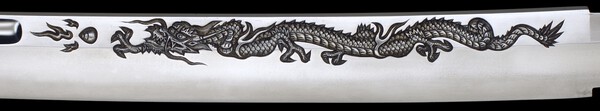

runagmc Posted August 23, 2013 Report Posted August 23, 2013 Is the sword shobu-zukuri on the omote, and unokubi-zukuri on the ura? If so, that's a combo I don't remember seeing before... I have pics of a NBTHK papered Sadakazu from 1910 with the same dragon horimono. They are very similar, But I can see a few differences as well, so Quote

Gabriel L Posted August 23, 2013 Author Report Posted August 23, 2013 runagmc said: Is the sword shobu-zukuri on the omote, and unokubi-zukuri on the ura? If so, that's a combo I don't remember seeing before... EDIT: OOPS! Yes, you are right and I feel stupid for saying otherwise. Not sure where I was looking. Quote I have pics of a NBTHK papered Sadakazu from 1910 with the same dragon horimono. They are very similar, But I can see a few differences as well, so Many thanks. Here is a direct comparison with some minor photo tweaking to make the comparison as "fair" as possible. I know the photos are not equal and the sword in question is covered in grease and not lit as nicely or angled perfectly... but the bottom horimono still looks a cut above. Yet the horimono on top is nothing to sneeze at, in my opinion. And the workmanship is certainly similar if not identical. And if it's gimei, it would be a surprisingly good horimono... if you can work at that level, why not just make a name for yourself? Sooooo...... I still don't know. EDIT: missed another shot of the nakago! Gives slightly better detail I think: http://i.imgur.com/J4EGk.jpg Quote
Gabriel L Posted August 23, 2013 Author Report Posted August 23, 2013 Two more examples for your consideration. First, this sword has 1959 NBTHK Kicho papers and is also dated 1914. With the exception of that "Sada" character, it looks pretty dang close to me... and the yasurime appear just as coarse! Second, this undated ("early Meiji") tanto has a pretty wonky signature (note the similarity of the Sada character) compared to everything else we've seen, yet has NBTHK Hozon & Tokubetsu Kicho papers: :? Honestly the last one I am surprised papered with such a different mei. Did they get it wrong, or did his mei really change that much? I cannot say. [EDIT] But my own opinion regarding the authenticity of the Reddit sword, after swinging towards gimei, is swinging back to possibly shoshin. Quote

cabowen Posted August 23, 2013 Report Posted August 23, 2013 Due to the tremendous number of fake Sadakazu blades, I usually assume fake until proven differently, even if the signature is very close. Without seeing the workmanship in the blade, I would not be able to confirm much of anything. The horimono is quite good but not quite equal to the confirmed comparison. Many of the later Sadakazu works were actually done by Sadakatsu, which further complicated things. Best thing to do when they are close is to get the blade to a competent shinsa panel. Quote

w.y.chan Posted August 25, 2013 Report Posted August 25, 2013 The yasurimei looks weaker and the mei is a little loose. I'm more incline to believe it is a fake. It is certainly done in the fashion of Sadakatsu. The horimono is well done. If it turns out to be a fake, is it a recent or old fake? I suppose there is a possibility of it being a postwar replica swords by smiths for GI souvenir? Quote

Eric H Posted August 27, 2013 Report Posted August 27, 2013 same year : Taisho 3 (1914) ...to compare "sada" Eric gassan teiichi.pdfFetching info... Quote
Gabriel L Posted August 27, 2013 Author Report Posted August 27, 2013 Eric H said: same year : Taisho 3 (1914) ...to compare "sada" Eric Thanks Eric. Another point in support of this sword. We can only hope that the owner one day receives my message and gets us good photos / sends it to shinsa. In the meantime I feel like a politician with how much flip-flopping I am going through. Chris's advice seems the best, assume gimei on principle and then shoshin is a pleasant surprise. Quote
