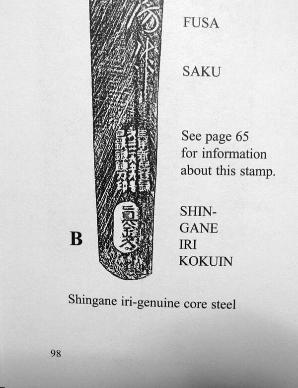

Markus Posted July 26, 2013 Report Posted July 26, 2013 I tend to think that Enshin emphasized with the last part that he added a softer core, i.e. "shingane-iri kore o kitau" (真金入鍛之). Usually shingane is written with the characters (心鉄) but also (真金) is possible I guess. Quote
Nobody Posted July 26, 2013 Report Posted July 26, 2013 Before I posted the previous response, I found the following example, which means “iron”. Ref. 真金 (magane/makane) http://dictionary.goo.ne.jp/leaf/jn2/207252/m0u/ I think that shigane theory is also possible. Quote
k morita Posted July 26, 2013 Report Posted July 26, 2013 In this case ,真 金(shin-gane) means core steel,not iron. See Slough's book on page 98. Quote

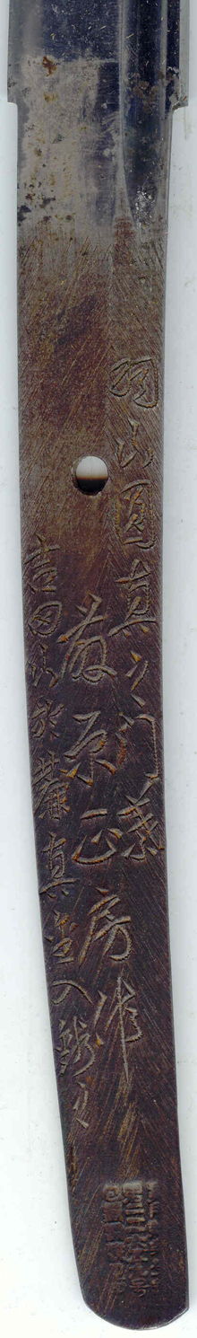

John A Stuart Posted July 26, 2013 Report Posted July 26, 2013 I have a sword with this inscription on it. Could it not be used in this sense? John Quote
k morita Posted July 26, 2013 Report Posted July 26, 2013 Hi, John san, Your sword inscription is old owner's inscription(kiritsuke-mei). 吉備 (Kibi) is a family name. 真金 (Sane-kane) is 1st name, not "shin-gane". 為 (to-nasu)--- for. 佩 (hai)--- wearing(the sword) . Meaning is "Wearing this sword for Kibi Sanekane". Quote
John A Stuart Posted July 26, 2013 Report Posted July 26, 2013 Thank you, I had this wrong. Originally was thought to have meant made of Kibi iron. John Quote
John A Stuart Posted July 26, 2013 Report Posted July 26, 2013 Morita san, could 真金 be Masakane as more likely a name? John Quote
