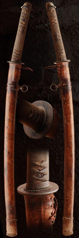

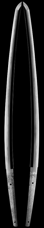

Daniel Posted July 23, 2013 Report Posted July 23, 2013 I have just bought this star stamped gendaito signed Akitaka from nihontoantiques.com. I have tried to find out some info regarding the smith. There were a couple of smiths with the art name Akitaka during the war but the closest match I could find was Akitaka from Niigata, real name Nakamura Fukutaro, made 33 swords for the army during the war years. Do you think this is the one and does anyone have some additional info of him? The sword is in Type 3 mounts with a leather combat cover and a clasping hands sarute both I think are quite unusual for a Type 3 Gunto koshirae. The sword itself has a nice itame hada and a beautiful gunome hamon and in my opinion a very graceful sugata. The swords in type 3 mounts are in my experience often very beefy and stout while this one is very elegantly shaped. Width at the ha-machi 30.5mm, width at the yokote 20.8mm, thickness at the mune-machi 8.3mm. Nagasa is 24 1/2" It is also dated one lucky day in January 1943. Thank you in advance Kind Regards Daniel Quote
Daniel Posted July 23, 2013 Author Report Posted July 23, 2013 Doh! Not easy to see the mei in those pics. Here is the link to nihontoantiques.com http://www.nihontoantiques.com/fss533.htm click on full images and hopefully you will be able to see the mei Apologies Daniel Quote

Daniel Posted July 28, 2013 Author Report Posted July 28, 2013 Hi Life's great vacation and swords to study. This evening after I put my son to bed I took the time to really study the sword. With my other Gendaito the famous Kiyokatsu and some more I'm beginning to learn to see and appreciate the Hamon with all the various Hataraki there is to see. Today for the first time in reality I discovered how nice and interesting it is to see and study Hada. Of course I've seen and enjoyed Hada in my other swords but in this Akitaka the Hada were really visible wet and glowing. So today is a good day, summer, vacation had a lunch out on a resaurant with my wife and my two and half y/o son who didn't completely trash the place and finally tonight with a small Lagavulin beside me and the sword I took another small step on the Nihonto learning curve. Best Regards Daniel Quote

george trotter Posted July 29, 2013 Report Posted July 29, 2013 Hi Daniel, Thanks for that nihontoclub link...that "made 33 swords" for the army is a strange piece of info. To my knowledge only the production totals of the Yasukuni smiths is published. Eithre this "33" is a misreading of the Japanese text that says he was an army smith aged 33 in Sho 18, or there is some valuable info out there I/we have not heard about before. Anyone know anything....? Also, I have only seen about 6 or 7 Type 3 in leather saya covers...quite rare. Regards Quote
