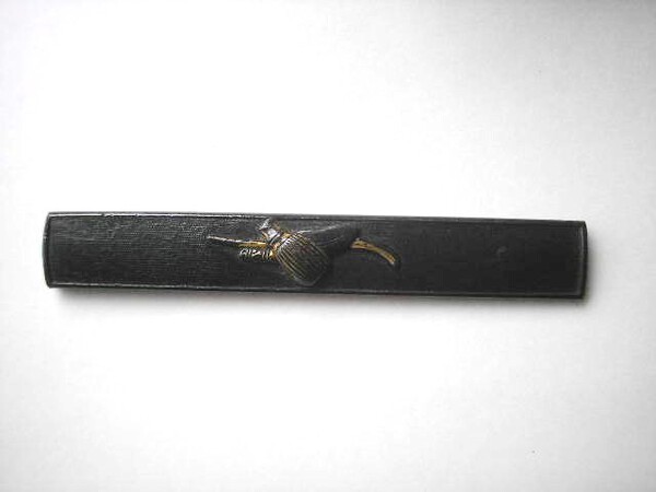

Pete Klein Posted July 13, 2013 Report Posted July 13, 2013 Here is an example from the most recent Yashima catalog. Note the dimensions and price. This one has TBHozon: Quote
Steve Waszak Posted July 13, 2013 Report Posted July 13, 2013 Some really fine posts in this thread. Thanks especially to Kunitaro, Pete, and Chris... Pete, any further info on that kozuka? Enjoying this thread. Thanks, Veli, for raising the question(s). Cheers, Steve Quote

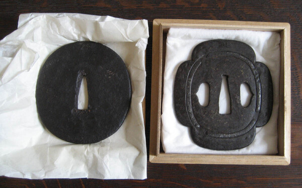

kunitaro Posted July 13, 2013 Report Posted July 13, 2013 ↑ Yashima Catalogue (They are one of the best Tosogu dealer in Japan.) Description 黒褐色の錆色 Brownish black patina 潤い Uruoi (moisture) ネットリ Nettori (smooth/stickish?) 変化のある肉置き Divers Niku-oki Typical ko-Tosho tsuba. However, It is impossible to recognize those description by the photo, To recognize or understand what the meant. You need to have it in your hand to see, touch, and smell, taste etc.. And You need other example to compare... It has Tokubetsu-hozon paper : Mumei Mumon(no design) Ko-Tosho tsuba. so, the quality is kind of guaranteed, people can depend on judgement of NBTHK, and lean from it. If you have Juyo papered Tosho tsuba, you will be able to find same quality piece from Tokubetsuhozon or hozon tsuba, and make it to Juyo by yourself. even you have a chance to find one in the flea market. but, if you have never seen or understanding Juyo quality, you don't know what you are aiming at... you can not depend on someone's opinion..... Is it make sense ? Quote
Pete Klein Posted July 13, 2013 Report Posted July 13, 2013 Hai. I hope to meet Saito san in Japan at the DTI this October. I have heard many wonderful things about his knowledge and experience. Steven -- just an appropriate item for the conversation I felt. Most likely Momoyama jidai Chadogu. The concept of wabicha encapsulated in kodogu. Quote

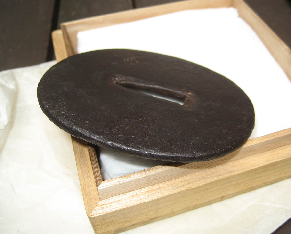

Pete Klein Posted July 14, 2013 Report Posted July 14, 2013 Here is a picture from the AOI site showing a side view. I don't see much of any decrease in thickness from the center to the edge: As for the price actually seems quite reasonable to me at least as there has been a decrease in prices over the last ten years in Ko Tosho and Ko Katchushi in general but then I have not shopped in Japan so I might be wrong in this having only online and Japanese store catalogs to go by. BTW -- Sasano's book was called 'Sukashi Tsuba' so I would imagine this wouldn't have exactly fit in. I pulled it out myself this morning and then thought, oh - yeah - DOH! LOL Quote
seattle1 Posted July 14, 2013 Report Posted July 14, 2013 Hello: With regard to Pete's post, no there is not a lot of decrease in thickness from the seppa-dai to the edge, but it does appear to decrease and the visual effect from light on such a surface, while subtle, is substantial. As for the reference to Sasano, it is the book Sasano (1993) and not one of the several books written by Sasano sensei. The point about ko-sukashi was to open the door to it possibly having come from a polearm. That is not a criticism of the piece, but a clue. Arnold F. Quote
kunitaro Posted July 14, 2013 Report Posted July 14, 2013 This is maybe better ??? Look at Thickness of Sukashi part. It is about "Niku-oki" Quote
