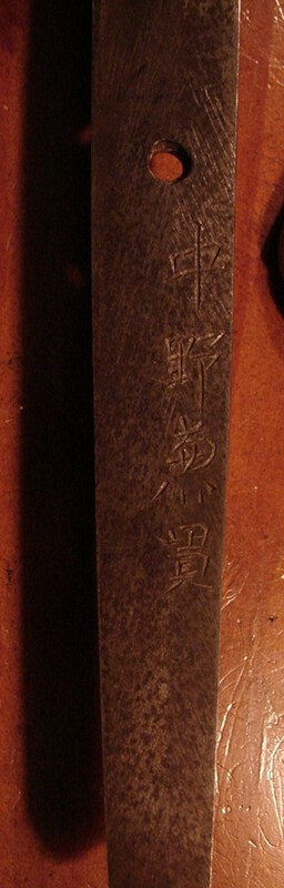

patrick7813 Posted July 7, 2013 Author Report Posted July 7, 2013 Here's the mei. I'm fairly confident it's Nakano Kanetsura. Quote
Lance Posted July 7, 2013 Report Posted July 7, 2013 Looks like Kanehiro, Showa period? if so hiatsura would be rare for his time period, I don't think I've ever come across one. Love to see photos of the blade if possible. Regards, Lance Quote

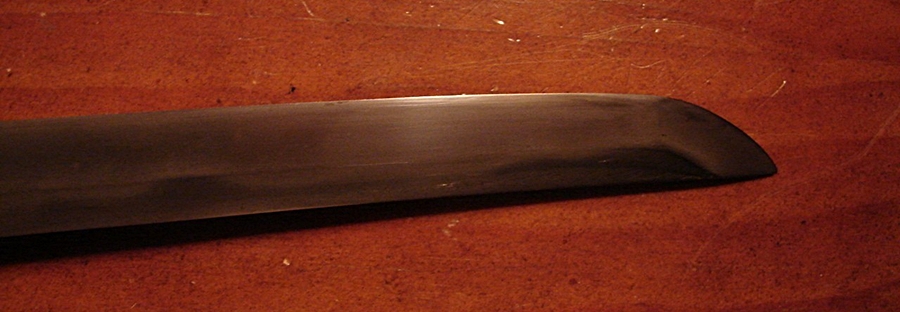

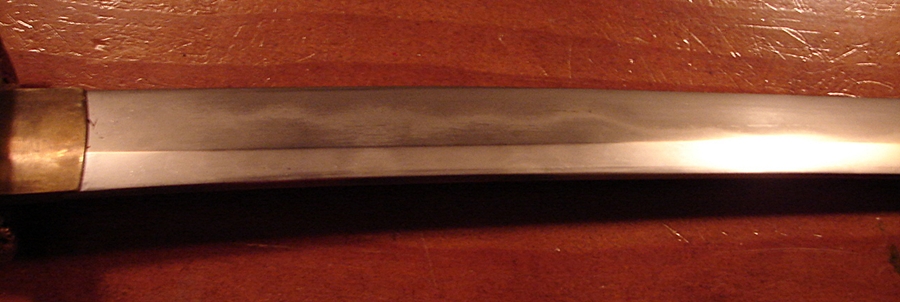

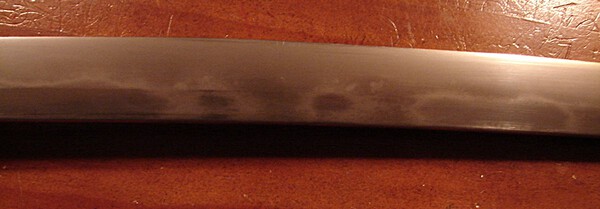

patrick7813 Posted July 7, 2013 Author Report Posted July 7, 2013 Here's the best blade pics I have and I don't have the sword "in hand" now. Quote
kunitaro Posted July 7, 2013 Report Posted July 7, 2013 兼貫 kanetsura 中野栄三 Nakano Eizo Hamon is very unique ! The shape of hamon looks like Shinto. still very high, over shinogi at monouchi ! Ichimai-boshi. Quote
patrick7813 Posted July 7, 2013 Author Report Posted July 7, 2013 Chris These pictures don’t do the blade justice. When held "in hand" there is activity in the hamon but no hada. I'm unsure about oil vs water quenched. Maybe folded, forged, water quenched from western steel (haven't ruled out oil quenched yet). I believe this is likely a Showa blade but the use of a hitatsura temper is a head scratcher. Cheers, Quote

Jacques Posted July 7, 2013 Report Posted July 7, 2013 HI, 兼貫 kanetsura 中野栄三 Nakano Eizo Showa guntô smith... Quote

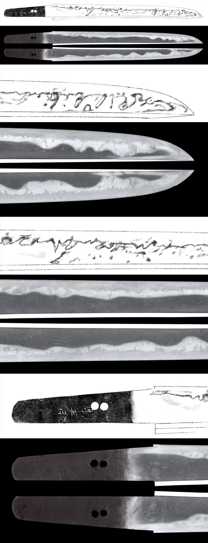

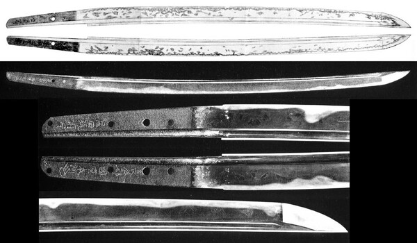

runagmc Posted July 7, 2013 Report Posted July 7, 2013 Hi Barry, yes, I have also seen a few Hasebe blades with lots of tobiyaki that could probably be considered hitatsura... I guess I should have said Hiromitsu and Akihiro were the first smiths to use this type of hamon regularly (as far as I know), and it has become sort of a trademark for them... BTW, I really like Hasebe work, and especially that of Kunishige, so you are a lucky man... Here is a good example of Hasebe Kunisige, which is a national treasure, with lots of tobiyaki Quote
kunitaro Posted July 7, 2013 Report Posted July 7, 2013 b.hennick said: @Adam L.I have a Hasebe Kunishige blade (ex Han Bing Siong) that is hitatsura that predates those smiths as Kunishige was a student of Masamune. MMM. I know the blade ! That is very beautiful master piece ! It is different from this Kanetsura katana, I don't know much about Gunto, I just thought the SHAPE of the hamon looks like Shinto, not Koto style. @Adam L. That is "Heshikiri Hasebe" Kokuho. Quote
Brian Posted July 8, 2013 Report Posted July 8, 2013 I expect that this "hitatsura" was a mistake, and a result of whatever clay or medium they used falling off during the firing, and not a deliberate attempt at hitatsura. Looks Showato to me. Just my opinion...I am open to correction. Brian Quote
cisco-san Posted July 8, 2013 Report Posted July 8, 2013 I guess Jacques and Kunitaro are talking about this smith: Kanetsura (兼貫), Shōwa (昭和, 1926-1989), Gifu – „Kanetsura“ (兼貫), civilian name „Nakano Eizō“ (中野栄三), born November 23rd 1922, he worked as guntō smith edit: Sorry just saw now that the blade is already in the "For Sale or Trade" section, and Typo! Quote

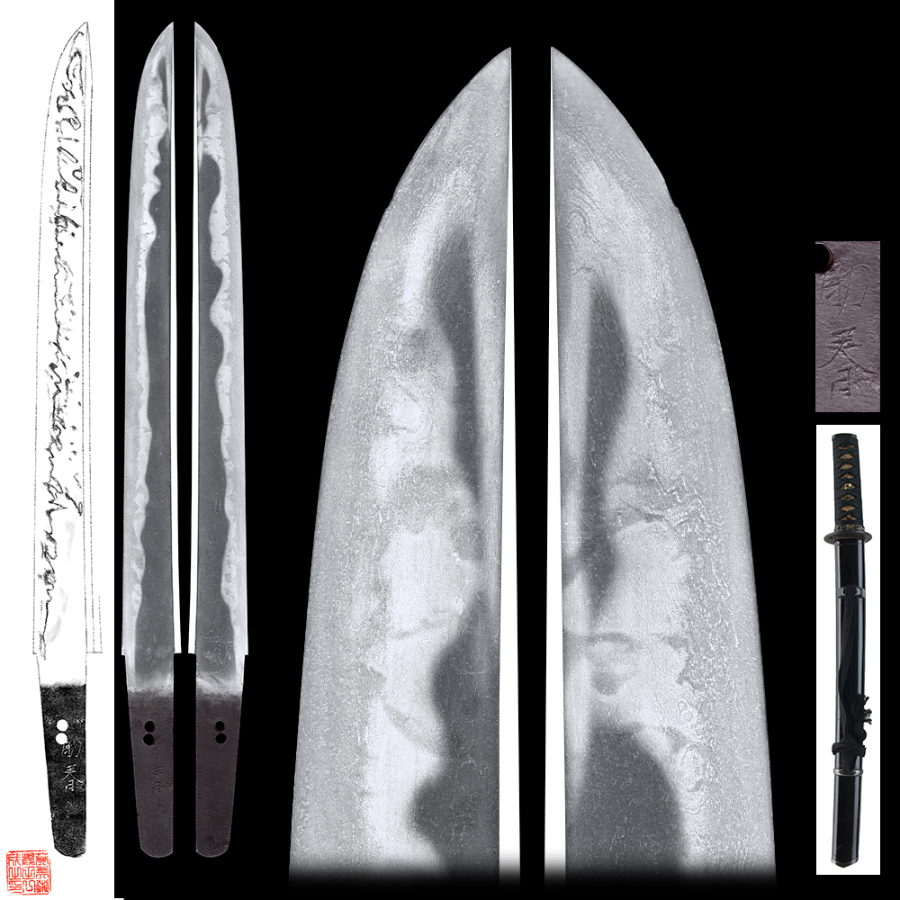

teddf98 Posted October 8, 2016 Report Posted October 8, 2016 I enjoyed this thread and know it's a few years old but I'll add some pictures of my blade with hitatsura Hamon. Sword smith whom isn't very popular but I could not pass up the beauty of this hamon. Mid edo period approx 1720's. Sword smith is Sukeharu. If anyone knows more about him or the time period in which he lived I'd love to know more. Thanks everyone. Hope you enjoy the pictures. Credit Aoijapan.com for purchase and photos Quote
cisco-san Posted October 10, 2016 Report Posted October 10, 2016 Hi, I am not sure, but I guess it is this smith - from Markus book: SUKEHARU (祐春), Enpō (延宝, 1673-1681), Settsu – “Mino no Kami Sukeharu” (美濃守祐春), “Settsu-jū Minamoto Sukeharu” (摂津住源祐春), real name Kora Kyūtayū (小寺久太夫), he also bore the name Komiya Kyūzaemon (小宮久左衛門), nephew of Hanabusa Sukekuni (花房祐国), midare, notare, chōji-midare in Bizen style, notare-midare 1 Quote
Jamie Posted October 10, 2016 Report Posted October 10, 2016 My favorite hamon style. They are almost all interesting to a degree but if you really like them study the early pieces Also. Hitatsura is an extension of yubashiri. The early pieces are remarkable and less forced than the later pieces. Enjoy your study. This is a nice blade. 1 Quote
george trotter Posted October 10, 2016 Report Posted October 10, 2016 Looking at the mei and the hamon characteristics I would agree with Chris B and those who named it to Nakata Eizo. This smith, using the name Kanetsura and worked as a gunto smith in Seki. He was made a Seki swordsmith on Showa 18 year /12 month / 30 day (Jinsoo Kim list). Hope this helps, 1 Quote
