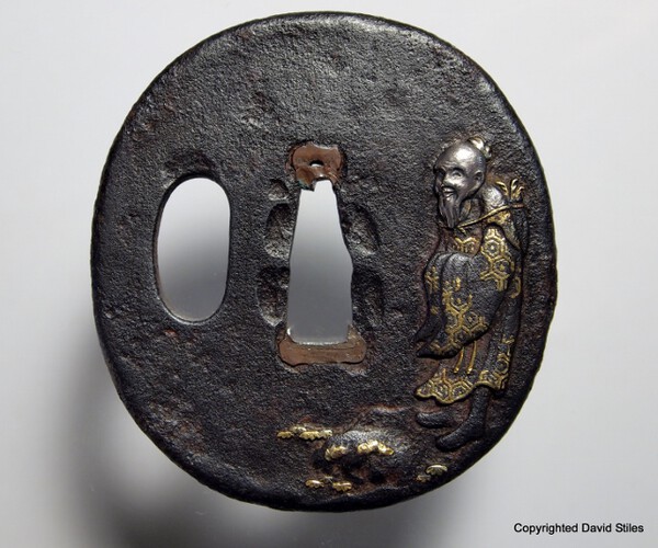

Soshin Posted July 4, 2013 Report Posted July 4, 2013 Hi Everyone, Here is a friend's tanto tsuba he wanted me to do high quality photographs of and post a topic about on NMB for feedback and information. He will also want me to provide a write-up about the tanto tsuba. The measurements of this small elongated shaped (naga-maru gata 永丸形) tsuba are 5.4 cm wide by 5.8 cm high. The thickness at the rim is 3.8 mm and approximately 3.0 mm at the seppa-dai and the rim displays a fine turn up. The man face and hair are done silver inlay and the patterns on the his robes and flowers along the streambank are done with gold inlays. To me the workmanship, techniques, and design are all characteristic of the Aizu Shoami school circa the late Edo Period. It is also of my opinion the quality and detail of the workmanship is very good. I am a bit surprised that it lacks a signature. In terms of subject of the design I not really sure. To me it looks like a old Chinese man collecting herbs near a streambank. Does anyone have a reference for this design and its meaning? My friend and fellow collector is interested in learning more details. Thank you for taking the time to answer my questions or post feedback about the tsuba. Quote
christianmalterre Posted July 4, 2013 Report Posted July 4, 2013 i am not at all into kinko David,-as you know... i but definitely do agree it´s certainly an very nice Tsuba! Yes Chinese cloth and style of "wear"... An wise man,confucian dress...confucian beard and hair knob.... Mid edo it seems me?(tagane could ben attributed even earlier indeed...!) Nice plate!-good taste! and good iron indeed look for Kaneie/(Kaneiye) influence.... Very nice-Very good! (sorry-can not help more-not mine home ) Christian Quote
christianmalterre Posted July 4, 2013 Report Posted July 4, 2013 edit: don´t let you confuse by these "enlongated" feet You have to see this Tsuba mounted/fitted on Koshirae! (small hint from mine part ) Excellent!Indeed....safe it!-LOL! Quote
Soshin Posted July 4, 2013 Author Report Posted July 4, 2013 Hi Christian M., Thanks for the replies. I started up my enigma machine and I have translated your comments to mean you like it. :lol: (This was only an attempt at a little bit of humor.) I have a little bit more experience with these type of kinko and the heavy hammer iron surface and the turned up rim make me think late Edo Period in my honest opinion. The Aizu Shoami would also often do this iron on iron high relief inlay technique as a base for their inlays of soft metals. The person on the tsuba could be the Chinese wiseman Laozi? Quote

Danocon Posted July 5, 2013 Report Posted July 5, 2013 Not sure if this straying from the purpose of this post but as always I am interested in the quality and character of the plate. My feeling is that the granulation and pits where inherent from the beginning-Albeit enhanced with age. Would this be a true statement? Really appealing tsuba David. Quote
Soshin Posted July 5, 2013 Author Report Posted July 5, 2013 Danocon said: Not sure if this straying from the purpose of this post but as always I am interested in the quality and character of the plate. My feeling is that the granulation and pits where inherent from the beginning-Albeit enhanced with age. Would this be a true statement? Hi Dan, No I don't think it is beyond the purpose of the topic to discuss the characteristics of the plate which is a significant part of the tsuba. The surface variation on this tsuba is the result of heavy hammering by the tsuba maker when he was forging the iron plate. This would have been done before any of the inlay work was done. While this is antique tsuba may be only around 150-200 years old the age would also enhance this original effect. Ford Hallan has been able to produce iron tsuba with a very nice simulated age effect through want I think is a patination process. There were also Edo Period tsuba makers that would apply a patina and other surface treatments with acid and heat to produce an aged worn effect. The Jingo school of Higo Province would often display a worn effect on its inlay work to make their tsuba look older. Hi Henry, Thanks for the reply. I have a large PDF copy of Henri L. Joly old book I will take a look at during my holiday. I been searching in The Art Appreciation of Japanese Sword Fittings by Shigeo Fukushi. I found a few fine Aizu Shoami tsuba with this type of silver inlay for the skin and hair of people as part of the design. One entry page 48 I think might explain the design and that is the Chinese teacher, editor, politician, and philosopher Confucius. In Japanese his name is Kōshi. Attached is a photo I did of the gate at a Confucian temple in Nagasaki, Japan. Some very beautiful architecture at the temple and museum. Quote
runagmc Posted July 6, 2013 Report Posted July 6, 2013 It seems unusual that the face is inlayed silver, but the feet aren't... the face almost looks out of place. It is a nice piece, though... Quote
Soshin Posted July 6, 2013 Author Report Posted July 6, 2013 Hi Adam L., I really like it and at the time in Kyoto silver was a very expensive soft metal. That feature I have seen in other high quality pieces attributed to the Aizu Shoami school of the mid to late Edo Period. The head and sometimes the hands would be inlaid in silver. I have never seen feet. Here is a good example of what I am talking about on the Japanese Blog 鐔鑑賞記 by Zenzai: http://blog.goo.ne.jp/tsuba_001/e/2f99837f99a4374b1f71891eb4c8a303. I once had a Aizu Shoami tsuba of Fudo Myo-O that had his sword inlaid nicely in silver. It was from the same time period as this tsuba. Quote
Danocon Posted July 7, 2013 Report Posted July 7, 2013 Thanks David, More than the hammer marks I like the granulated look of the plate. I am enjoying the Tosho Tsuba with Gumbai I got from you. Despite the rough texture I was surprised at how smooth and pleasant it feels to the hand. Quote
kaigunair Posted July 9, 2013 Report Posted July 9, 2013 Soshin said: ...at the time in Kyoto silver was a very expensive soft metal. . could someone expand on this? I would have thought up until the mid-late edo period silver and gold were both considered precious metals; what would have made silver especially expensive during that particular time period? Towards the end of the edo period, silver became much more plentiful as Europeans took full advantage of the gold/silver exchange rate set by the shogunate which afforded a huge arbitrage opportunity; massive amounts of foreign silver flowed into Japan to be exchanged for gold. Am I missing something here? Quote

Soshin Posted July 9, 2013 Author Report Posted July 9, 2013 kaigunair said: ...at the time in Kyoto silver was a very expensive soft metal. . could someone expand on this? I would have thought up until the mid-late edo period silver and gold were both considered precious metals; what would have made silver especially expensive during that particular time period? Towards the end of the edo period, silver became much more plentiful as Europeans took full advantage of the gold/silver exchange rate set by the shogunate which afforded a huge arbitrage opportunity; massive amounts of foreign silver flowed into Japan to be exchanged for gold. Am I missing something here? Hi Junichi, Silver was never worth more then gold that is true but during the Edo Period Kyoto was on a silver monetary standard and Edo was on a gold monetary standard. Europeans and Americans took full advantage of the gold/silver exchange rate only after Commodore Perry visit to open Japan up to foreign trade circa 1850. Before this most of the silver was traded through the only foreign port of Deijima in Nagasaki to the VOC and Dutch. Quote
