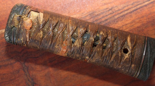

takamatsu Posted July 2, 2013 Report Posted July 2, 2013 Hi to all! I'm in a bit of a predicament with this tanto. Having it's original mountings, I am considering whether to restore the grip or not. Blade (cutting edge 26,5cm) is out of polish but with a pretty nice hamon. On one hand I don't want to change something of the original material because it belongs to the object. On the other hand it's a shame to the blade having such dirty and worn bindings on the tsuka, so... I really don't know. What do you think? If it's your tanto, how would you decide? Any opinions on the age and maker by the way? Attributed to late edo by the seller. Thank you all for your help! Quote

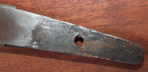

Grey Doffin Posted July 2, 2013 Report Posted July 2, 2013 Hi Michael, I think the blade is later than Late Edo, Meiji maybe or even as late as Showa (basing this mostly on the sloppy nakago). If I'm right in this, then the tsuka likely is older and your tanto is put together out of pieces, not an original set. Again, if I'm right in this, then I wouldn't spend any more money on it. But others may have a better idea. Grey Quote

Marius Posted July 2, 2013 Report Posted July 2, 2013 takamatsu said: What do you think? If it's your tanto, how would you decide? I would sell it and not invest a cent in it. Unless it were part of my family history. Then, cost does not matter as much. As for your blade - it is not what I could call good. A crappy Meiji/later blade or a broken/hagire blade, shortened and mounted. The nakago is very very bad, a sloppy job, like so many in the Meiji period. Put it on eBay, buy something decent, learn. Actually, read and learn first, then buy something decent. BTW - could you be more specific - what do you mean with "nice hamon"? Nice like what? It is undulating, yes. What else is nice about it? Do you understand what a good hamon is, and what it looks like? I can assure you, it is not the pattern which makes a good hamon. Also - the tsuka seems to disturb you. I don't think it is a great piece, but you should be careful in general, when you see such pieces - one day you'll have a valuable koshirae destroyed, because it must be clean and new. Quote
Brian Posted July 2, 2013 Report Posted July 2, 2013 Can't say I agree completely with Mariusz (and a little more subtlety would go far) but he does have some valid points. Yes...I think it is Meiji, but I don't think it is a Showato. The fittings are of a common and lower end type, but they all match. If the mekugi ana lines up, then I think this is the original fittings. Now the blade isn't wonderful. It has had an acid polish, and the fact that the hamon is prominent doesn't make it a good hamon. But it is real and probably at least 100 years old, and I think has old fittings. Also, that style of string wrap is a nice one, and not the common wrap. So you have an average tanto, but complete and with low class and common fittings. I wouldn't spend a lot of money restoring the wrap, and if someone does offer you a decent amount, it will be one to upgrade eventually. But that's how many of us started, and progressed from there. Better than a lot of the stuff you see out there. Brian Quote
Geraint Posted July 2, 2013 Report Posted July 2, 2013 Dear Michael. Have you picked yourself off the floor yet? If we are right that the tanto blade is very late and not of great quality then the koshirae is entirely appropriate. The fittings are of a late type commonly encountered though they are very dirty. If you feel like investing in a re wrapped tsuka then you probably ought to think about a polish and this would be good money after bad in the sense that you are still going to be left with a poor quality tanto in poor mounts which will have little appeal for you as you become more accustomed to what good quality blades and koshirae are like. This one is not a keeper, trade it on. All the best. I see my post crossed with Brian's, same thoughts though. Quote
runagmc Posted July 2, 2013 Report Posted July 2, 2013 The mounts look like they were surprisingly carefully put together, considering that all the parts (including the sword) are low end... I think the mounts look fine like they are... worn and inexpensive - but well put together... Quote

John A Stuart Posted July 2, 2013 Report Posted July 2, 2013 I think another long look at the fittings is warranted. Yamagane, well fashioned. Those menuki are grabbing my attention. I wish I could see them more clearly. A little TLC cleaning and new itomaki would tidy up the koshirae a bit. That is where the geld is in this purchase perhaps. Anyhow at this point I wouldn't be so hasty to dismiss this tanto. Cup half full John Quote

Grey Doffin Posted July 2, 2013 Report Posted July 2, 2013 The reason I was thinking this is put together from available parts is because I like the tsuka much more than the blade. It doesn't seem likely that the tsuka, with passable menuki and nicely done wrap, would have been made for such a low end blade. Seems more likely that the tsuka fit the nakago (possibly after a bit of file work on the edges of the nakago) and was put there to make the kit salable to Meiji or later western tourists. Just a thought. Grey Quote

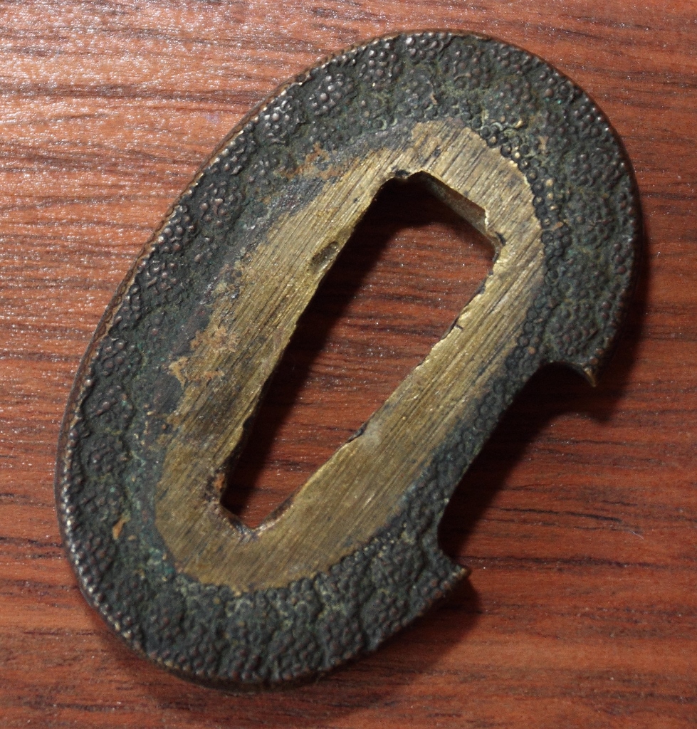

Surfson Posted July 2, 2013 Report Posted July 2, 2013 Thanks for sharing this and posing the question. You are getting somewhat diverse answers. I'm not sure it is as late as Meiji - it might be earlier based on the dark patina. I'm also not wild about the condition or shape of the nakago; it shows some recent damage, which detracts. A polish would likely not be worth the investment, unless you have an attachment to it as mentioned above. The mounts on the other hand are not bad. As mentioned, I like the string wrap, the menuki look like they may be fairly good, and the fuchi kashira look to have two different metals in them, a darkened copper band on the inner aspect as well as the yamagane. Even more appealing is that the fuchi kashira appear to be en suite with the tsuba. If it were mine, I would be having the debate that you are having - is it worth having the handle wrapped? I think that with some new same and a simple wrap, it would be an attractive, en suite piece. In that case, I would view the blade as a steel tsunagi. Cheers, Bob Quote
Alex A Posted July 3, 2013 Report Posted July 3, 2013 Hi Michael, i can what your thinking, new wrap maybe?, not too expensive?, its your call. Certainly would make it a bit more pretty, allthough i think leaving it as is, is best. Allthough not likely an original koshirae, i think what you have as a feeling of authenticity. Taking that away, i think may be detrimental and may put off future buyers who may be a little intrigued by the koshirae, new wraps are 10 to a dozen and of no interest, hope you see my point. In my opinion, dont change old. If you want to do some assembling, find a bare blade, usually cheaper and you will learn a lot from it. Alex. Quote
