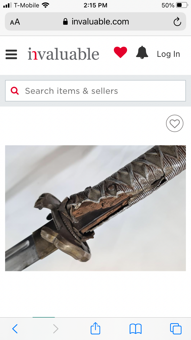

Kai-Gunto Posted July 1, 2013 Report Posted July 1, 2013 Bullet again , but stuck in tsuba and made damage to the seppas, lockclip and fuchi. Photo borrowed from another forum. Quote

Marius Posted July 1, 2013 Report Posted July 1, 2013 Bullet again , but stuck in tsuba and made damage to the seppas, lockclip and fuchi If real, that is a wonderful proof that soft metal tsuba can take some serious abuse There still are some people here and there who deem soft metal as unsuitable to make a useful tsuba. Lovely pic. But...Is it real? People do stuff to sell stuff.... Quote

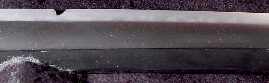

Dave R Posted October 11, 2021 Report Posted October 11, 2021 I have this one, faint but still there, traces of a cut to the mune. A Wakizashi cut down to a long Wakizashi or short Katana. 3 Quote
