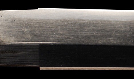

Bensuke Posted June 24, 2013 Report Posted June 24, 2013 Hello everyone! I purchased an Edo jidai wakizashi few months ago and noticed some black spots on the Hi-boshi. I enclosed some pictures. I also noticed few "scratch-looking" black lines on the hamon (not visible on the pictures) that however do not look like hagire or real scratches to me. I first guessed it may be dust or cloth fibers but it seems to be quite similar to the black spots mentioned earlier. I began to worry about my wakizashi's heath and would like your opinions on what these "stains" might be and how to get rid of them. Looking forward to read your opinions and advices! Thanks in advance! Pictures available here: http://hpics.li/1f9541d and http://hpics.li/e24b336 Quote
pcfarrar Posted June 24, 2013 Report Posted June 24, 2013 It's hard to see on your photo but it looks like finger print staining. Best thing to do is just give it a good clean with uchiko. Quote
Marius Posted June 24, 2013 Report Posted June 24, 2013 On uchiko: CAUTION !!!! "Good cleaning" does not mean that you have to use a lot of force when wiping the uchiko off the blade. You have to wipe frequently, but very gently. Too much pressure of your thumb and index finger and you will have nasty hike - hairline scratches. Attached is a pic of a blade with hike. Quote
Dick Tait Posted June 24, 2013 Report Posted June 24, 2013 mariuszk said: On uchiko: CAUTION !!!! "Good cleaning" does not mean that you have to use a lot of force when wiping the uchiko off the blade. You have to wipe frequently, but very gently. Too much pressure of your thumb and index finger and you will have nasty hike - scratches. I was listening to an interview with Paul Martin yesterday and he mentioned that once you've applied the uchiko, tap the blade (I guess meaning strike fist on fist to shake/bounce the blade) in order to remove any larger particles that may scratch the blade. Makes sense. Quote
Marius Posted June 24, 2013 Report Posted June 24, 2013 Dick Tait said: I was listening to an interview with Paul Martin yesterday and he mentioned that once you've applied the uchiko, tap the blade (I guess meaning strike fist on fist to shake/bounce the blade) in order to remove any larger particles that may scratch the blade. Makes sense. Yes, this is a good thing to do. But even those remaining small particles are abrasive, as uchiko is made from the uchigomori polishing stone... So, caution is strongly urged, and a gentle touch is mandatory. Quote
Bensuke Posted June 24, 2013 Author Report Posted June 24, 2013 Thanks for your fast replies! pcfarrar: might be! I was always careful not to touch the blade and didn't let anyone do so. Would it be possible that i left a finger print while cleaning it up with the paper or when i oiled it? mariuszk: Thanks for your warning! That may be a cause, but the stains on mine are perpendicular to the cutting edge and black. It is really hard to get it on pic but i tried my best. You can find the picture here: http://hpics.li/cc5c41d Hope this will help! Quote
Marius Posted June 24, 2013 Report Posted June 24, 2013 Bensuke said: mariuszk: Thanks for your warning! That may be a cause, but the stains on mine are perpendicular to the cutting edge and black. No, no, I was warning you not to scratch your blade when trying to remove the stains with uchiko. Your stains are most likely someone's finger prints, which have resulted in rust. Could also be something in the saya, you never know Quote
