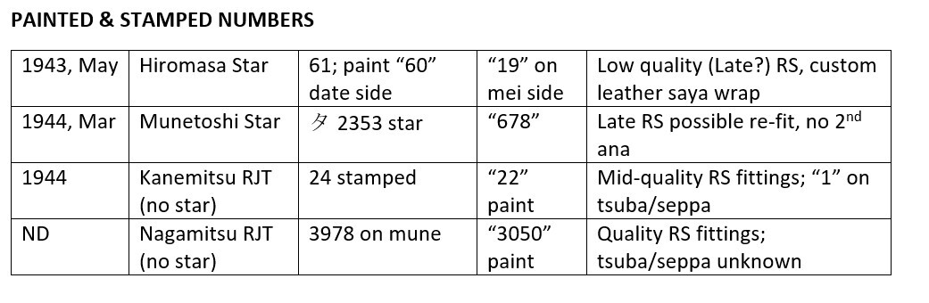

Bruce Pennington Posted June 10, 2021 Report Posted June 10, 2021 Ok, these will blow your head up: 1943 Hiromasa (RJT) Date side - stamped 61, paint - "60"; mei side - paint "19" [fittings unknown] 1944 Kanemitsu (RJT but no star) stamped 24, paint "22"; and "1" on tsuba/seppa 2 1 Quote
Bruce Pennington Posted June 10, 2021 Report Posted June 10, 2021 No Date Nagamitsu Saka 3978 on mune; "3050" painted nakago; fittings unknown Total 4 with mixed stamped and painted numbers: 3 Quote
Toryu2020 Posted June 10, 2021 Report Posted June 10, 2021 Thanks Bruce - at least we know a little more since your compiling examples - thats data that will clearly lead us to an answer and it is better than just saying "assembly numbers" and forget about it. A question that will someday be answered... -t 2 Quote
