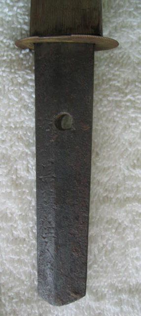

I know shinogi zukuri tanto are unusual, and usually are the point of a broken katana or waki. This one looks to me to be complete according to the nakago, but I could be mistaken. It was listed as mumei, but I think I can see a tachi mei (although I don't expect to get a translation before I can take a better pic)
It is a slender tanto, but not thick enough to be a yoroi doshi IMHO. Doesn't appear to be reshaped, and looks like it was meant to have a shinogi and yokote. Do others disagree, and are there any comments about whether or not it is probable that it is original as seen?
I have seen pics of a very few shinogi zukuri tanto, but none as slender as this one.

It looks nice a nice Higo mounted sword. maybe a boys sword or retired samurai's sword..... hard to see the mei but if i had to "guess" i would say Bizen Kuni Osafune Ju Nin, if so maybe the other side says Yokoyama Sukesada

When you see a thinnish, slender tanto with shinogi zukuri, then take a look at the possibility of a boys' sword. Looking at it now, that is a definite probability. I don't know much about retired samurai swords though :?:
I'll have to wait for it to arrive, and post more pics. But your suggestions seem likely. I don't see a mei continued on the omote though, but maybe it is very worn.

I've got a very similar tanto with shinogi-zukuri. My first guess was the tanto to be a point of a broken sword (sugata looked somewhat incomplete, but maybe it's just because I'm not used to shinogi-zukuri tanto). However, condition and shape of nakago (similar to yours what I can gather from the pictures, but with more pronounced kengyo nakagojiri) could be as well suggesting it wasn't shortened. So I stopped at 'the boy's sword' version.

I am definitely leaning towards a boys sword. The nakago just doesn't give the impression of having been altered from the pics.

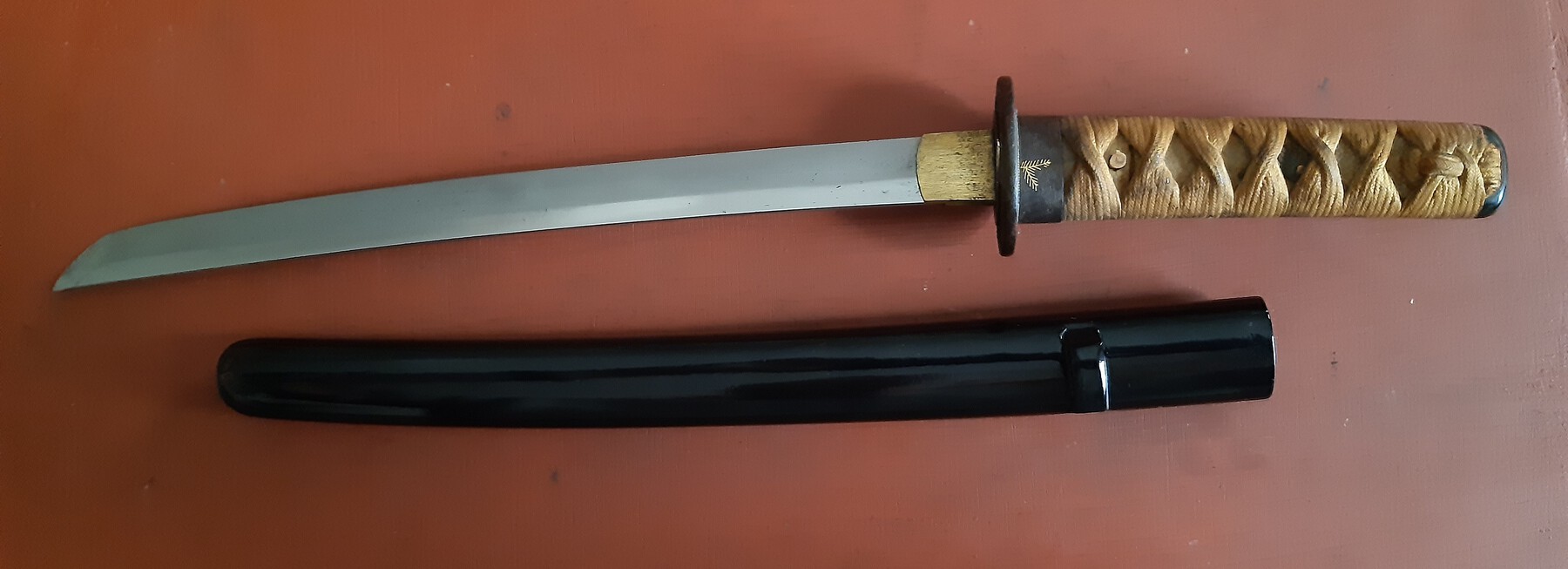

Good day, Brian! I did not want to come in to the site with my tanto yet, but seeing your post above, I thought I must show it. Please see the pic. It seems to be still in good condition, thin, slender, ridgeline present, even yokote is there, gold fern-like leaves on both sides of the fuchi, smooth rounded kashira, worn but undamaged wrapping. Normal nakago, no signature, no date. Length of blade: 285 mm. Sori: 2 1/2 mm. Johan
What exactly is a boy's sword?  Just a smaller version suitable for a child?  How can one distinguish between a blade that happens to be slender and a blade that was made intentionally for a child?
In terms of slenderness, my "boy's tanto" measures 20 mm next to the habaki, going down to 18 mm at the centre and 16 1/2 mm next to the yokote. The blade's thickness is all of 3 mm next to the habaki, with no measureable thinning to the point. The many flowers on both sides of the tsuba look exactly like the cherry blossoms on my shin-gunto tsuba. The kashira appears to be horn. I mention all this so the information can serve as a comparison to your tanto listed at the top, Brian. Johan
But slender profile alone shouldn't qualify a blade as a chigo-zashi, should  it?  I've come across an ubu wakizashi that is ~2.8cm at the motohaba tapering to ~1.7at the sakihaba, with signs of combat damage.  Then again, it had a relatively thick kasane of ~7.5mm or so...
