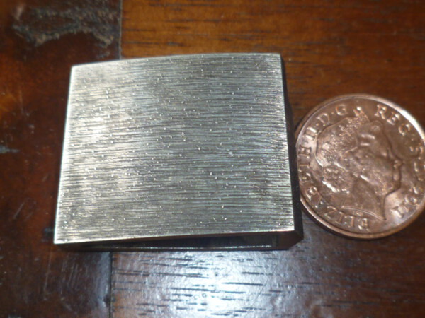

Alex A Posted June 9, 2013 Report Posted June 9, 2013 I was wondering if someone would tell me what they think this habaki is made of, ive been told it may be hakudo (white bronze). I was hoping it may be silver, but thinking like that usually ends in dissapointment :lol:. Quote
Geraint Posted June 9, 2013 Report Posted June 9, 2013 Hi Alex. It is not uncommon for habaki to be made of silver, given the skilled work required to make one the cost of the material pales into insignificance. Silver has the advantage of being a very nice material to work with. All the best. Quote
Alex A Posted June 9, 2013 Author Report Posted June 9, 2013 Cheers Geraint, nothing was mentioned in the listing when i bought the sword which does seem a bit strange if it is silver. The sword was in shirasaya originally so it kind of went a bit unnoticed for a while. Alex. Quote
cabowen Posted June 9, 2013 Report Posted June 9, 2013 I would bet it is silver. Until rather recently, the price of silver was not such a large percentage of the cost when compared to the labor involved. It has jumped greatly and is now causing the cost of silver habaki to increase. Solid silver is quite common in modern habaki and is probably the most often used material. Quote
Grey Doffin Posted June 9, 2013 Report Posted June 9, 2013 Solid silver habaki cost less than silver foil habaki; the value is in the labor. Your habaki is silver. Grey Quote
Alex A Posted June 9, 2013 Author Report Posted June 9, 2013 Cheers Chris, may be nice to have silver seppa too :D, not this year though. Cheers Grey, good news, ps, tsuba looks great on the sword, cheers. Alex. Quote
cabowen Posted June 9, 2013 Report Posted June 9, 2013 In the last 20 years silver has gone from $5 an oz to close to $50 an oz. To make a large habaki, you need several ounces of silver, so the material cost has gone from maybe 10% of the cost ($15 or $20) to 50% ($200).....In other words, I was paying around $200 for silver habaki, now I am paying $400. Quote
nagamaki - Franco Posted June 10, 2013 Report Posted June 10, 2013 another vote for silver habaki http://www.kitco.com/market/ Quote

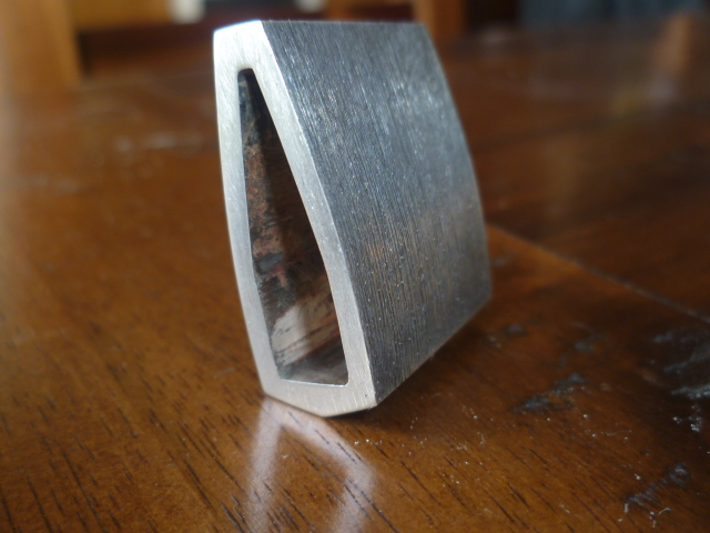

Bugyotsuji Posted June 10, 2013 Report Posted June 10, 2013 Solid silver I agree, but what is the copper washiness inside? Quote
runagmc Posted June 10, 2013 Report Posted June 10, 2013 I would guess oxidation from annealing and soldering... When the pros make solid silver or gold habaki, I assume they are alloyed with copper or other metals for strength. I wonder what the common alloy ratio they use would be?... maybe something like .925 silver, and 14k or 18k gold? Quote
runagmc Posted June 10, 2013 Report Posted June 10, 2013 Hi Lorenzo, I know pure gold habaki are rarely done, but do you think they would be alloyed?... I would think 24k gold might be too soft... Quote
cabowen Posted June 10, 2013 Report Posted June 10, 2013 runagmc said: I would guess oxidation from annealing and soldering... When the pros make solid silver or gold habaki, I assume they are alloyed with copper or other metals for strength. I wonder what the common alloy ratio they use would be?... maybe something like .925 silver, and 14k or 18k gold? I knew a gentleman who made habaki from US silver dollars (the older ones that are real silver). They aren't pure silver and are indeed an alloy. Quote
Alex A Posted June 10, 2013 Author Report Posted June 10, 2013 Im presuming modern habaki are made from sterling silver, 7.5%copper is added. Alex. Quote
