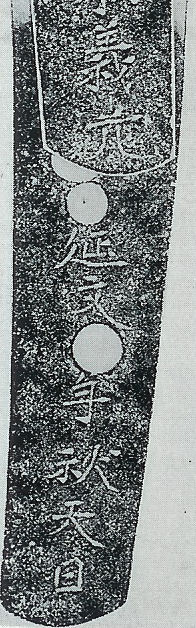

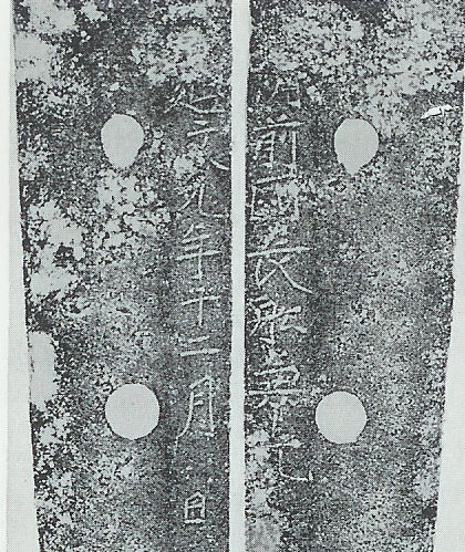

Nobody Posted June 1, 2007 Report Posted June 1, 2007 With only a wild guess. So, please do not ask me the grounds for that. :? 延文 (Enbun: 1356-1361) Attached examples are Yoshimitsu and Kanemitsu in Enbun era. Quote
Ronin 47 Posted June 1, 2007 Author Report Posted June 1, 2007 The second part could be bun but I don't know about the first part it looks more like Gen then En. Just out of curiosity do you have a oshigata of a blade dated Genkyu? Once again thank you for your help Mr. Moriyama Quote
Nobody Posted June 1, 2007 Report Posted June 1, 2007 My oshigata cannot be searched by nengo. So, it is hard to find Genkyu even if there is the data. And moreover, Genkyu era started in 1204 and ended at the 4th month in its 3rd year. If you read "the 5th year" on the nakago, Genkyu cannot be the answer. Quote

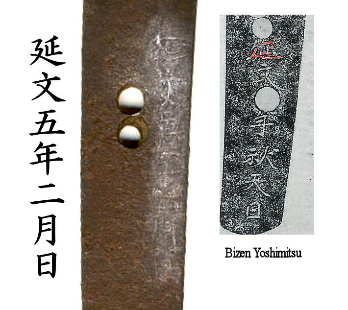

Nobody Posted June 1, 2007 Report Posted June 1, 2007 I am unsure about the date. But I still think that it is Enbun (延文) at present. Maybe Enbun go nen ni gatsu hi (延文五年二月日 = the 2nd month in 1360). Attached image shows how I see En (延) on the nakago. BTW, Enbun belonged to Hokucho (北朝). Quote

Ronin 47 Posted June 2, 2007 Author Report Posted June 2, 2007 I see what Mr.Moriyama is saying about the En. Once again a big thanks to Mr.Moriyama, Stephen, and Sencho for thier help . Here is what the boshi and hamon look like. The hamon is rather distinct but I can't seem to find a good candidate. Any ideas? http://img154.imageshack.us/my.php?image=gen4ll2.png Quote
