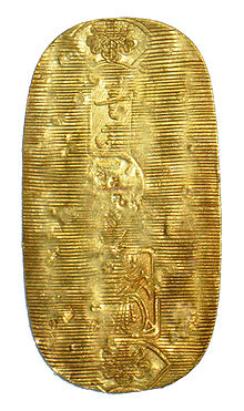

Pete Klein Posted May 19, 2013 Report Posted May 19, 2013 OK -- for whatever it's worth, it's not a fake -- but it's also far from choice due to condition. My two cents. Mauro -- Kyo Sukashi tend toward having 'koban' shaped seppa dai: As you will see in the example under discussion the seppa dai is tapered at the twelve and six o'clock positions which is a characteristic of most Akasaka tsuba (and some Tosa Myochin). Kyo Sukashi works also tend to have ovoid hitsu ana which this example (right - kogai hitsu) does not. The half pipe mimi is also a charastic of Akasaka but can be found in other schools as well. Sometimes it's just a matter of putting together the overall characteristics of the piece and balancing the attributes to kantei it. BTW: for those who are not familiar with Fred Geyer he is the go-to guy here in the USA on Akasaka, having researched hundreds (at least) of pieces for his own collection and writing on the subject also. He has a definite depth of knowledge on the subject.
