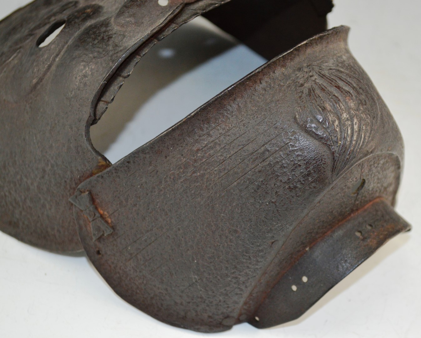

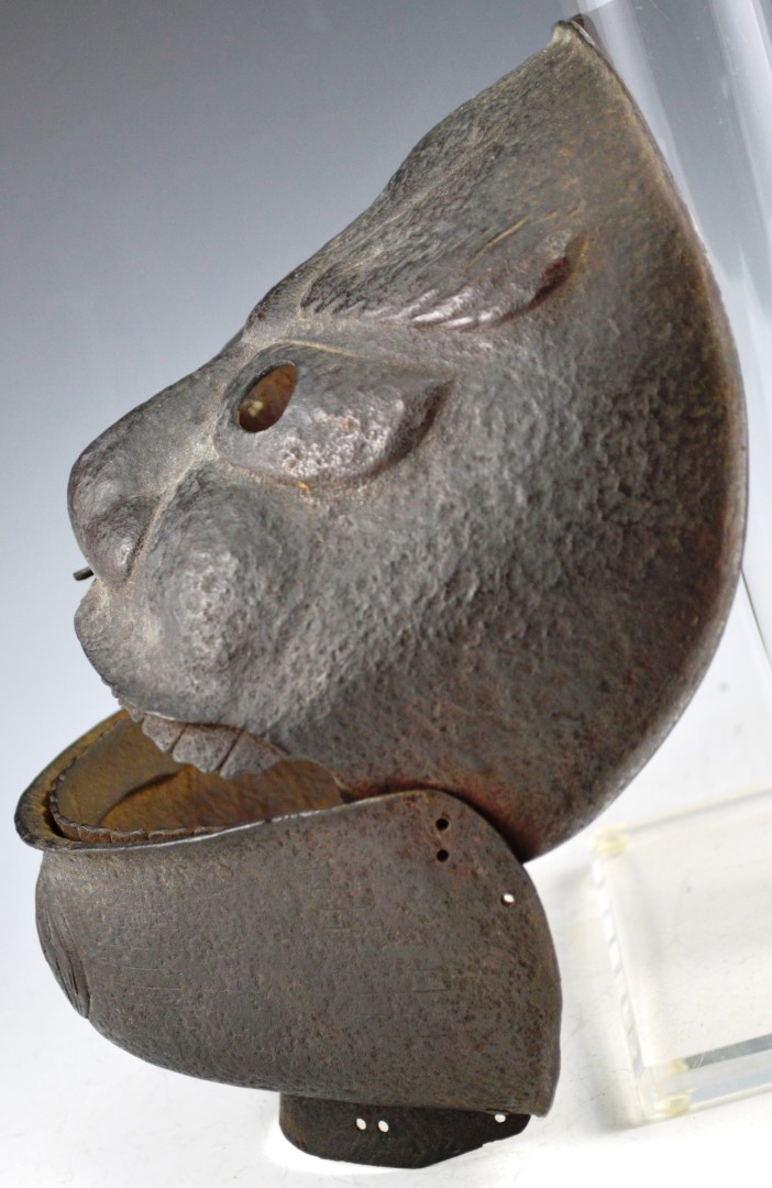

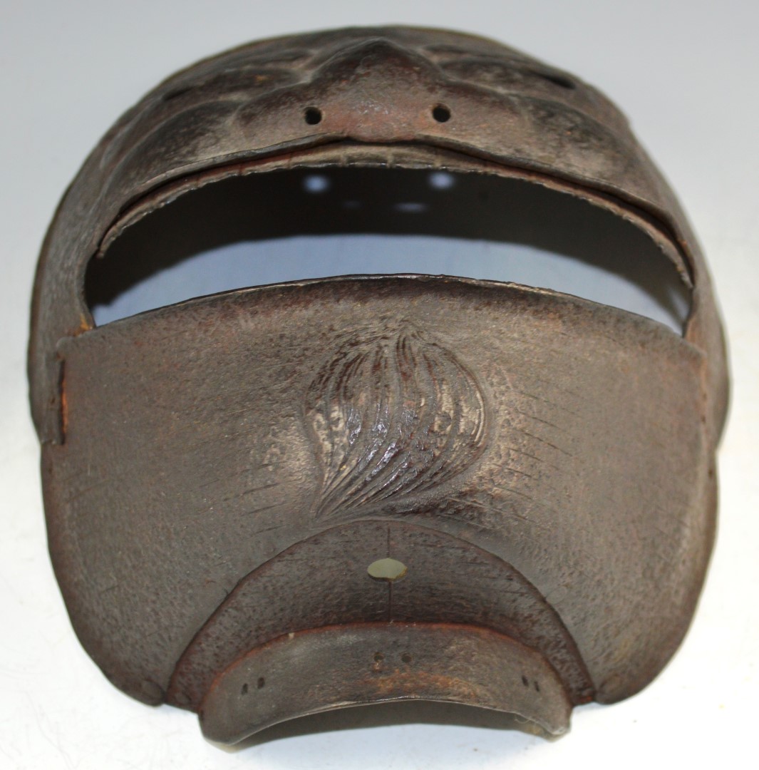

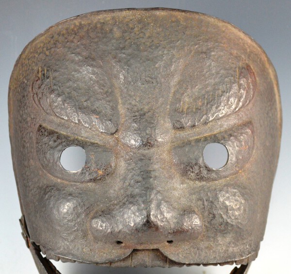

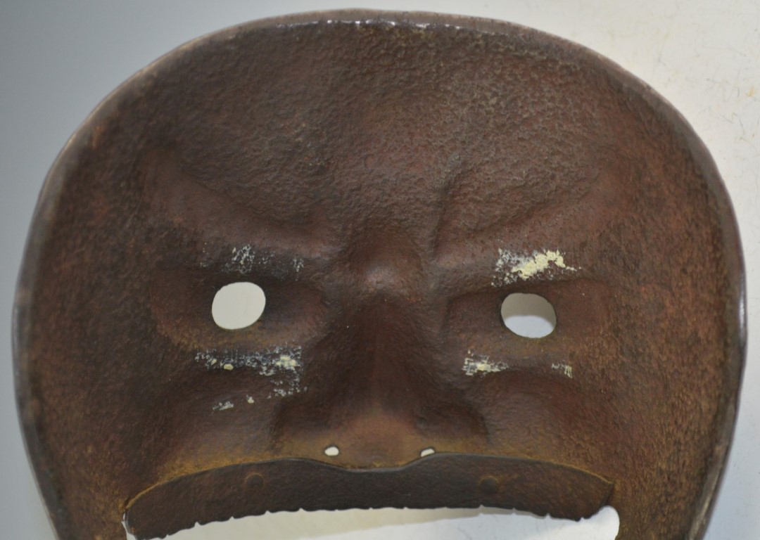

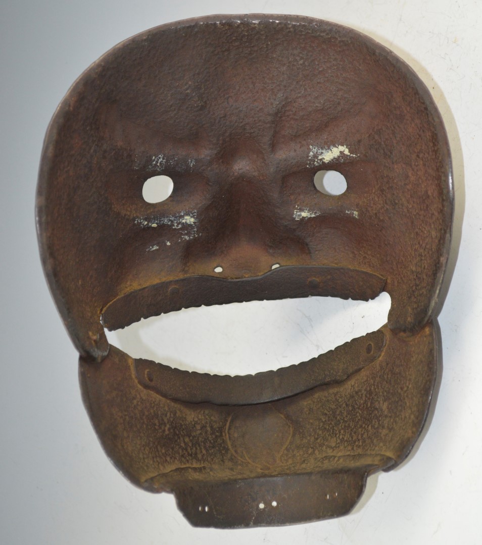

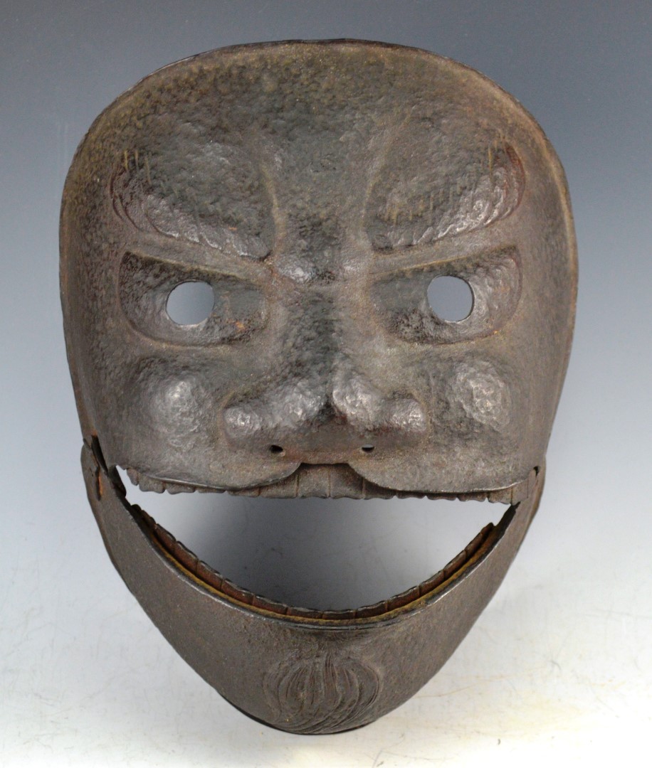

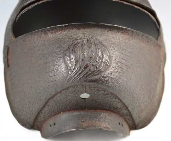

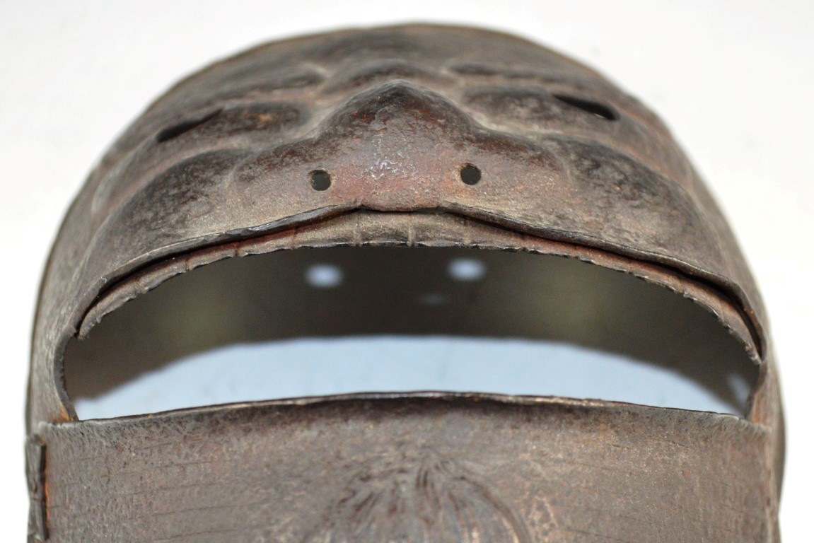

Unique Koto era Somen...I've seen a similar one pictured in a book on early Mempo and I believe this one to be Muromachi period...Heavier than later masks this would likely stop or misdirect a sword blow...Interesting engraved and embossed chin section...The actual surface is much darker and I used flash to show the details better. Ed
Ed, Although it may have been put together a long time ago, what you have here is an Etchu hanbo to which an upper part has been added. The filed lines on the lower part are a give-away.
