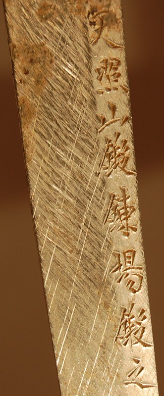

mdiddy Posted May 13, 2013 Report Posted May 13, 2013 Hello, I would like to ask for help with the mei on a Kai Gunto. I make it out so far as 'Amateru Yama ___ ___ Ba Kitau Kore'. First blank may be Fuji(?) and second blank may be another form of Teru(?), yet neither makes sense to me unless I have interpreted kanji for Yama and Ba incorrectly. Usage of Ba makes me think it could be an elongated signature for Inaba, but would be the first to date I have seen. Any insight would be greatly appreciated and I plan to use this for commercial purposes. Thanks for the help. Matt Quote
Bugyotsuji Posted May 13, 2013 Report Posted May 13, 2013 Have a look at this page: http://www.h4.dion.ne.jp/~t-ohmura/gunto_045.htm Quote
cabowen Posted May 13, 2013 Report Posted May 13, 2013 Tenshozan Tanrenjo Kitae kore Made at the Tenshozan Forge. Located in Zushi (near Kamakura). Made stainless (sabi-nai) blades for the Navy. Non-traditional. Quote
Kiipu Posted November 28, 2024 Report Posted November 28, 2024 On 5/12/2013 at 6:40 PM, mdiddy said: I would like to ask for help with the mei on a Kai Gunto. Matt, if by chance you still have pictures available, can I see the other side of the tang? 天照山鍛錬場鍛之 = Tenshōzan Tanrenjō kitaeru kore. Mal, is this an example of higaki-yasurime 桧垣鑢目? Quote
mecox Posted November 28, 2024 Report Posted November 28, 2024 yes but the lighting distorts it Quote
