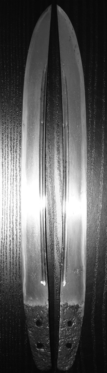

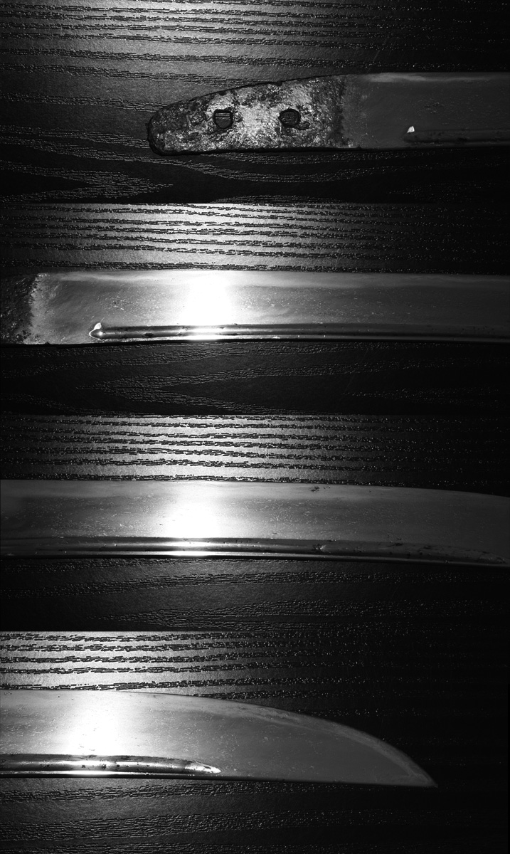

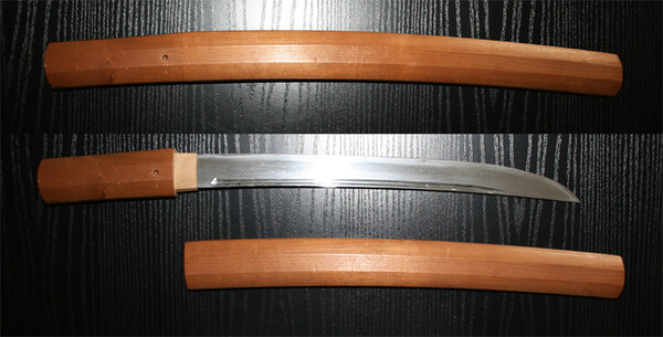

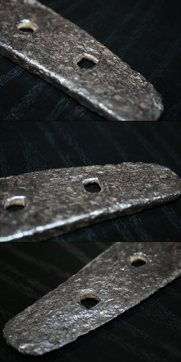

Jorgensen Posted May 12, 2013 Report Posted May 12, 2013 Dear Sir's, Recently I aquired this tanto/wakizashi and would like your skilled opinions on school and smith. I know who the maker is, but I would like your opinions based entirely on the blade. Later I will of course announce the name of the smith to be discussed. There is utsuri clearly visible. What I can say, is that I was very surprised how light the blade is. Why does the one (the old one) mekugi-ana has this irregular shape?? Blade length : 36.5 cm Sori : 0.5 cm Width at the hamachi : 3.4 cm Kasane : 0.50 cm (there is turnback on boshi on both sides, just cant get it on the pictures!) I look forward to hear your comments. Thank you. Quote
Kai-Gunto Posted May 12, 2013 Report Posted May 12, 2013 Cus of the pitting the mekugiana got irregular. I think the hole blade was heavy rusted once. Quote
Jorgensen Posted May 12, 2013 Author Report Posted May 12, 2013 Thomas, thanks for your input. I understand your point, but please check those close-up pictures of nakago and see if it changes your mind. To me it still looks like the irregular shape is not caused by the rust Quote
pcfarrar Posted May 12, 2013 Report Posted May 12, 2013 If you can see utsuri on this blade I'd say its most likely tsukare-utsuri. Quote
Veli Posted May 12, 2013 Report Posted May 12, 2013 Hello Jimi! It is not uncommon to see keyhole-shaped or semicircle+square shaped mekugiana in older blades. Based on the sugata alone, I would say this is a Muromachi era blade. BR, Veli Quote
Marius Posted May 12, 2013 Report Posted May 12, 2013 Jorgensen said: What I can say, is that I was very surprised how light the blade is. You shouldn't. It is a polished down sword, that has lost a lot of "meat". As Peter has rightly remarked, what you think is utsuri is just the core steel showing. Quote
Brian Posted May 13, 2013 Report Posted May 13, 2013 I think this one was once very pitted, and then polished down a lot, judging by the lack of machi and thickness of the blade. It's an old soldier that is now retired Brian Quote

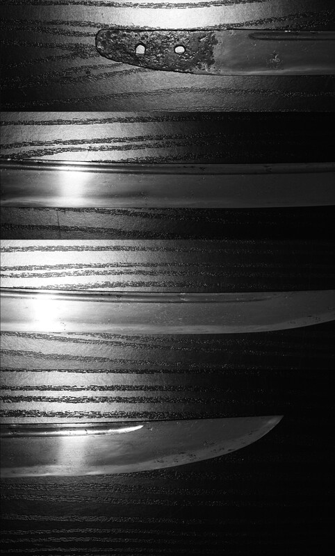

Jorgensen Posted May 13, 2013 Author Report Posted May 13, 2013 Thanks for your comments. It appciated. Since no one have given a guess on school/smith, I can tell its a Nambokucho Nobukuni blade. Yamashiro tradition. Has all the characteristics and shape of Nambokucho Soshu works. It is signed, but very, very hard to see and decipher in hand and impossible to catch on photo because of the heavy rust on nakago. Your comments on this are welcomed. Quote
Marius Posted May 13, 2013 Report Posted May 13, 2013 Jorgensen said: Since no one have given a guess on school/smith, I can tell its a Nambokucho Nobukuni blade. Yamashiro tradition. Has all the characteristics and shape of Nambokucho Soshu works.. No one, even the best members of shinsa panels can give you a guess without seeing the blade in hand. You expect people to pinpoint a smith (!) from those pics you have posted? They show sugata, hadori, but no hamon or hada. If you have the blade in hand and it seems that you know what it is, why do you try to elicit any opinions? Why not send it to shinsa? It is a koto, it should get hozon.... Quote

cabowen Posted May 13, 2013 Report Posted May 13, 2013 The shape is consistent with Nanbokucho Soshu. Quote
