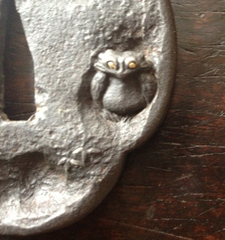

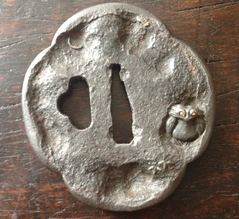

danae24 Posted May 11, 2013 Report Posted May 11, 2013 Hello, I am new here. I need some help on a Tsuba I have. Obviously not an expert, although I did some research on it. I have inherited it, and I don't know if I want to sell it or keep it. What I want is to have some information about it and possible valuation. What I figured out is that it is early Edo period, Tembo school, Mokko gata, probably sukidashi mimi, inlayed metal very irregular surface with a creature with golden eyes inlayed. It is pretty hefty when you hold it, obviously very old. Please correct me if I am wrong, let me know what you know about it and if possible price it for me. Thank you so much for any help. Quote
MauroP Posted May 11, 2013 Report Posted May 11, 2013 Hi, nice tsuba. I'm far from being an expert, but I think that a strong tsuchime-ji (槌目地) ground is not enough to assign your tsuba to Tenpō (天法) school. Naturalistic carvings, presence of soft metal inlays and absence of "hot stamps" (kokuin - 刻印) are all characteristics not typical of Tenpō. Bye, Mauro Quote
Alan Morton Posted May 11, 2013 Report Posted May 11, 2013 Hello Danae?, I can understand your Tenbo call on this tsuba but as Mauro says I don't think so. Saotome also did this type of work.I think I would guess Mito school on this one and your creature looks like a frog sitting under the moon to me. I do like your "ugly" little Tsuba. Alan. Quote
Marius Posted May 11, 2013 Report Posted May 11, 2013 Please correct me if I am wrong. Looks like a late Edo tsuba. Clumsy workmanship, trying to look antique, with awful rim. Sorry to be so blunt, but you had better not believe you have inherited some masterwork. Value: $100 or maybe even 150 if you are lucky (no, I am not interested). Quote

Soshin Posted May 13, 2013 Report Posted May 13, 2013 Hi Alex K., Here is a fine example of a Tenpo tsuba in my collection: http://www.militaria.co.za/nmb/viewtopic.php?f=2&t=15769. I have more photos and information on my website. Yours truly, David Stiles Quote

christianmalterre Posted May 13, 2013 Report Posted May 13, 2013 Hoaffablo :D missed that threat here-sorry for delay of mine post! Is this an Oal or rather an toad depicted here? LOL! Funny piece! (don´t be so harsh here Gentlemen ) Alex,do keep it!-It´s pretty very cool and funny in fact!(Me do Love it!!!!) (once you do have an good collection to show and discuss to an collectors friend during nice evening meeting-the last one you lay on table must be THIS one...LOL!) No joke!-pretty funny Tsuba for everybody(who did not see it yet) i think.... Laugh! It´s Cool! :D Christian Quote
hxv Posted May 13, 2013 Report Posted May 13, 2013 Christian, I don't see it at all...I must confess that to me, it just looks like the frog/toad is taking a dump under the crescent moon. I'm sorry, but I don't see anything else. Regards, Hoanh Quote

ROKUJURO Posted May 13, 2013 Report Posted May 13, 2013 Gentlemen, to me the depicted animal is closer to a TANUKI than to a frog. Quote

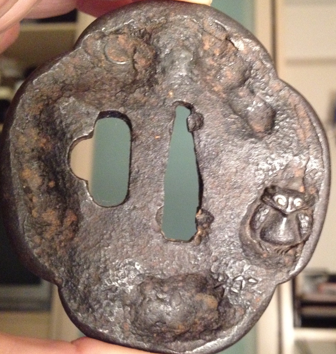

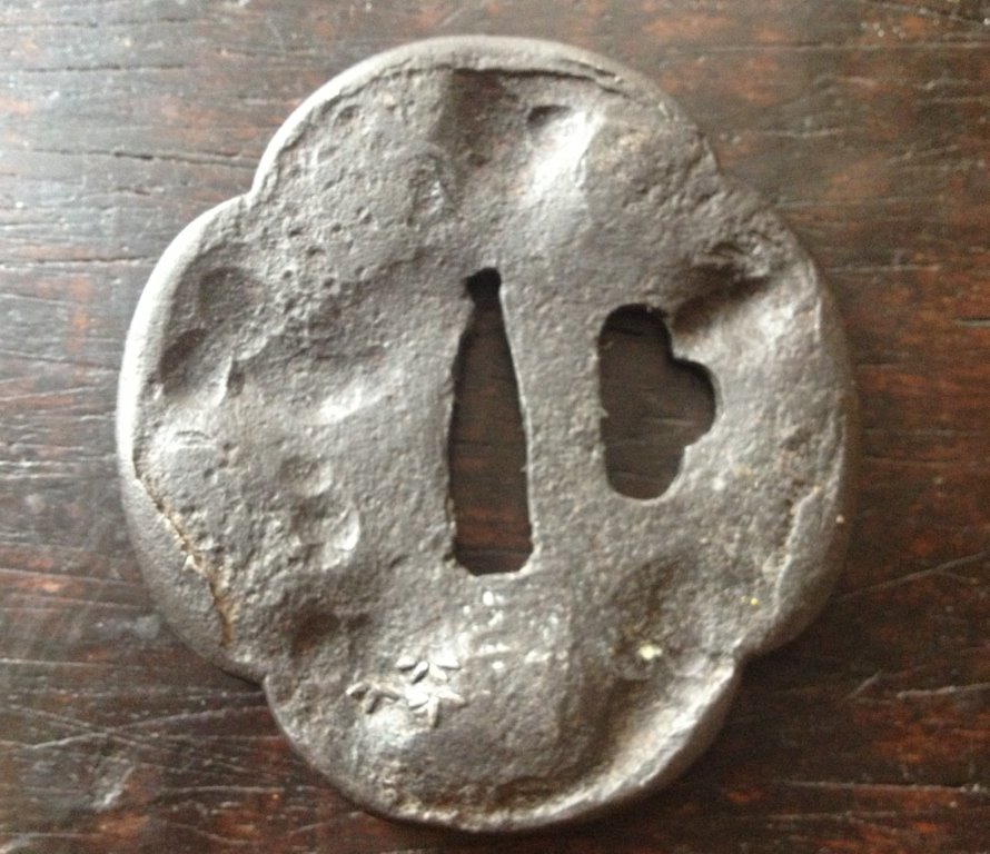

danae24 Posted May 13, 2013 Author Report Posted May 13, 2013 Looks more than a little monster with golden eyes, a tanuki is more likely. Here are more pictures. Alex K. Quote
Tanto54 Posted May 14, 2013 Report Posted May 14, 2013 Come on guys, haven't you ever seen a Fukuro (Owl) before? It's sitting in a hole in a tree under the moonlight. Quote
watsonmil Posted May 14, 2013 Report Posted May 14, 2013 Dear George, Excellent ! Yes an OWL .... I was going to comment earlier, ... but given the negative tone, and the abismal identification of the depicted subject ( and Brian's excuse for other's bad manners ) I bit my tongue, ... but what the hell. Now my response to Alex, ... ( if you're still with us ), ... is that although I agree it is not a masterpiece, ... it is not as bad as some here would have you believe. In my ( humble ) opinion, ... it is actually not bad at all. The artist/craftsman is conveying a rustic - rugged interpretation of the subject, ... and AGAIN in my humble opinion has done so quite nicely. If I were sitting around a table with friends, ... it would most certainly not be the last to set before their eyes. Keep your tsuba Alex and enjoy it. I sincerely hope it is the beginning of an enjoyable hobby and learning experience for you. I enjoyed studying your tsuba ( as best as photography allows ), ... and look forward to your posting any future finds. By the way Alex, ... I've been collecting the Arts of the Samurai for 35 years ... which is longer than some of those who post here have been around. ... Ron Watson Quote
danae24 Posted May 14, 2013 Author Report Posted May 14, 2013 Thank you Mr. Watson for taking the time to write and confirm the owl and for your encouragement. There has been no consensus about the date and school of this Tsuba. I would like to hear your opinion. Best regards, Alex K. Quote
watsonmil Posted May 14, 2013 Report Posted May 14, 2013 Dear Alex, There are much more specialized tsuba collectors than I. I would hazard a guess at mid to late edo. School ?? Best to direct your query as to school to David Stiles ... user name : Soshin . He is very much a gentleman and very knowlegable on the subject of tsuba. I would be interested in knowing the size of this tsuba and thickness however ... if you could post please. ... Ron Watson Quote
Soshin Posted May 15, 2013 Report Posted May 15, 2013 Hi Alex K., From looking at your last photograph of the tsuba I would say likely a school work of the Aizu Shoami school circa the late Edo Period. The critical points in my eyes are the deeply hammered surface, raised rim, and the high relief carving with soft metal inlay. All of these techniques were used by the Aizu Shoami school often together. Your don't see this complex of inlay work or high relief carving in Tenpo tsuba also Tenpo tsuba would often have only small dot inlays, small openwork designs, and/or hot stamps applied to a hammered surface. Hope you find the information helpful. Yours truly, David Stiles Quote
danae24 Posted May 15, 2013 Author Report Posted May 15, 2013 Thank you Mr. Watson for your recommendation. The size of the tsuba is 7.4 cm x 6.8 cm x .32cm Mr. Stiles thank you for taking the time to give me your opinion. Aizu Shoami and Mito are the closest descriptions for this tsuba. Thank you all for your input. Alex K. Quote
