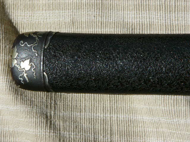

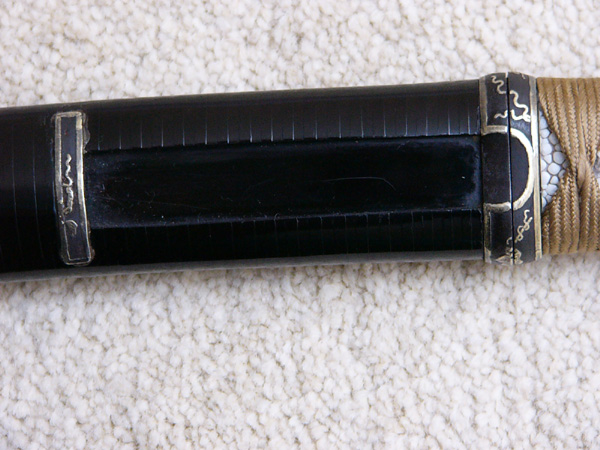

deskjet Posted September 16, 2006 Report Posted September 16, 2006 Hi , I have a very large saya in akuchi mounts ,iron and brass dont think it is gold the iron is a good chocolate colour unsure of the school ,could it be Hamano or Hejano I read somewhere that these large akuchi were often worn with armour ,would aapeciate any comments. Anthony Quote
Curran Posted September 16, 2006 Report Posted September 16, 2006 If possible, please show us close-ups of the rest of the fittings- especially the junction between the scabbard collar and the fuchi. Initial thought is "higo" or "heian-jo", as some iron and gold (yes gold- not brass, sentoku, etc) "heian-jo" items were made very similar to Higo stuff. It could also be Satsuma work, akin to Higo- but some things like the saya loop will be the only pointers there. Most likely it is Higo. From the initial photos it looks that the wrap has been removed from the handle and I also suspect the tsuba & menuki have been removed. I do not think it was originally an aikuchi mount job. More photos would help firm up the opinion. Curran Quote
deskjet Posted September 16, 2006 Author Report Posted September 16, 2006 :D Thanks for the information i will end more photos Anthony Quote
DavidF Posted September 16, 2006 Report Posted September 16, 2006 Gold painted on iron. Very common style of fittings. DaveF. Quote
Bungo Posted September 16, 2006 Report Posted September 16, 2006 DavidF said: Gold painted on iron. Very common style of fittings. DaveF. actually iron f/k is considered " rare " Milt THE ronin Quote
Grey Doffin Posted September 17, 2006 Report Posted September 17, 2006 I don't think there is any doubt about this being aikuchi; it definitely is. Looks very nice. Grey Quote
Bungo Posted September 17, 2006 Report Posted September 17, 2006 Grey Doffin said: I don't think there is any doubt about this being aikuchi; it definitely is. Looks very nice.Grey Yes, I agree this is aikuchi, the fit of the koiguchi and the fuchi with the " merging " of pattern ( the semi round kozuka slot ) indicates that's there no tsuba intended. However........now this is my personal opinion only , first pic shows no ito on the tsuka and later it's wrapped . I think aikuchi type mounting usually does not have ito wrap on the tsuka. So the ' restoration " work is a bit off the convention. p.s. to nailed down the kashira, usually they use a " clove leaf/heart " shaped metal plate instead of the silk cord over the hole at the side. pps. and if the tsuka is " wrapped ", it's usually a round and round binding ( not diamond cross hatch ) with the menuki sitting on top of the binding. Milt THE ronin Quote

Brian Posted October 18, 2006 Report Posted October 18, 2006 Welcome to the forum, glad to have someone here from Norway I wonder if the availability of Nihonto there, is as bad as here in South Africa? Judging by the matching kashira, I would have to theorise that this is indeed one of the exceptions to the general rule. The same and wrapping do look like a newish restoration job, but look done in the way it was intended to me. Just need a few 100 years of aging to get that nice aged look to the ito and same Brian Quote
