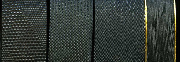

raiden Posted May 11, 2013 Report Posted May 11, 2013 left to right - unsigned, Goto Mitsunari, Omori Hidekazu, araki Tomei. Quote
kaigunair Posted May 12, 2013 Author Report Posted May 12, 2013 Thanks mike. I really appreciate how you post exquisite pieces an even more so when you help neophytes like myself with examples like these. Quote
Brian Posted May 12, 2013 Report Posted May 12, 2013 Thanks Mike, great photos. That first one is unusual, and very effective. Really like the pattern. The pics also show something that I wasn't expecting....not all of the nanako by top makers is as uniform and perfect as I expected. That Tomei nanako is well done, but not those perfect straight and even lines we always expect. Maybe we put these quality expectations into too-neat little boxes and don't allow for variations. All great examples though. Brian Quote
runagmc Posted May 12, 2013 Report Posted May 12, 2013 I thought the same thing, Brian... I would have expected better... Then again, the lighting and magnification could be partly to blame... Quote
Brian Posted May 12, 2013 Report Posted May 12, 2013 Thinking about it...I think the reason may be that Mike's photography is simply too good. I was looking at them, and wondering what they would look like in real size, and if anything like this, then that nanako really is staggering considering the size. Brian Quote

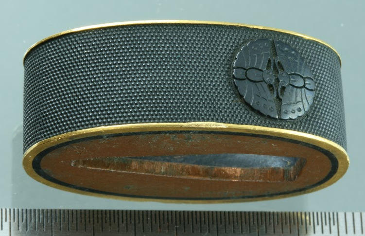

nagamaki - Franco Posted May 12, 2013 Report Posted May 12, 2013 Not all nanako are created equal, appreciation requires evaluation of consistency in strike, cone shape, spacing and lines. Keep in mind that the nanako is being produced as much by feel as anything else, too small for visual to be the primary guide, so consistency of tap force and feel placement of the punch in relation to the nanako previously made is critical. Think about it, just one or two misalignments can create a domino affect in a row that very well may extend to more. One must also consider and take into account the overall affect as intended as part of the scene being depicted. Is some of the nanako being of different shape intentional, purposeful, or not(?). The following image, again, is the Sonobe Yoshihide. Although focus is distorted, it still demonstrates its quality nanako. Quote

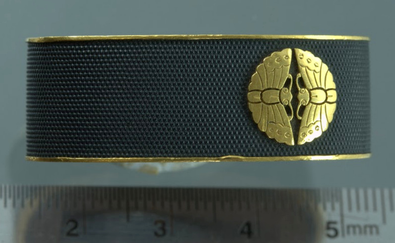

Ford Hallam Posted May 14, 2013 Report Posted May 14, 2013 This is some pretty tidy nanako. From a Kamishimo Daisho koshirae I once owned. Quote
Brian Posted May 14, 2013 Report Posted May 14, 2013 Thanks to you and Mike, I have now had to add 2 new smileys. :lol: Brian Quote
Soshin Posted May 15, 2013 Report Posted May 15, 2013 Thanks to you and Mike, I have now had to add 2 new smileys. :lol: Brian Hi Brian, So that is why I see the two new smileys this evening. With what Mike Y. posted. I will need them as well. Yours truly, David Stiles Quote
runagmc Posted May 15, 2013 Report Posted May 15, 2013 Ford, that may be the most uniform nanako I've seen to this point... it would be hard to do any better than that I think... Quote
Bazza Posted May 15, 2013 Report Posted May 15, 2013 Does Ford's example suggest the use of a matrix punch???? BaZZa. Quote
runagmc Posted May 15, 2013 Report Posted May 15, 2013 I assume by matrix punch you mean a multi-nanako punch, which is a possibility... I've never tried one, but having played around with regular nanako punches, I would think it would still be very difficult to maintain such uniformity even with a multi-nanako punch... After a fair amount of experimentation, I can do pretty good looking nanako, but I still haven't been able to achieve this kind of perfection, so I don't know One thing I do know is that the angle of light reflection, and viewpoint of the camera (or your eyes), can hide imperfections in the nanako, so maybe it's not quite as perfect as it appears in these photos... Quote
