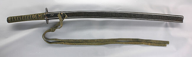

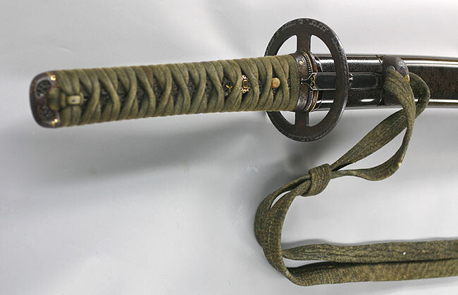

Ford Hallam Posted May 27, 2007 Report Posted May 27, 2007 In general I think it can safely be said that the shape of the fuchi and kashira used in the Higo style of mounting are quite distinctive. The fuchi has the so called, jar lip, shaped profile, ie; it tapers in toward the handle. The kashira is invariably of a rounded domed form. These traits are of course seen on swords from other areas but in Higo, after the time of Hosokawa Tadaoki, it would appear to have become "de riguer". The taste in Higo would also seem to favour doe skin for wrapping the hilt, and polished and lacquered same on the saya. Tadaoki's own sword, mounted in what has become known as the " kasen koshirae" style perfectly illustrates these traits. Tadatoki was a very influential leader, not only in Higo, and was hugely influential in supporting and encouraging the metalworkers of his domain. As an accomplished aesthete he no doubt had a major influence on their artistic expression and also the popularization of the classic Higo style koshirae. Ford Quote
Ford Hallam Posted May 27, 2007 Report Posted May 27, 2007 This is the aforementioned Kasen Koshirae. Quote

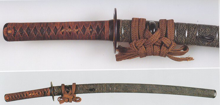

Pete Klein Posted May 27, 2007 Report Posted May 27, 2007 this koshirae was Juyo Kodogu, from Ginza Seikodo. Quote

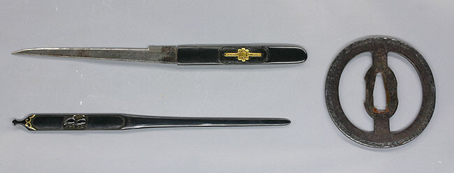

Ford Hallam Posted June 2, 2007 Report Posted June 2, 2007 This koshirae over on Aoi-art is from Higo too. This example is a little different from the general type we've been describing thus far but should also be noted as a not uncommon alternative look from this province. The obvious give-away here is the Hosokawa mon on the saya. The tsuba has some sleight Higo traits but I'd suggest more of a Umetada school influence. The gold nunome-zogan on the rest of the metal fittings is typical of that province though. Note also the "inu-me", or boar's eye shaped shitodome ana in the kabutogane/kashira, this shape is also a common Higo trait. It appears on kozuka, bashin and as hitsu-ana on tsuba as well as in many other places.http://www.aoi-art.com/fittings/7200-7249/07216.html cheers, Ford Quote
