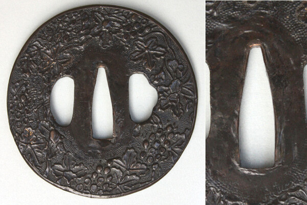

MauroP Posted March 31, 2013 Report Posted March 31, 2013 A very interesting topic here. As a collector I'm more interested in ethnographic rather than artistic value of tōsōgu (could be an excuse, if I should only afford better pieces... ). The tsuba here below is a sanmai gō ( 三枚合) and is undoubtedly a mass production but it looks like to have been mounted on a sword at least once in its life (I suppose so from the scratches on seppa-dai). In other words, here I have a low quality tsuba, but presumably not originally intended to be sold as souvenir to western tourists. Does it fit the definition of shiiremono? Bye, Mauro Quote
Soshin Posted March 31, 2013 Report Posted March 31, 2013 Hi John S., Thanks for posting this topic for discussion learning more about the proper use of terms such hamamoto or shirimono is important. I am not sure if the sanmai-go tsuba would be considered shirimono or not. Keep in mind that even during the Edo Period there was a great range of prices and quality of tosogu. But I remember reading that shirimono of higher quality were intented for the domestic Japanese market. I might be misremembering something but I will try to look up a reference tomorrow. Yours truly, David Stiles Quote

kunitaro Posted March 31, 2013 Report Posted March 31, 2013 Shiiremono is pointing at cheap mass product (cast) souvenirs, not necessary to be for western tourist, for Japanese market as well. Hamamono is more High quality hand made Souvenirs for Western Tourist at Bakumatsu to Meiji period. They were very very rich. 三枚合 Pronounce "San mai Awase” 三枚合わせ、wase is abbreviation. The Tsuba is made in Momoyama to early Edo period. They are kind of mass product, but, they were Hand made mass product... It doesn't call "Shiiremono". It will get NBTHK Hozon, attributed as ko-kinko or Tachi kanagushi. but Shiiremono will not get Hozon. Quote

Soshin Posted March 31, 2013 Report Posted March 31, 2013 三枚合 Pronounce "San mai Awase” 三枚合わせ、wase is abbreviation. The Tsuba is made in Momoyama to early Edo period. They are kind of mass product, but, they were Hand made mass product... It doesn't call "Shiiremono". It will get NBTHK Hozon, attributed as ko-kinko or Tachi kanagushi. but Shiiremono will not get Hozon. Hi Kunitaro-san, Being a member of the NBTHK I would like to thank you for the explanation and the NBTHK policy on shiiremono. It is really helpful. ---------------------Edit--------------- Here is a literal translation of the Japanese term into English:http://www.eudict.com/?lang=japeng&word=shiiremono. Here is a definition taken from the glossary of Tsuba An Anesthetic Study by Haynes and Torigoye. SHIIREMONO: "ready-made article." When applied to tsuba this term refers to ready-made or mass production work of the late Edo age, but may also be applied to mass production pieces of earlier ages. Much SHIIREMONO was made to be sold to foreigners. From this review it fairly clear that shirremono only refers to mass-produced pieces of no antique or artistic value. The case is closed for me. I have learned my lesson now its time and move on. Yours truly, David Stiles Quote
MauroP Posted March 31, 2013 Report Posted March 31, 2013 Many thanks, Kunitaro, for the right pronunciation of 三枚合. I'm also glad to be confirmed that my sanmai tsuba are a little more than junk pieces. Thanks to all you Gentlemen for sharing your knowledge in this forum. Mauro Quote
