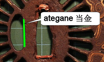

John A Stuart Posted March 31, 2013 Report Posted March 31, 2013 Heianjo-zogan, maybe Momoyama. I would think your gold is in fact shinchu (brass). Missing atogane and very rusty indeed. John Quote
GregN Posted March 31, 2013 Author Report Posted March 31, 2013 Thank you for the reply John. I've Googled specific words in reply and think atogane translates to inlay in English? Condition is an issue and I've read several post and websites on how to care for tsuba - less is best and take you time, think about what you are attempting before you make things worse. I find tsuba study quite addictive, time to buy some books and find a local collector to help guide me. Thanks you again, Greg Quote

MauroP Posted April 1, 2013 Report Posted April 1, 2013 Hi Greg, I think John was referring to a missing ategane (当金) i.e. an insert of soft metal to prevent scratching of kozuka or kōgai. The generic word for inlay is zōgan (象嵌). Bye, Mauro Quote
GregN Posted April 1, 2013 Author Report Posted April 1, 2013 Thanks Mauro for the correction, I didn't even notice! There are several areas where the zogan is missing or pulled away. I've also added the reverse of the tsuba and it appears in my 2nd I only post a different orientation. Sorry. BTW is there a lexicon where I can use the correct letters, accents and symbols in my posts? Greg Quote
