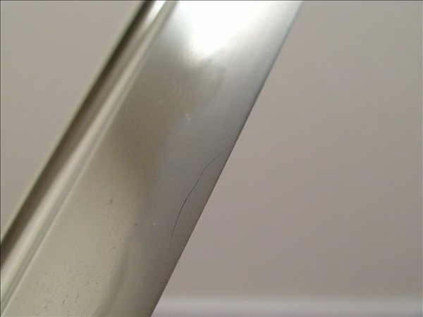

jasongarabedian Posted March 21, 2013 Report Posted March 21, 2013 Gdaye guys, Just a question about hagarami. Ive read that hagarami are actually kitae-ware that is close to the cutting edge. Is this accurate or is hagarami actually a stress crack like a hagire but on an angle as opposed to being perpendicular to the cutting edge like hagire are? Can anyone show me pictures of hagarami and if all hagarami are fatal? Thanks, Jason G Quote

kunitaro Posted March 21, 2013 Report Posted March 21, 2013 刃絡み Hagarami is the Kitae-ware in/on Hamon. It caused by over polish. showing tiredness as well. normally one side. It is not same as Hagire. Kitae-ware on Ji is possible to repair(close the lamination) sometime, but, Kitae-ware in/on Hamon (Ha-garami) is not possible to do repair. Quote
kunitaro Posted March 21, 2013 Report Posted March 21, 2013 This photo of the blade has hagarami, but, still looks fine (ji) because, with good polish. Ji is carefully polished that doesn't show rough hada. (if you enlarge photo, maybe you can see lough hada) but, it is tired blade. it should be retired. not for using. but studying. Quote

kunitaro Posted March 22, 2013 Report Posted March 22, 2013 Newly forged blade shouldn't have any kizu especially in/on Hamon. when smith saw Kizu (opening) in Ha, he will not release the blade.it is fault. the Kizu would show up after over polish. It is not possible to answer without photo. however, If the damage is caused by hitting something hard, it is crack, and if the crack line goes to the edge. then it is Hagire, even if you see only one side, it will goes through other side as well. If you look at kizu with magnifying glass, you will see if it is lamination opening (Hagarami) or crack (Hagire). Quote

cabowen Posted March 22, 2013 Report Posted March 22, 2013 Hagarami follows a weld, a hagire is usually across welds. One is a forging flaw, the other a crack caused by externally induced stress. Forging flaws can show up after one polish so I am not so sure a hagarami is only seen in tired blades. Quote
kunitaro Posted March 22, 2013 Report Posted March 22, 2013 I used the words "lamination opening" for Kitae-ware. (is it making you confuse ?) 刃絡み( Ha-garami ) is meaning 刃に絡む鍛え割れ/ Ha ni Karamu Kitae-ware. 絡む・絡まる= entangle/entwine. 鍛え割れ/Kitae-ware(lamination opening) entangle/entwine in/on 刃(Ha)= Hamon. 刃(Ha) meaning in Nihonto is Hamon part. against Ji. for kitchen knife is cutting edge. lamination opening on JI is called Kitae-ware. lamination opening on Ha(Hamon) is called Ha-garami, It is different from Ha-gire. and It is nothing to do with Tsukurikomi (construction). Regarding Tiredness/疲、It doesn't matter how many time polished, when you start to see flaws by polishing or using, we can say "tired" or "not healthy any more". If the blade has bend many times without polishing, start to see 撓え(Shinae) that is also tired. we don't say that "The blade is healthy but tired"... a little bit tired, or very tired... (maybe it is just language matter) however, flaws on Ji are possible to repair sometimes, but, flaws in/on Ha(Hamon) is not possible to repair. 1 Quote

Marius Posted January 1, 2016 Report Posted January 1, 2016 What I see in your picture looks like tate ware. Hagarami is a crack similar in nature to hagire, but unlike the latter, it is not perpendicular to the edge. 2 Quote
Andi B. Posted January 1, 2016 Report Posted January 1, 2016 Still confusing: Do all three images show what is called Ha-garami? First #4 looks like a crack in the ha while the other two #17 & #19 look like open layers... Quote
Shogun8 Posted January 2, 2016 Report Posted January 2, 2016 On 1/1/2016 at 7:41 AM, mariuszk said: What I see in your picture looks like tate ware. Hagarami is a crack similar in nature to hagire, but unlike the latter, it is not perpendicular to the edge. Thank you Marius. Is tate ware considered fatal? John Quote
Marius Posted January 2, 2016 Report Posted January 2, 2016 John, No, they are not. That is why your sword has received Hozon 1 Quote
