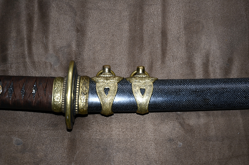

Hello All,

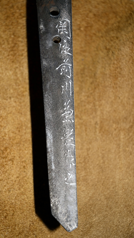

I've recently found this sword in a friend's collection - pretty koshirae IMHO. I haven't fully translated the mei, but know it was made by a Seki smith and appears to have been re-mounted. It has a very tiny kanji (maybe 3-4mm) just above the top mekigiana that is not stamped but hand carved. Thought I'd post it for your enjoyment...

I agree! It is probably out of my price-range (having another blade mounted in shirasaya & habaki made for it so *poof* goes my collecting $$ lol), but very pretty and the Tsukamaki is beautiful, even today. Also, the menuki are very thick vs. the standard ones seen on most Gunto. Not sure if the owner would like to sell it but I will certainly ask!

Hi Curtis,
a pretty standard gunto, made by a known gunto kaji in Seki as you say. Nice fittings and condition. BTW when the suspension rings are found "moved up" like this, it is usually because some thin leather linings inside the top part of the loops have fallen out. If your friend gently slides the loops down a bit, uses a bit of paper to slip under the top decorated portion and traces the shape around the edge onto some thin leather then re-cuts a couple to fit the shape and slips them in, the loops should stop back at their original correct position. This position is adjusted by the thickness of the leather

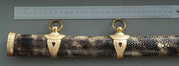

If you want to pass it on, this saya is original, and for reference it shows where the suspension rings are placed.
Cheers
Denis.
Thanks Denis! When I looked @ the saya closely I saw a slight indentation exactly where those in your photo are.

I attempted to get a good clear photo of the kanji (and re-confirmed it's engraved, not stamped as I can see the "tap marks" under magnification) just above the mei, but without a macro lens it didn't work out well. Here is an accurate hand-drawn copy of it, and hope this will help for the Arsenal Stamp database?

I'm confused now Mr. Bowen...
If I've translated properly, the first kanji in the mei says "seki"? Then would the arsenal also engrave a second "seki" stamp in tiny kanji above? (or perhaps the order was reversed....tiny stamp in the nakago and then the mei after completion perhaps?
I love a good mystery :D .
Many thanks,
Curtis R.
It's not too complicated...The smith signs the blade, and in this case, includes the location where he worked (Seki). This is rather common. Since the sword was made for the military, it gets inspected, assembled, and inventoried. At some point, either someone with the military or the factory where the sword was made, placed a small stamp on the blade. Also very common.

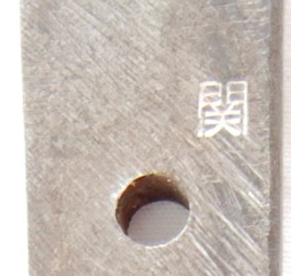

Curtis,
What Chris is saying is that the mark isn't some random carved kanji, it is the standard Seki stamp that is seen on arsenal blades.
It may look hand cut, but logic says it must be the usual stamp.
Do you have a close up photo?
Brian
Curtis, here's a Seki stamp to compare with the marking your sword... if you haven't done so already... post-2413-14196862815183_thumb.jpg
PS- it's important to remember that often the stamps aren't evenly struck, so you may only see a portion of it...

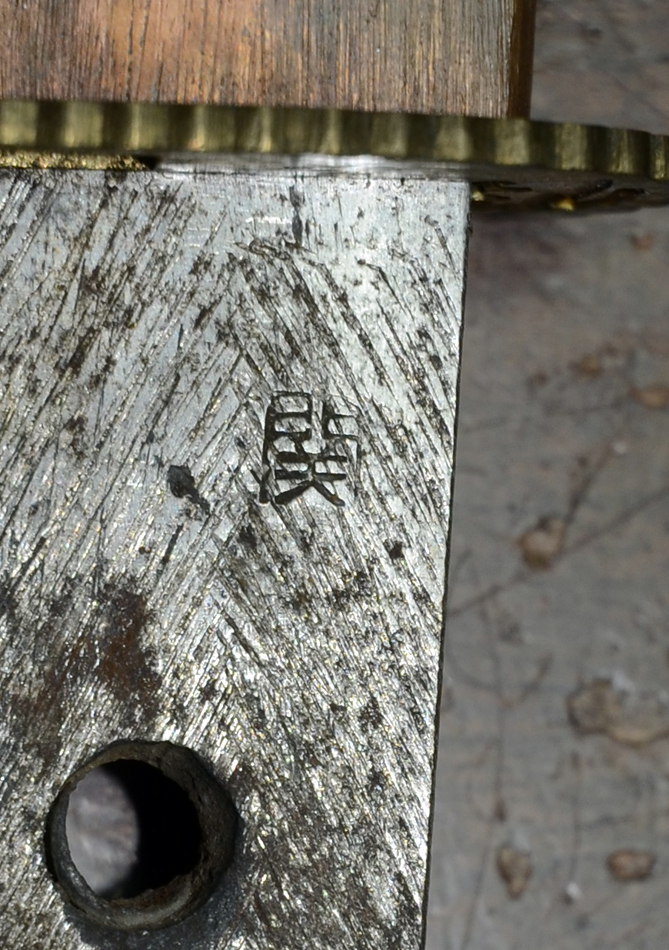

Hello All,
Apologies for the time it's taken to get/post this image of the arsenal stamp...and yes, after re-examining it, it looks to be stamped vs. hand-carved.
In any event, here is the image - I could not find the "arsenal Stamp database" to put it there, so if someone could do so, or direct me there?
