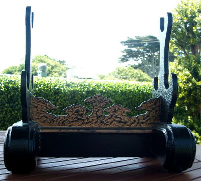

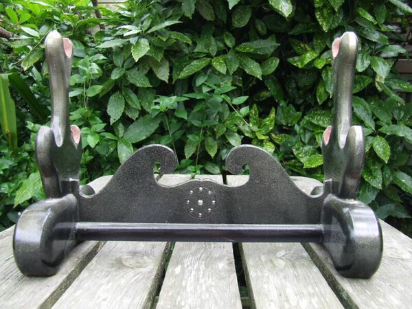

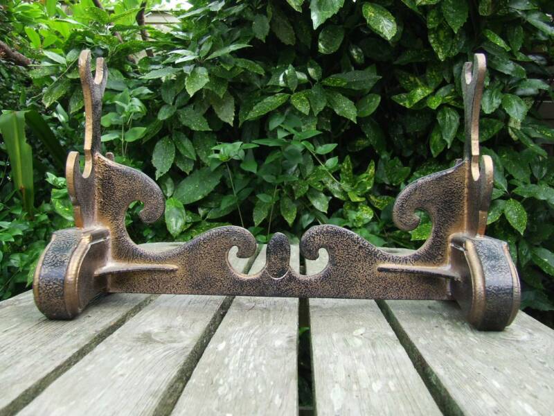

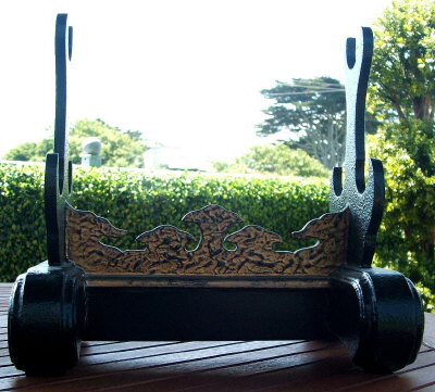

Lindus Posted March 16, 2013 Report Posted March 16, 2013 All stands if you cannot afford an original are pretty simple to make,providing you have a basic wood working ability. Three below are stands made with only basic kit,some I made were far more fancy but cannot find the pic's.....have a go, not rocket science. Quote

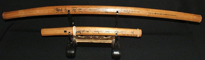

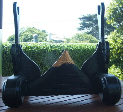

Lindus Posted March 16, 2013 Report Posted March 16, 2013 Found two other,made for small Tanto,but also look ok with a Daisho..... Quote
Dr Fox Posted March 16, 2013 Report Posted March 16, 2013 Roy come clean now! You make these for a living don't you? If you don't, then you should, stunning! the flow of the supports, and the solid suggestion in the bases, is to my eyes art in itself. Oh! and by the way, for me to produce what you have done, is indeed rocket science. Denis. Quote
Lindus Posted March 16, 2013 Report Posted March 16, 2013 Hi Doc Odd thing about us Humans,we think we can't so we dont try. Also a generation thing I suspect,back then if you could not afford something you had a go at making it. I remember wanting a radio controlled boat,could afford the basic control system so bought some model makers marine ply and a bundle of Meccano ......great fun when the banks of oars on the strange Bireme took to the water. There are things that I find for me impossible,binding Tsuka well,being sensible at Auctions and understanding my child bride after 46 years together Quote

Lindus Posted March 16, 2013 Report Posted March 16, 2013 Hi Adrian Would do if I had any,took the basic design from an original stand,made a bundle of the base sections from off cut floor joists. The rest was made from any decent wood I found so each on was a one off. Only templates were cups,paint tins and the like for curves,cheap plastic drawing set so nothing perminant. One suggestion,after the first I was not happy re the joint section so went to my local Vet and got some used syringes, fill with fine flexy polyfilla put a thin amount along every join. This really finish's the job well. Textureing is again with a watered down filler and stippled with a damp sponge, this works well but needs to be well dry before applying paint. Allways under coat with a matt red primer,if you want an aged look with black lacquer cut back with say T'Cut untill the primer begins to show, with a little trial this can look good. Simple Mon such as the Hoskawa,can be made with 'fablon' but should say here that none of this was made to fool anyone,just for my own pleasure.{Add that before am deluged with accusations} most of the stands made were either given away or sold for charity. Have a go chaps,can be fun and you do not need a vast range of tools,mine are a jig saw,circular saw and a few cheap chisels. Roy Quote
